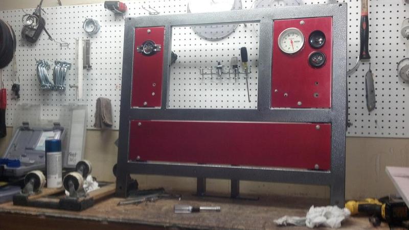

I always liked the hammertone look, never saw a TM with that finish until now. Nice!

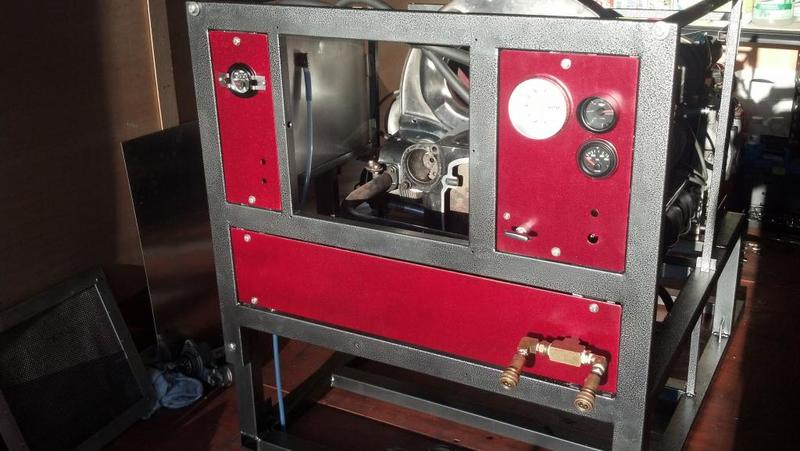

Here is a picture with some sunlight on it. I got er fired for a moment today... not one muffler or silencers on er that didn't last long :shifty:
It is taking a little longer than expected just because I am finishing things up this time.
Had to cut a special engine shroud to cover my exhaust header to separate the fresh cool intake air. Came out really good... till it was time to put my starter on....had to cut my wrench in half to get to the bottom bolt.... Now I know how it happens when you are working on something and you yell out WHO THE FOOK DESINGED THIS THING!!! and you have to buy some special tool to get to some dang bolt or nut!!!!

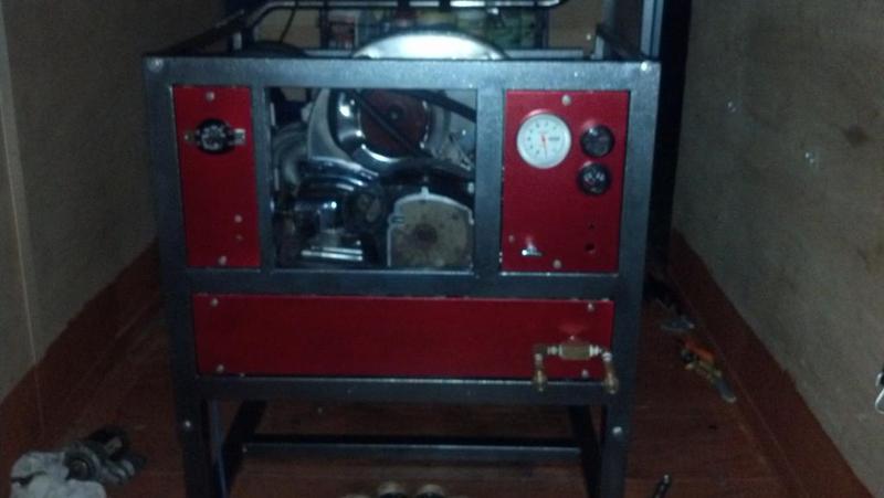

Got her going again, lighting was just out of the way to show off her true colors, used her today to do a little wand test with my WP Ti. Had to do a little throttle linkage adjustment but she was sucking it up today. Going to finish up with the EXHX. Already pre drilled for mounting, I think she is going to produce a ton of heat I am actually kinda scared at how much really. Have to wait and see.

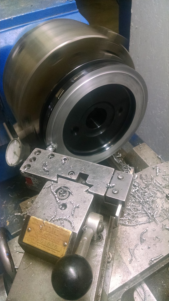

Well I broke my Vwtm trying to reach 20 Hg, I don't know if I really hit it or not but the good thing is... The tank, Dev, 4 drive belts, survived. What didn't make it was my custom aluminum pulley I had made. It broke the center right out of it... it was a little on the thin side @ 1/2 thick so.
I had to come up with a new way to mount the Pulley and this time a real pulley with a bushing just like what we all have on our Tm's now.
I did get it done but the pulley I had was 3.95" kinda small and only one belt per blower so I had to see if it was going to work and yes it did fine.
So I found a place on line that sells pulleys up to 10 grooves!! if you needed that many. I picked a pulley that was 4 groove( belts) and a diameter of 5.95.....

Why did you mill down the pulley?
I had to because it was a weighted pulley and the added thickness was interfering with my belt clearance, I was just really after the center portion of the pulley so we could mount the drive pulley for the blowers
About 3/8 thick steel vs a normal vw pulley of 1/16 aluminum to much flex
