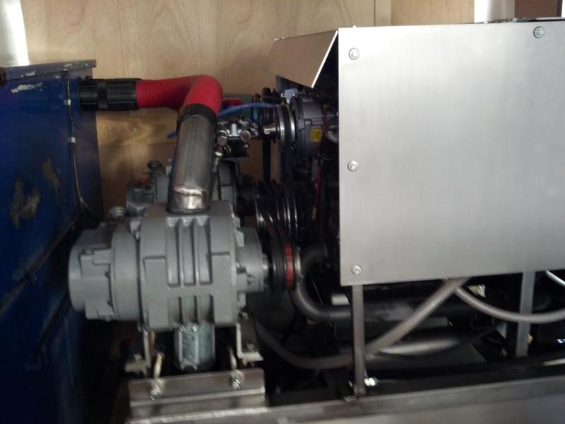

Ok got my throttle worked out today. I am really starting to realize why most TM's are in the 330 cfm of less.
This was my set up 2 12 foot 2.5 hoses to back of Devastator no filter just using it for Y. Then out of the front or Job side 25 feet of 2.5 hose at that point took cfm test to see 485 cfm truck mount was at 8 HG's
The minute I hooked ANY amount of 2.0 hose the HG's would climb to 13 HG's and due to the fact that I am running a vacuum governor and have it set to max my TM at 3000 rpms so as the HG's increase so does the throttle just like it is designed to do but it will not drop back down due to the amount of HG's created by the restriction of the 2.0 hose.
I finally got some decrease when I when down to a 12.5 whip of 2.0
I don't think it would be any different on a PC Ev or any TM with 5.9 blower due to the fact there governor works off of load the 2.0 would still create HG's and thus a load and increase the throttle so is the vac relief on them just opening to bypass the restriction of the 2.0 hose or what.
What I can tell you is I have never seen a vac gauge move so fast in my life I mean it is instant from 5 to 13 in less than a blink and it is pegged
What is some of your guys experience on this with bigger TM's is it just that with bigger blowers you just have NO LAG time when you set your wand down its at max vac as soon as the wand stroke starts ?
I can tell you for sure I will have no problem with heat as the exhaust is very very hot compared to my legend with it 20 hp any input would be great.
I just don't see how guys are getting 500+ cfm out of a 2.0 hose from what I saw today it is to restrictive
