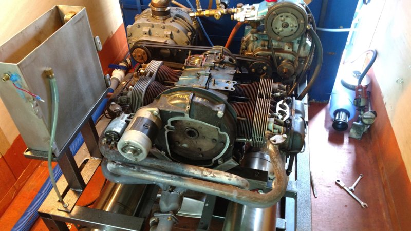

I just picked up my new motor today!!! Going to be trying to finish up the VWTM over the winter months....Should have 65 hp with the kit we put it together with.
I have been practicing on my tig welding so I will be able to do my dual blower HX system. End goal 190-195 constant heat ATW. If I can keep it at that I am going to be super happy, no need for all the safety bs that goes along with 200+ water temps from engine exhaust. I can do it but I don't want to.
Guy gave me a couple pointers and glad he did. showed him my current setup and he said this motor should last a very long time.
New everything but case it was line bored for crankshaft, cam shaft better oil journals, assembled..... 640.00 bucks and I gave him a tip.
Do to the idle down when wand is lifted @ 10 seconds, the water will never get to hot at least that is what I'm going for.
Can't wait

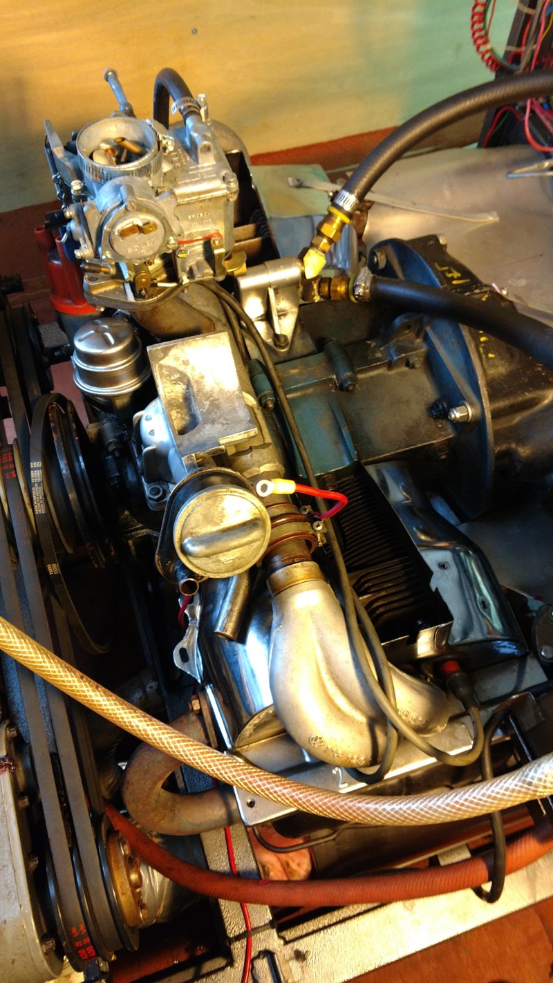

Well I got the old one out, new one in, forgot to take pics, I ran into a little hiccup I want to beef up the rear engine mount so I couldn't go get bolts today. The other way worked but I couldn't service oil pump with out removing the whole mount, so just a quick redesign. The cool thing is my whole front panel comes off with two bolts and two wires + n - to power all my gauges so I should be able to get it back together on a few evenings.

What I really want is two blower silencers like what Judson uses they are very compact short and round. It looks as though the blower ex inters into the center of them and exits out side??? I think Mike D used one on his steam punk TM. I could basically screw them right into the exit ports of my two blowers then gut my two Ss silencers and coil them for blower heat.

I also think I am going to get rid of all the header system, it is more for a performance car, if I can do this it will get rid of all the hot exhaust tubing that you see in one of the pics, it really creates a lot of heat and that is where the fresh air is coming into the fan, should cool it WAY down. Now that I have my Tig welder it should be a little easier to do

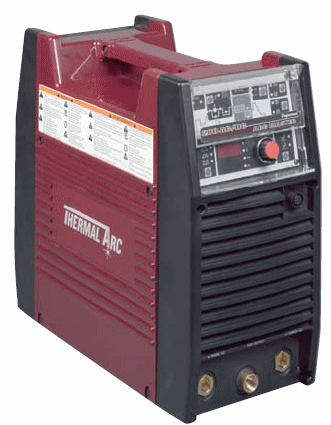

What kind of tig welder did you get? I recently got the itch to do it again so I picked up a thermal arc 161
