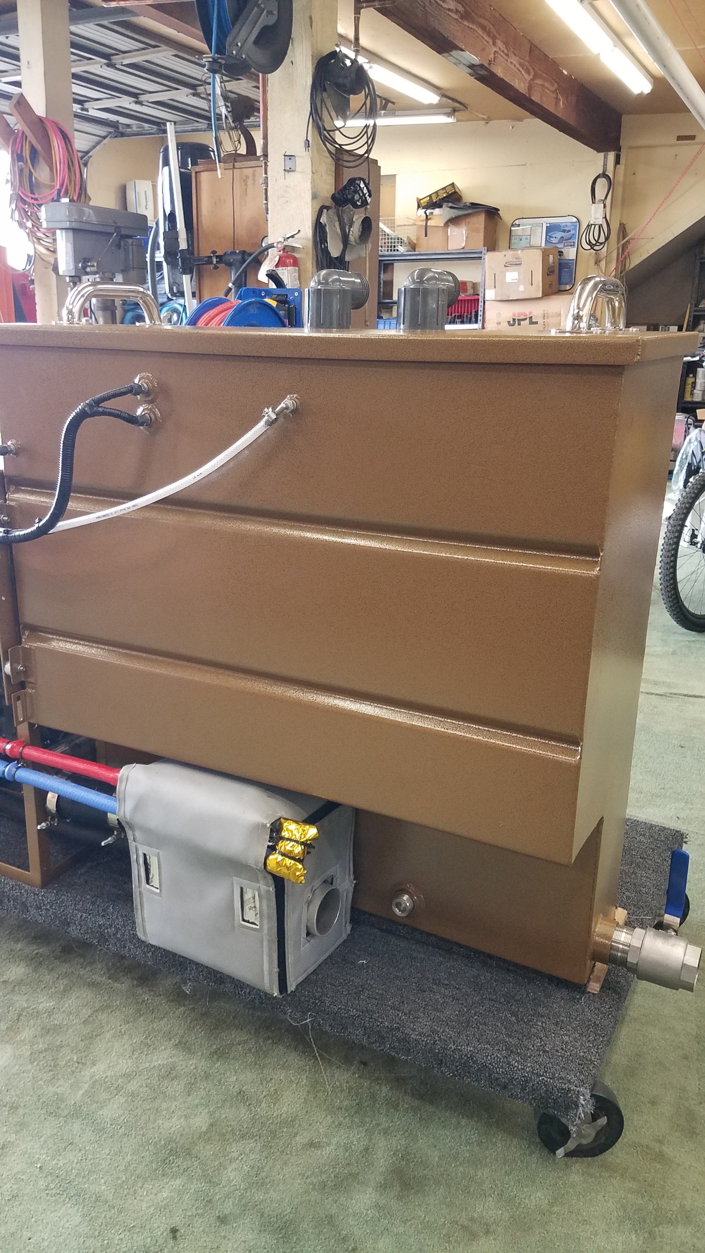

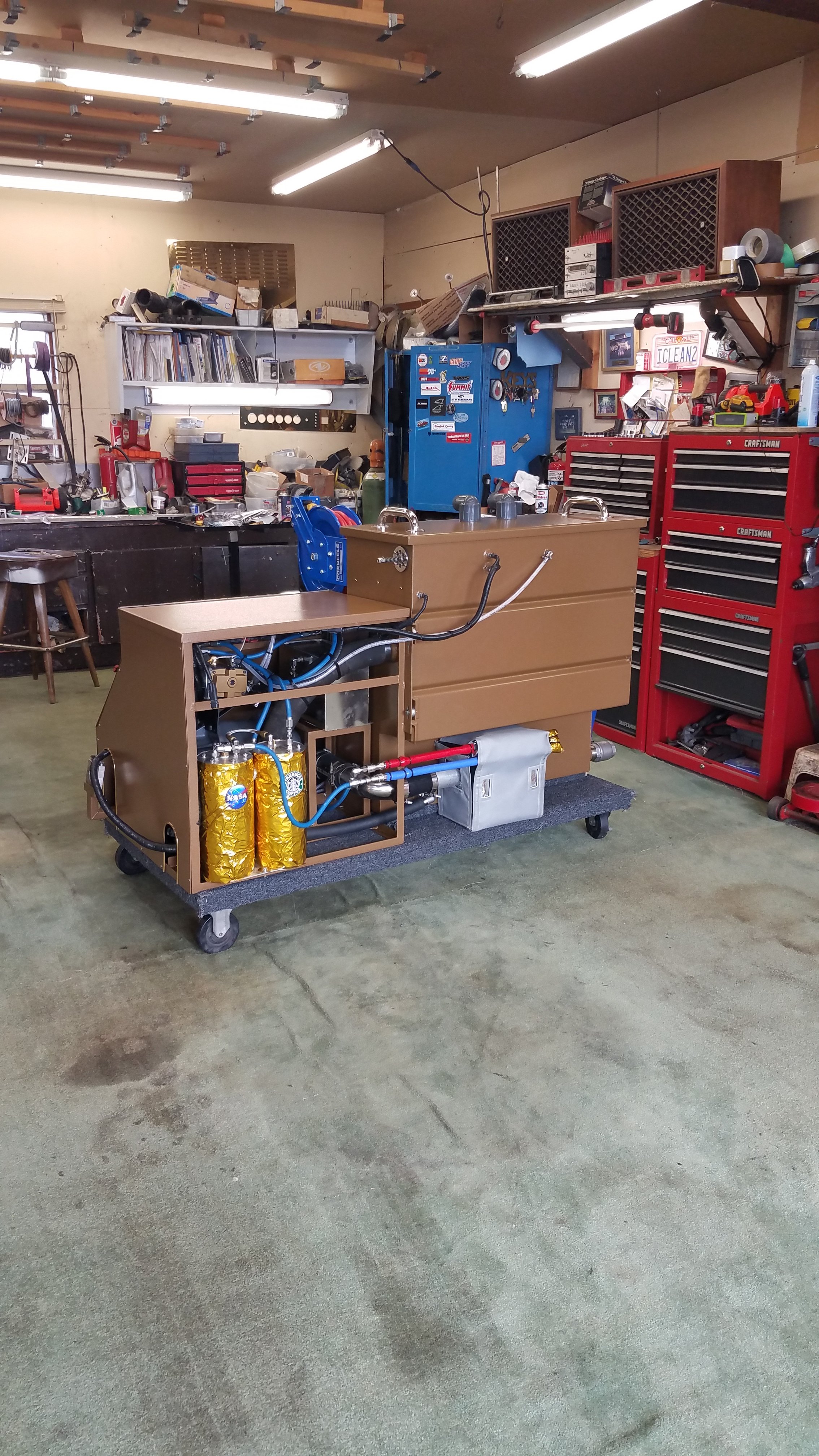

I get 200° from frankinstien it has a salsa unit the blower discharge temp on a 47 blower according to roots is 225° @ 14"hg so at 100% recovery (not possible) highest solution temp would be 225° my point was less problems with lower temps ,using exhaust to heat solution to super high temps creates more problems than it's worth

Having a custom designed and built machine allowed me the freedom to pick and choose to best and most reliable components from all the manufacturers

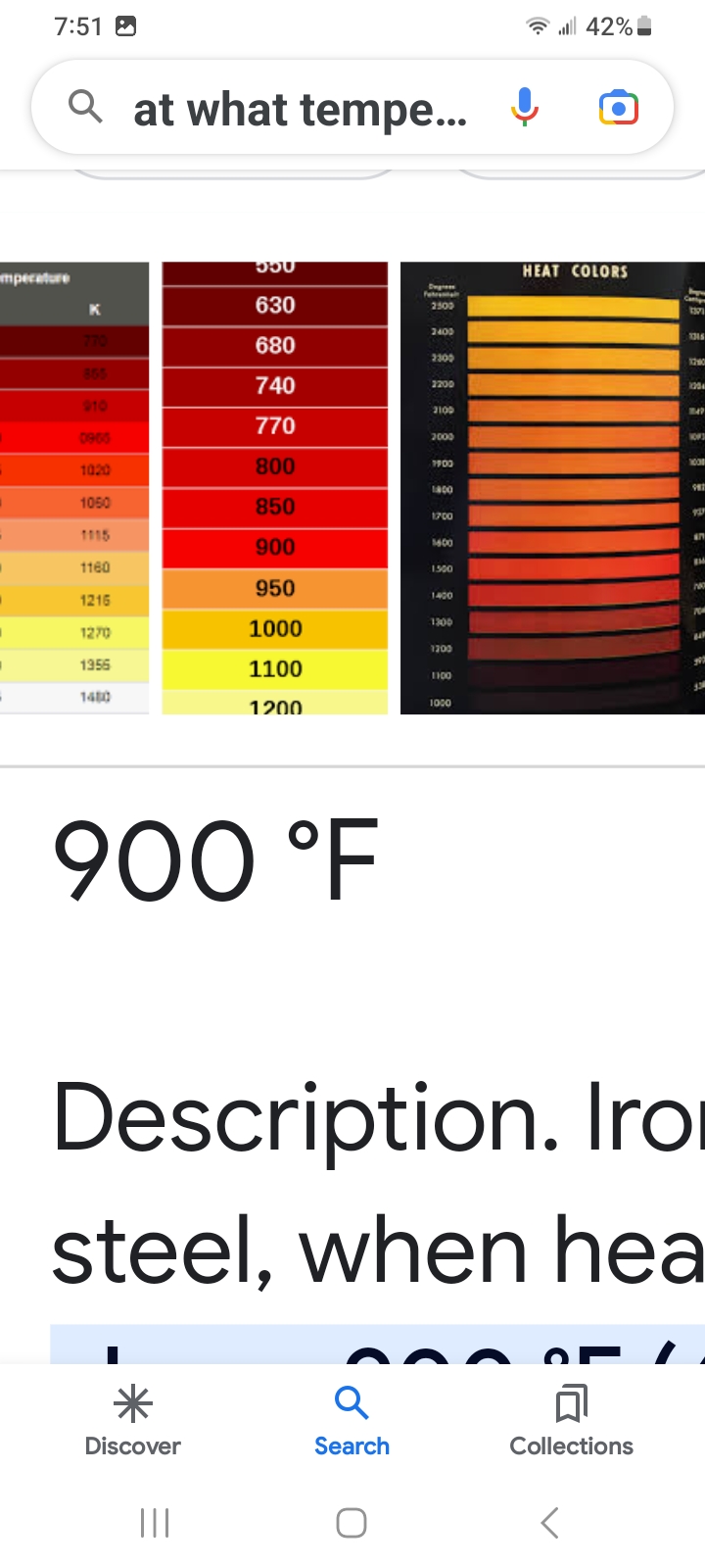

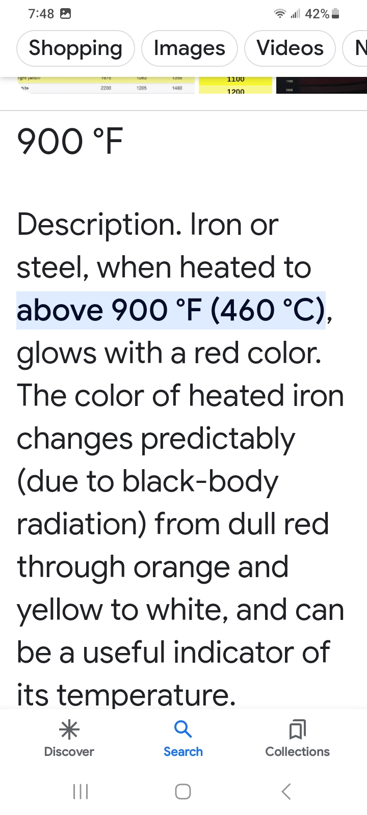

It barely glowed very close to where it bolted to the engine. Even then it didn't glow the whole job
Aren't they supposed to glow?ive driven my vans more than once with the dog house off and noticed that the exhaust manifolds glowed, and while on a dino my Shelby headers glowed too. On the vans the manifolds would quickly heat up and glow under acceleration and quickly cool off when i let off the gas same on the mustang glow bright when doing a pull and cool right down as soon as you let up on the gas

I always read that glowing headers either was caused by lean fuel burn or bad catalytic converter. I had both problems and the glowing reduced almost 100%
I know some of these turbo engines in race cars are different, but a normal engine shouldn’t have a bright glow. My previous Titan and current Everest and now thermalwave don’t glow bright.

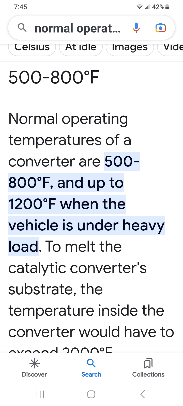

I only saw the mustangs headers when it was under load on a dino and the vans exhaust manifolds glowed when i accelerated hard, so under load also .
I don't know anything about these carpet cleaner engines i just assumed that under load they would glow also. I just googled normal operating temperatures for catalytic converter
Dwain Ray
Jul 22, 2020
1,175
Ive been following this forum for awhile and assumed that glowing manifolds were normal, but im a pto guy and know next to zero about specific engines like yours my knowledge is more general
