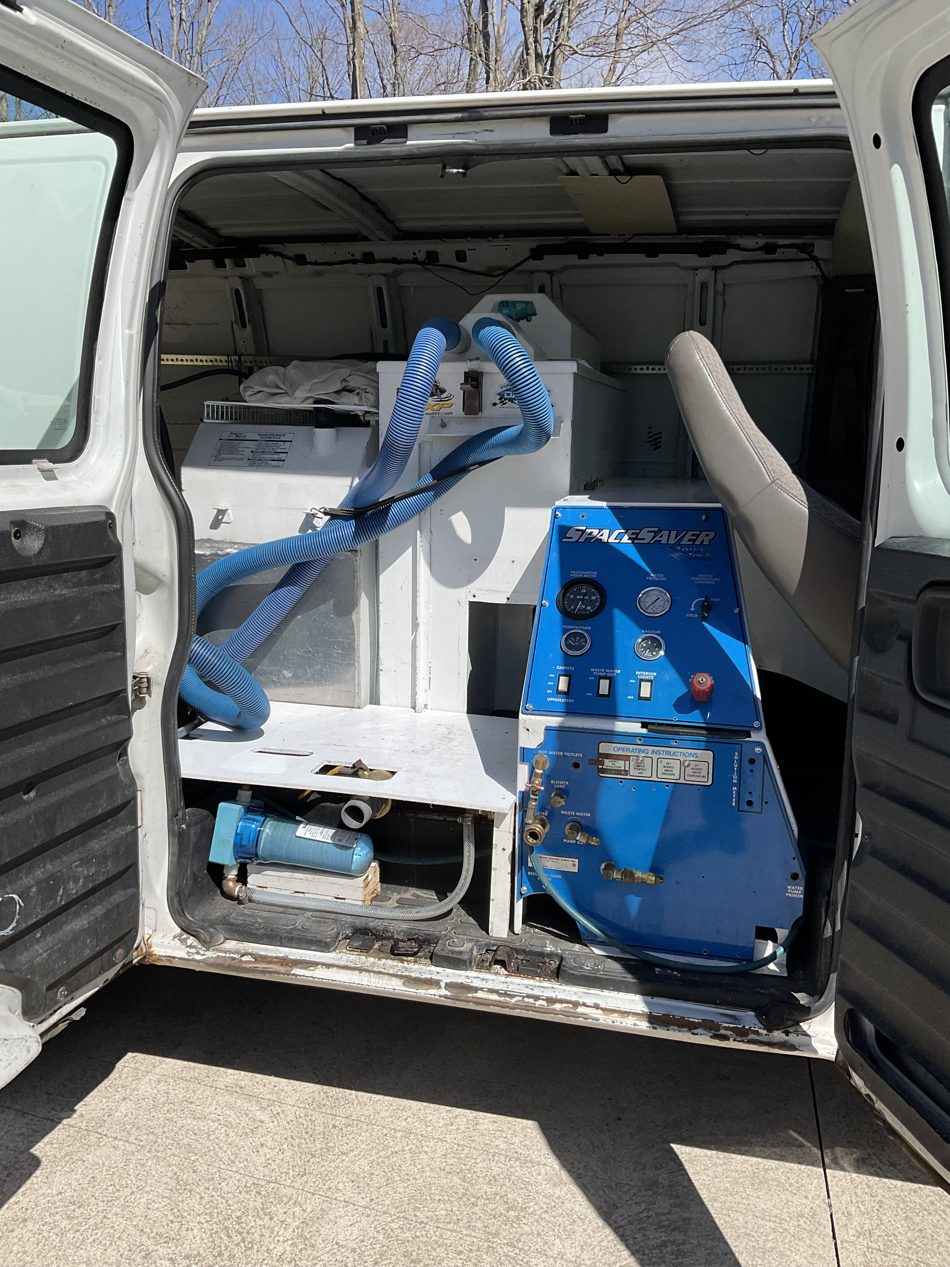

I’m taking it to the forklift later this week to move it. Rubber mats underneath are getting pulled up.
The waste tank was behind it but I think I’m gonna move it to the left side of the machine for better mounting space and ease of access to the rear and right side of the machine.
The van needs a power steering fluid reservoir, a tuneup, and a new rear door
As for the tm, the water pump needs tlc, and the 185f thermal relief valve needs replaced. 🤞. Once I get it completed, we’ll see what other issues it might have

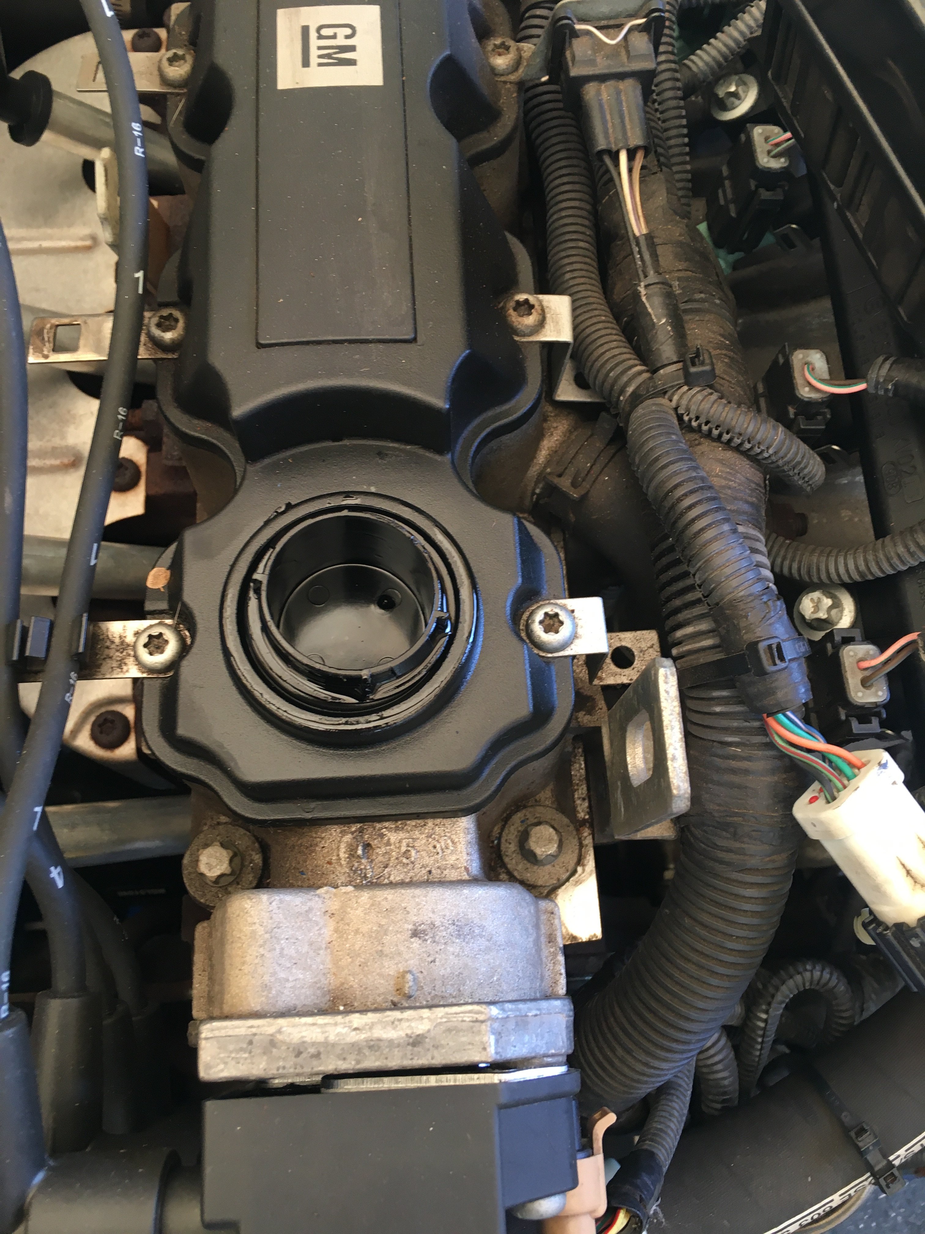

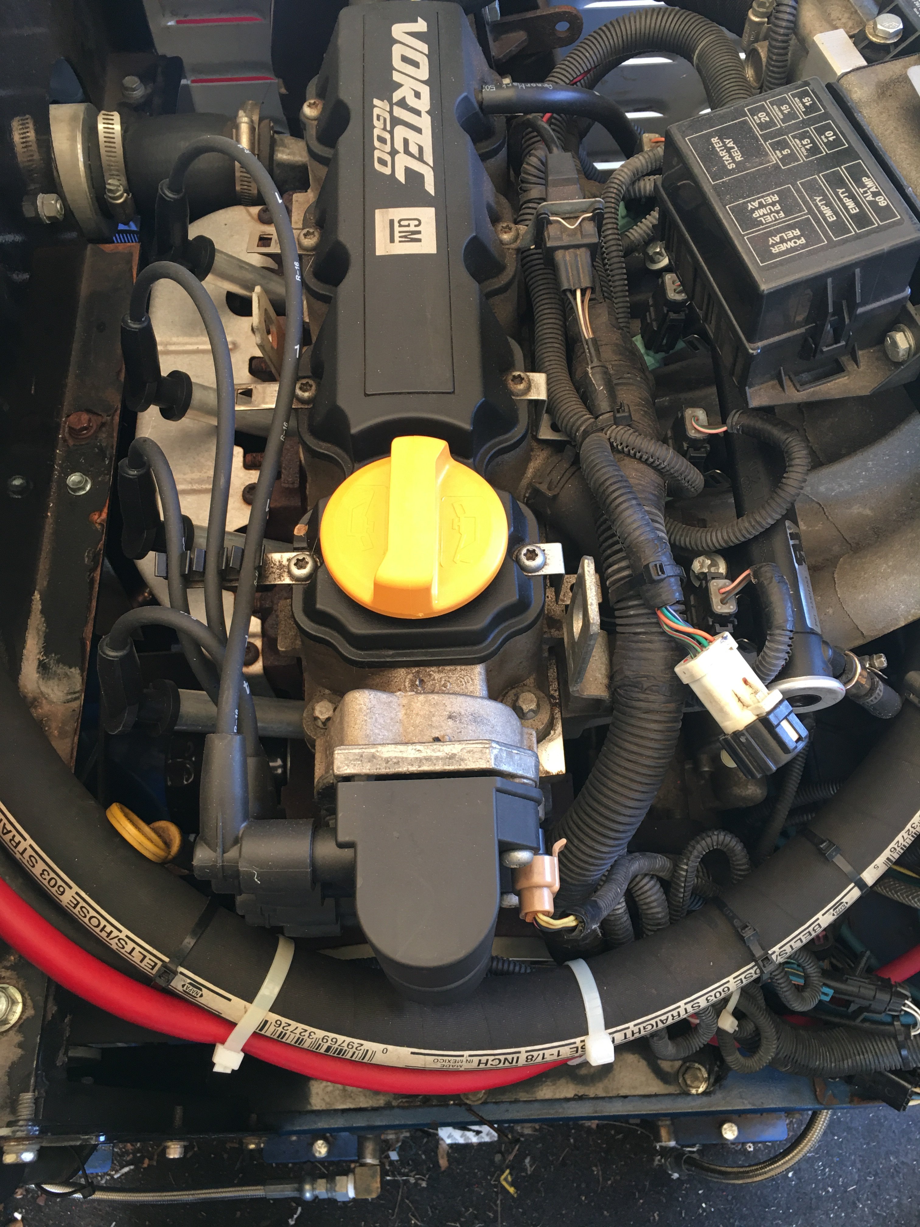

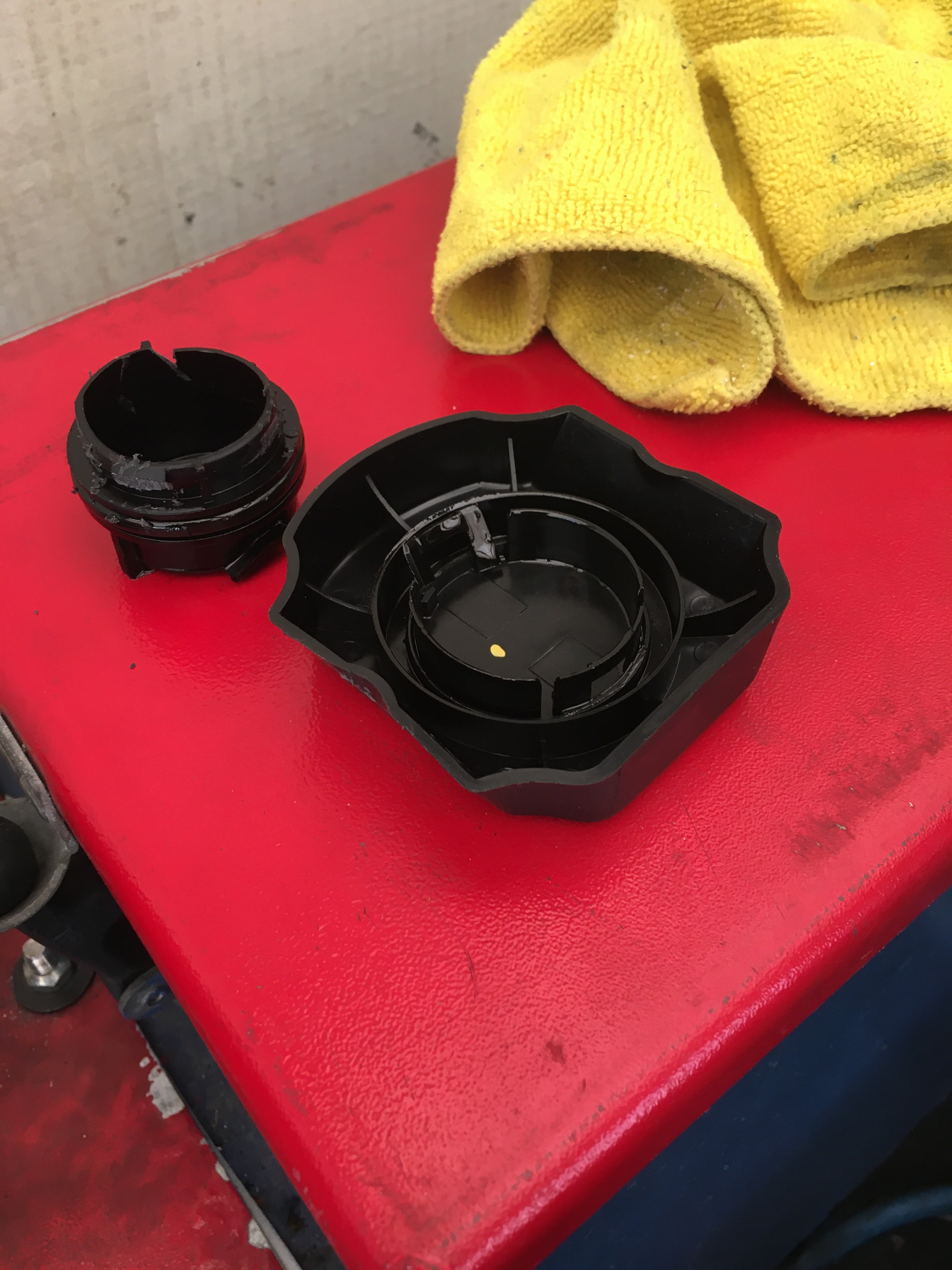

Whoever has the vortec motor needs to buy a spare oil cap. Mine started getting harder to pull off and it finally broke today while changing the oil I’m glad I bought another one a few months ago

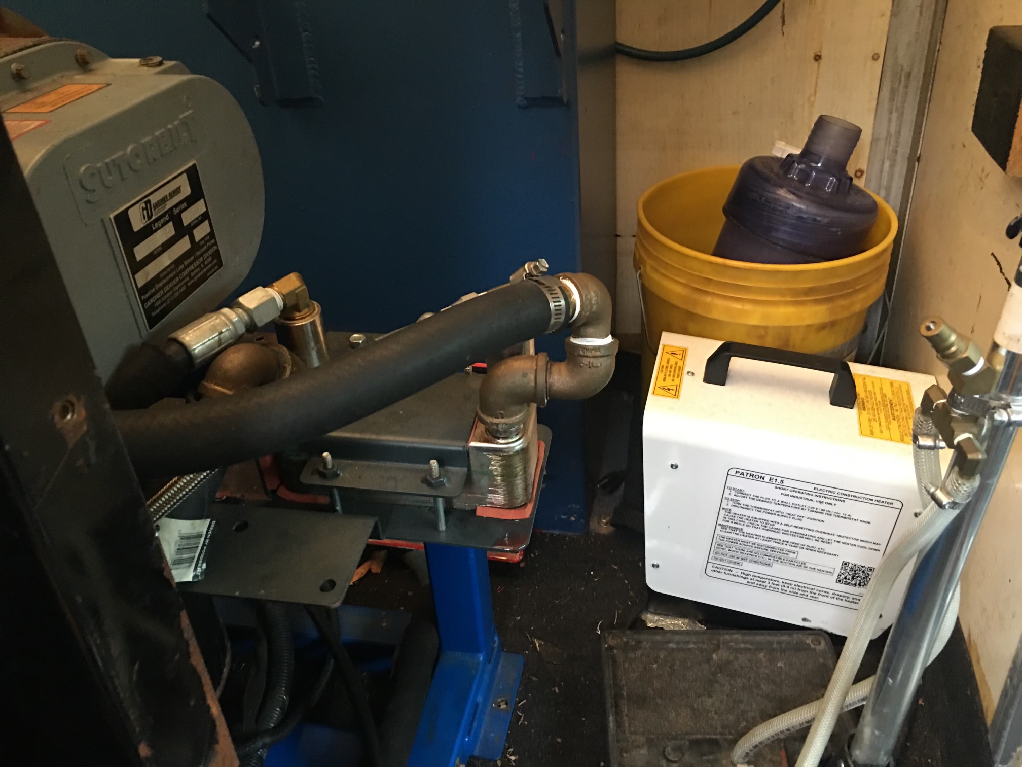

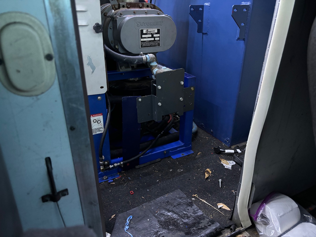

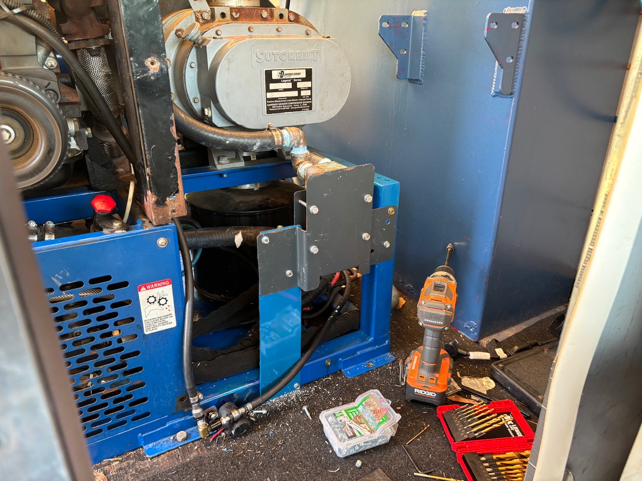

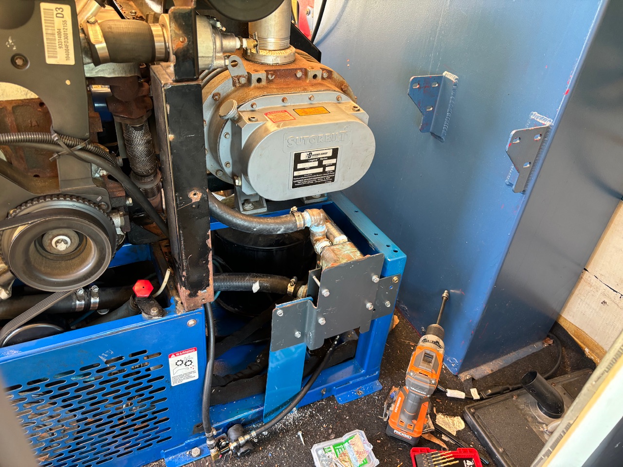

Doing a little adjusting
The coolant heat exchanger was just a last minute slap on. I never had time to properly mount it. So here’s the before and after. I bought the wrong color paint for it to 😒
14,207
That plate of metal looks like crap.
I’ll clean that up and make it more flush with the mounting plate

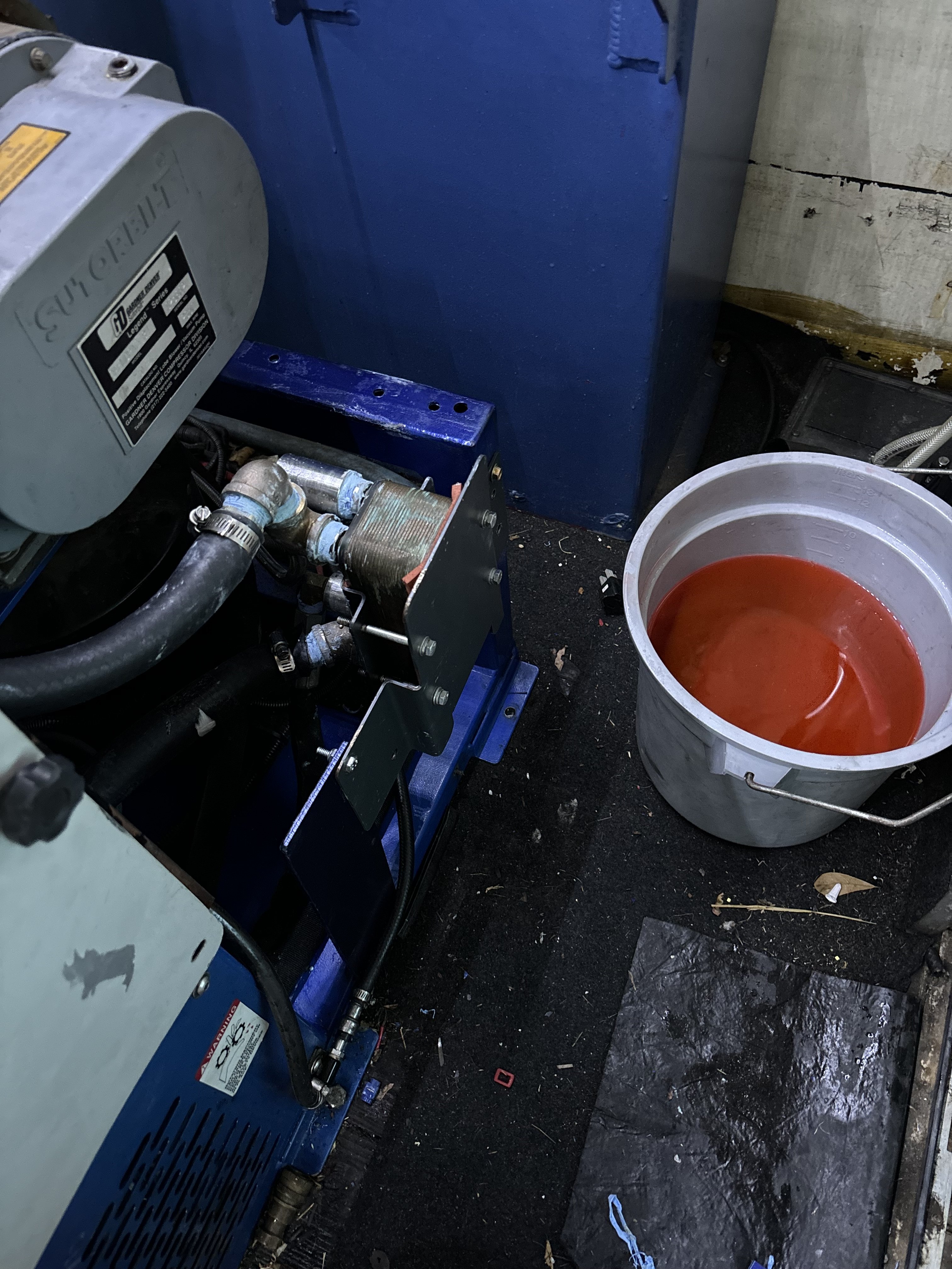

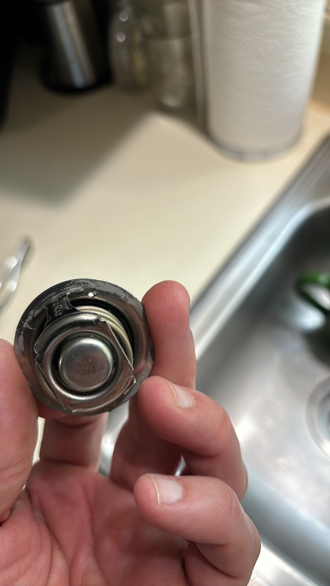

I've got an air pocket in the antifreeze that I'm not being successful at getting out yet. This new heat exchanger doesn't have a petcock on it to bleed the air out.
When I filled it up with antifreeze yesterday, I wasn't able to put back all that drained out. When I cranked it up, the water pump wasn't pulling it through the system to lower it so I could fill it full. It overheated and shut down.
I was told to drill a 1/16" hole in the thermostat to act as a bleeder/orifice for the antifreeze. So I went and bought another thermostat just to be sure it's good and put the hole where it needed to be. I'll let you know later today if that fixed the problem
Edit: Yes, a 1/16" orifice hole IS needed to be drilled in the thermostat above the heat exchanger to substitute the previous petcock that was on the original coolant box/helicoil.

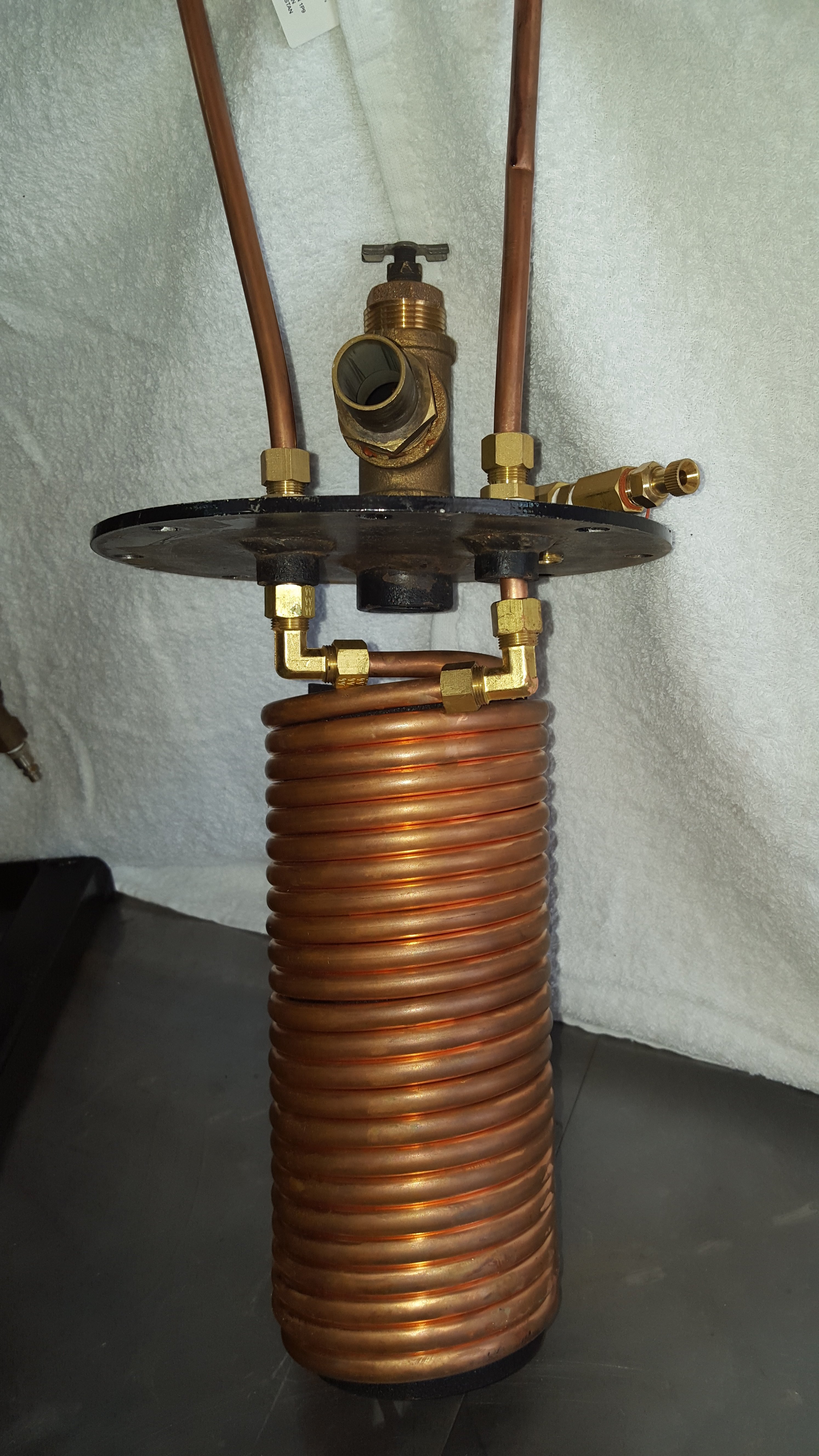

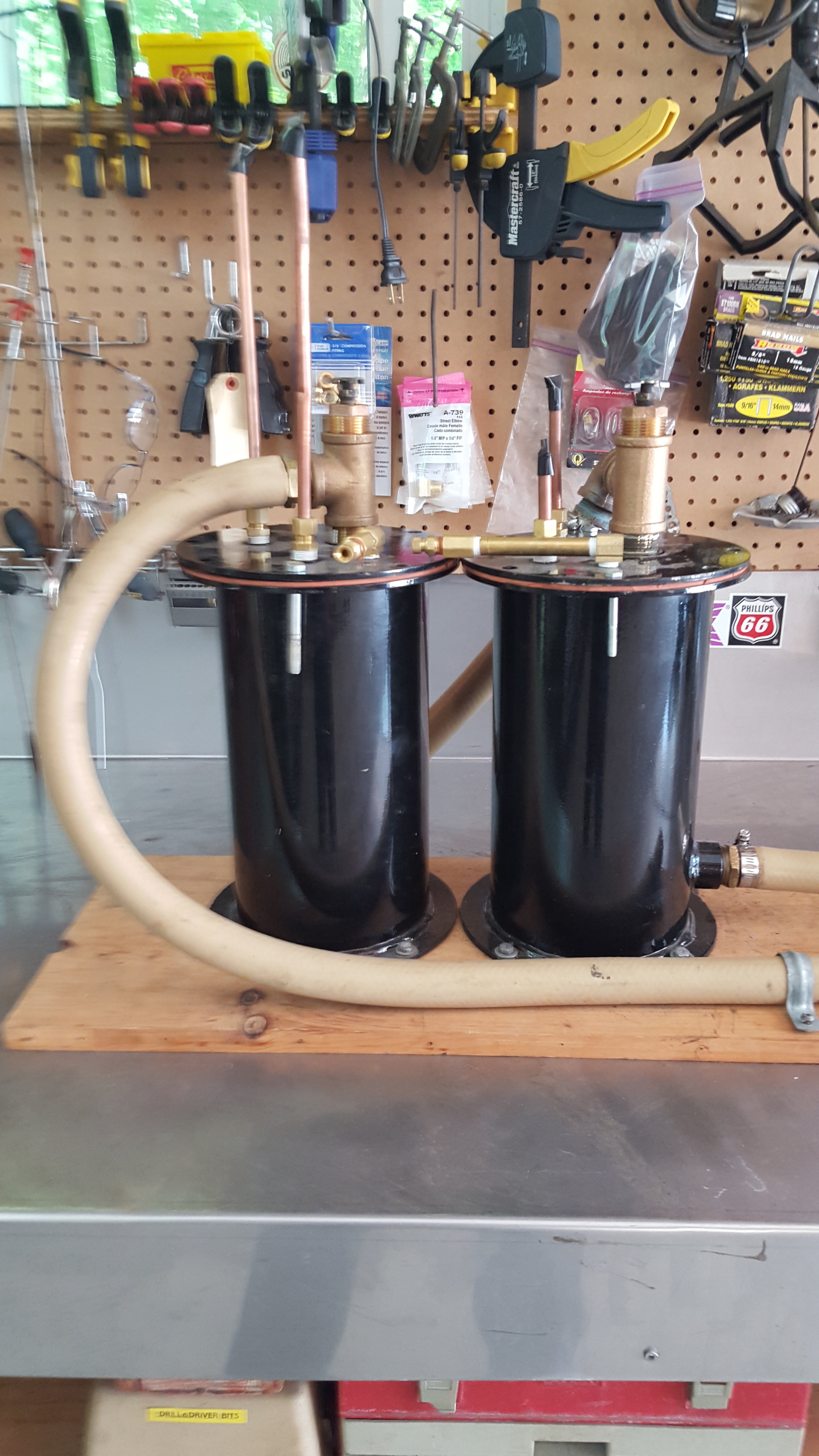

I would think most of the clutch drive units may have been designed off this brand.
These are from my AquaTech manufactured in Kelowna BC. Cleanco bought out the company years ago.
I rebuilt these years ago, and have never installed them yet. I had the coils wrapped by a company in Toronto.
14,207
Looks like a solid design. Just keep the pressure under 1200psi since the coils are copper. But two coolant heat exchangers should give you constant, reliable heat

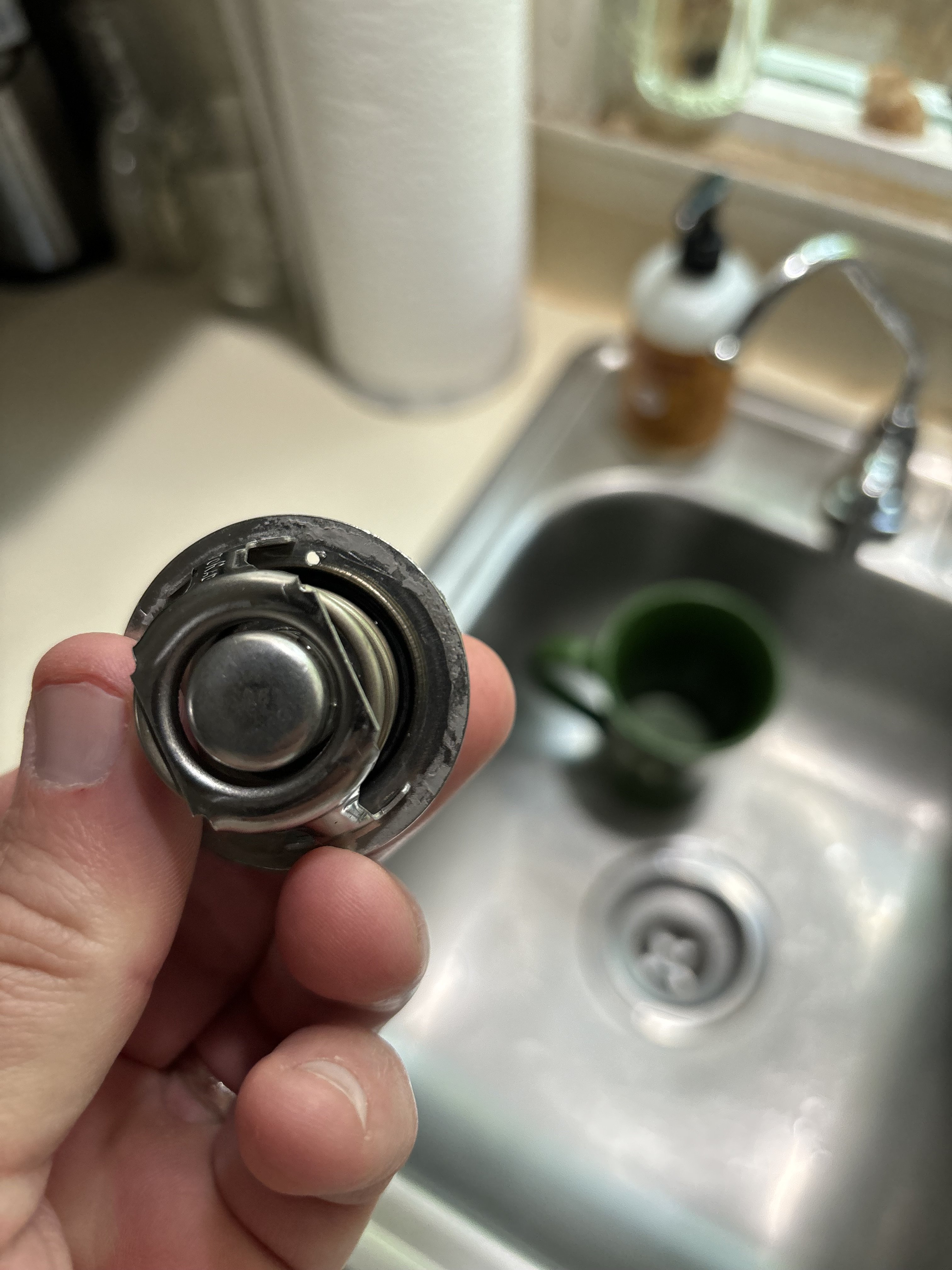

I tested the old thermostat and it worked correctly. That tells me the 1/16” hole in the thermostat was needed for the air to bleed through to prevent air lock in the coolant system
Wouldn’t that be good for any setup to have that ?

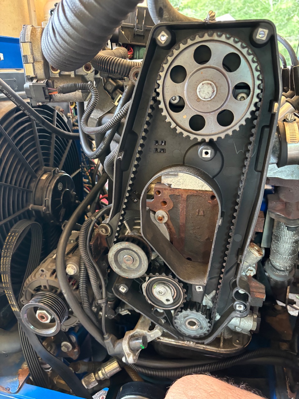

I'll be replacing the water pump and timing belt in a few days hopefully. It's leaking antifreeze at the water pump.
Sad thing is, this KP15310XC timing belt water pump kit only comes from suppliers overseas. I'd like to get these parts from Oreilly's or Napa, etc...
Can someone tell me which car engine matches this 1.6L were I can pick up the water pump and belt tensioner for the timing belt?
14,207

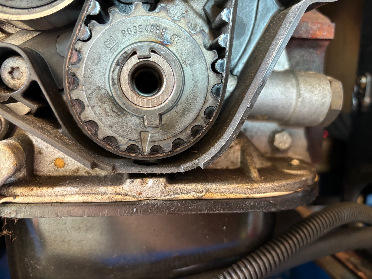

Any tips on how to remove that belt tensioner? I know the mark on the camshaft sprocket needs to be 12 o'clock ad the mark on the crankshaft needs to be 6 o'clock before I take off anything else.
