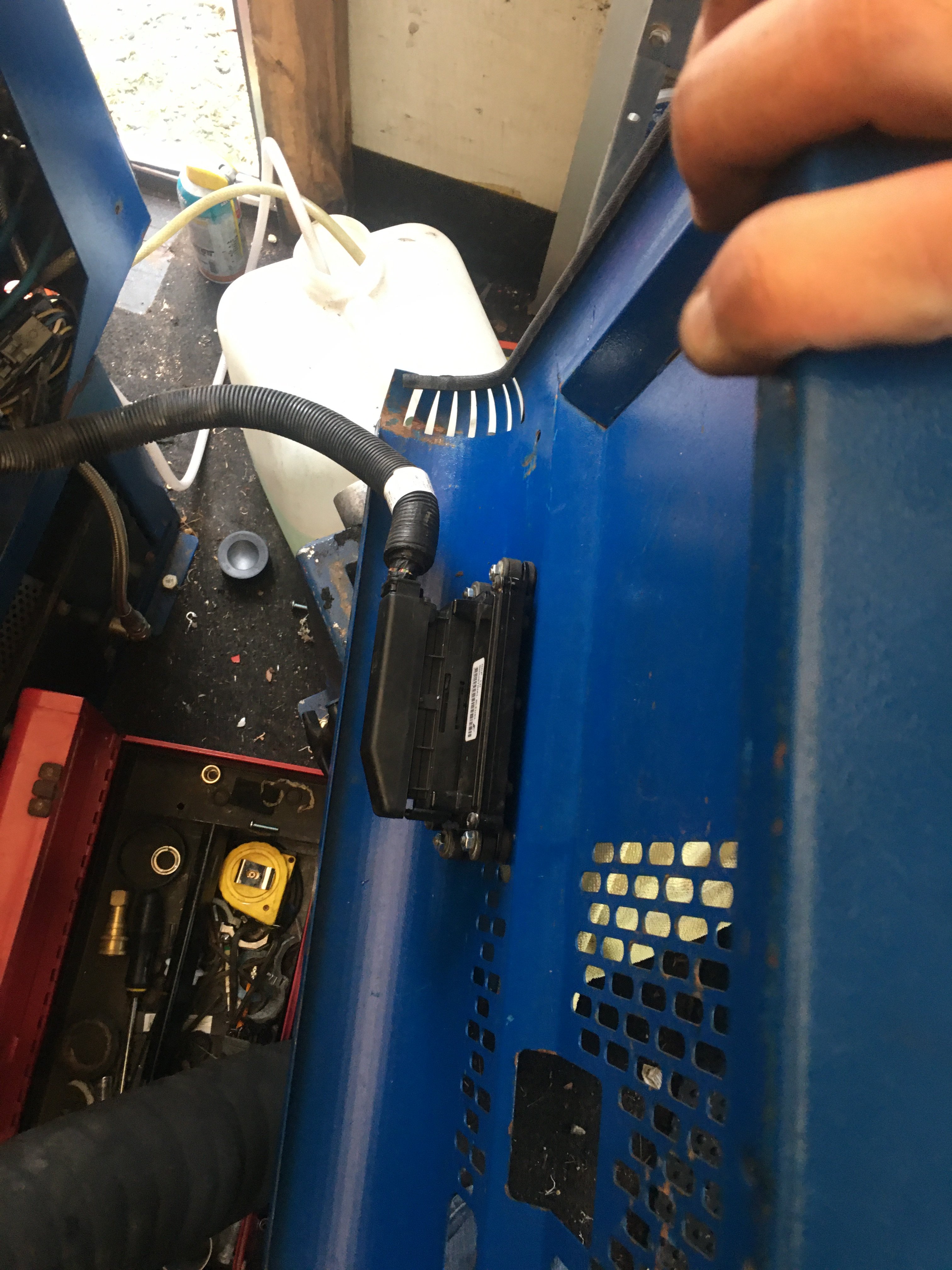

Does anyone have a way I can get the correct fuel pump at an auto parts store? I think this pump is bad. It's only putting out 40psi and the spark plugs are burning lean. I think it needs 55-60psi
14,643
I found a fuel pump to work, installed it and can't get more than 35psi. I need 55-60
I swapped out the sensor in front of the pump (maybe MAP sensor) that's on the manifold assembly, and even swapped out the manifold assembly too from my parts machine and still no better
where else is the problem?

Update:
I was under my thermal wave all day yesterday, replacing everything in the fuel system. (fuel pump, filter, and all fuel lines, and vacuum hose line on valve cover) The previous owner used transmission fuel lines, and a no name, incorrect pressure fuel pump, and caused it to almost catch on fire with it burning lean, causing my entire exhaust system to glow. After several fuel pressure tests (the fuel pressure gauge from Harbour Freight crapping on me) and finding the vacuum leak as well, I think it's finally ready. I"ll find out tomorrow how well it runs. $250 worth of money spent
I thought I had the overheated exhaust pipes dilemma fixed, but now I know it's fixed
I just pulled the van out of the shop prior to this problem. (rear engine seal, power steering guts, timing gear box, exhaust pipe doughnut). Another $2100 burned in the wallet
Correction: I went and did a job and the damn exhaust manifolds started glowing again. Did another pressure test and it only reads 35psi after fuel manifold. It puts out 65 at the pump. There’s a MAP sensor on the fuel manifold. Is there a way to test that?

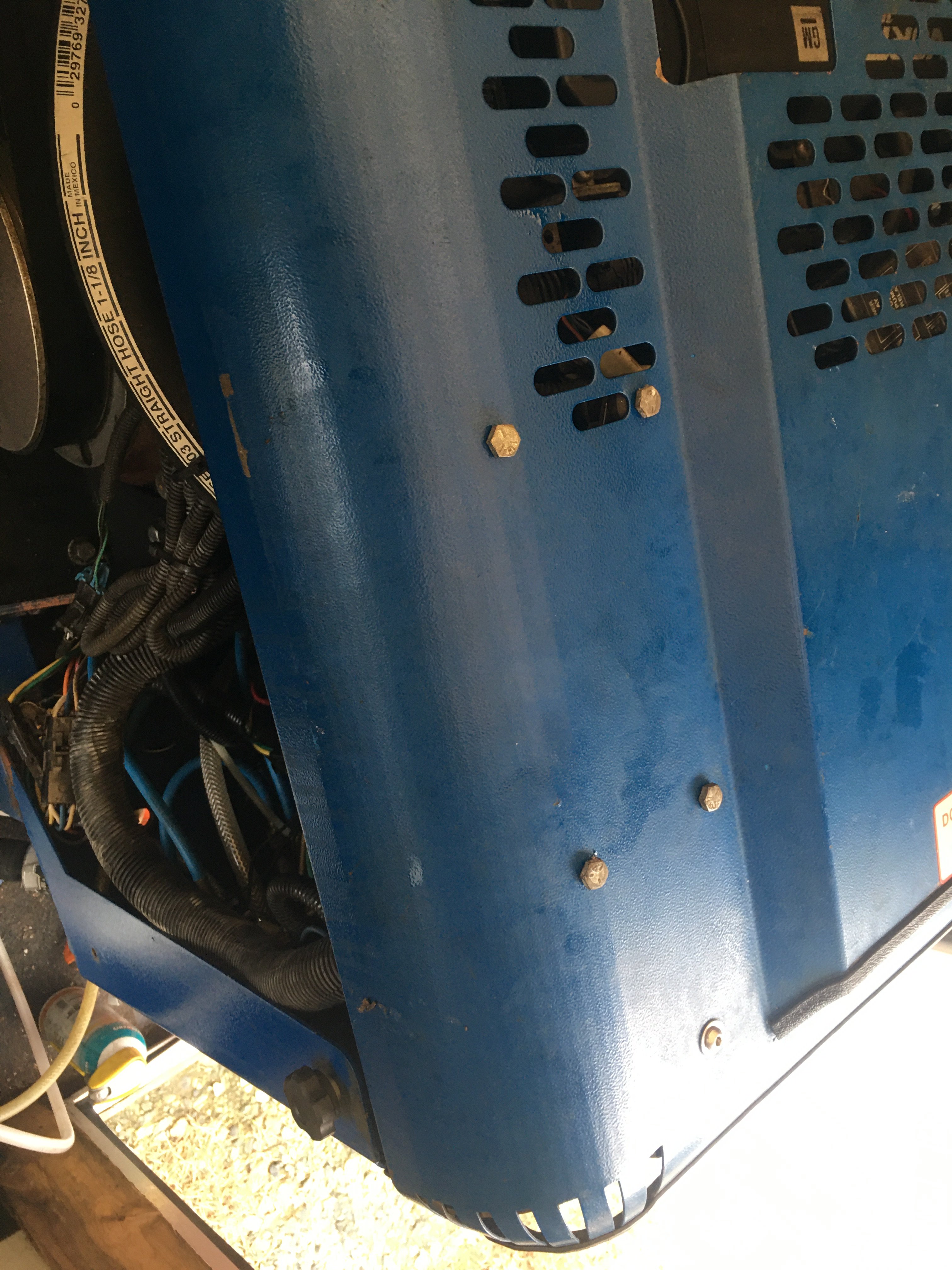

14,643
I’m taking it to the forklift later this week to move it. Rubber mats underneath are getting pulled up.
The waste tank was behind it but I think I’m gonna move it to the left side of the machine for better mounting space and ease of access to the rear and right side of the machine.
The van needs a power steering fluid reservoir, a tuneup, and a new rear door
As for the tm, the water pump needs tlc, and the 185f thermal relief valve needs replaced. 🤞. Once I get it completed, we’ll see what other issues it might have
View attachment 106620 View attachment 106621 View attachment 106622 View attachment 106623 View attachment 106624

14,643
Update:

14,643
Damnit
Another Correction:
That's not a MAP sensor, it's a fuel pressure regulator. It looks just like a MAP, but the manual in the Everest (which uses the same one) shows it's a FPR.
But Oreilly says it's a MAP... https://www.oreillyauto.com/detail/...-absolute-pressure-map-sensor/bos0/0261230112
And Justin sent me an article on this subject Jan. of 2022 when I first noticed this problem. I should've addressed it then, but I had so many other things to do to this setup a year ago. (Just read about it in the previous posts, lol)
When I was checking the fuel tap last nigh to be certain it was working correctly, I noticed it was very wet with fuel where the fuel vac hose is attached. And one of the symptoms of a bad FPR is it being very wet at that port due to fuel being sent back to the tank more than it should. I'll replace it this morning and report back.
Here's the article for anyone who might have this problem:
