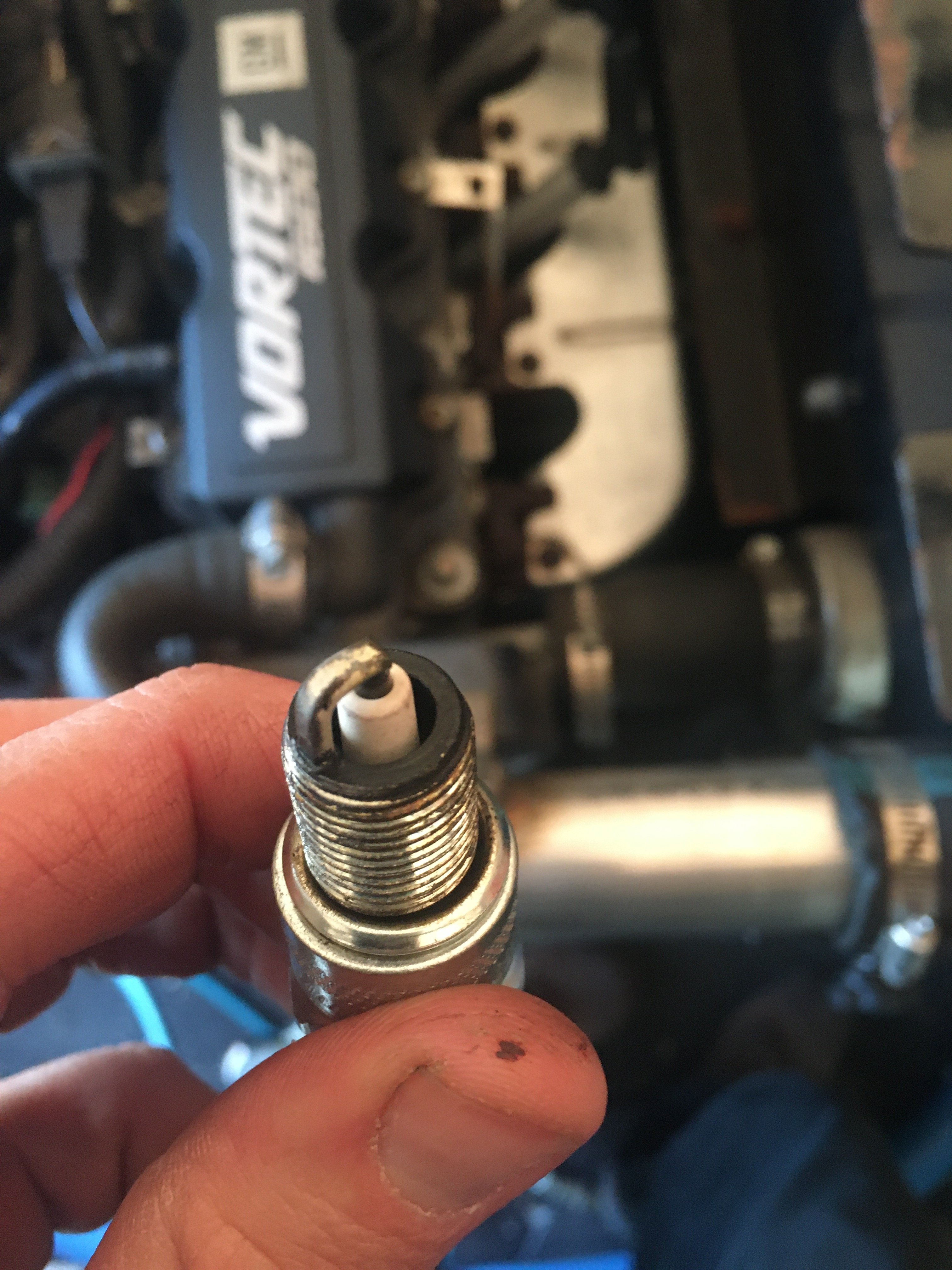

did you check the plugs?
Yep. The gap is supposed to be .031-.035. It read .035 and I just installed the new fuel pressure regulator manifold on the fuel rail underneath with no improvements.
What else could be causing the lean/hot fuel burning?
  • Wow
Reactions: Living The Dream
The Air/Fuel ratio sensor...
did all the plugs look like that one?
and how did PSI describe that piece you just installed?
14,102
Manifold w/f/temp is what’s on the receipt
I think 3 out of the 4 plugs were that way

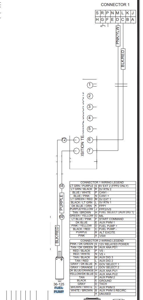

btw how is your pump wired?
14,102
ask PSI what the correct procedure for measuring fuel pressure is
my understanding is that on engines without a regulator the ecm modulates the fuel pump to control pressure.
The manifold just seems to be a bleed circuit (image I sent a few days ago)
The pump just has two wires +and-

Did you replace the fuel regulator? Did gas quit coming out the vac line if you replaced it?
My understanding is it doesn't have a regulator.
It has a manifold before the rail with a fuel pressure sensor/map on it. That sends a signal to the ecu which controls the fuel pressure by modulating the fuel pump ground/-. **
Edit: this is why I asked about the fuel pump wiring thinking maybe somebody rewired it where it doesn't get controlled by the ecm....but like I said I don't understand how that would cause the drop
Thermalwave fuel pump wiring
**I'm basing this on a description of another engine/application though
