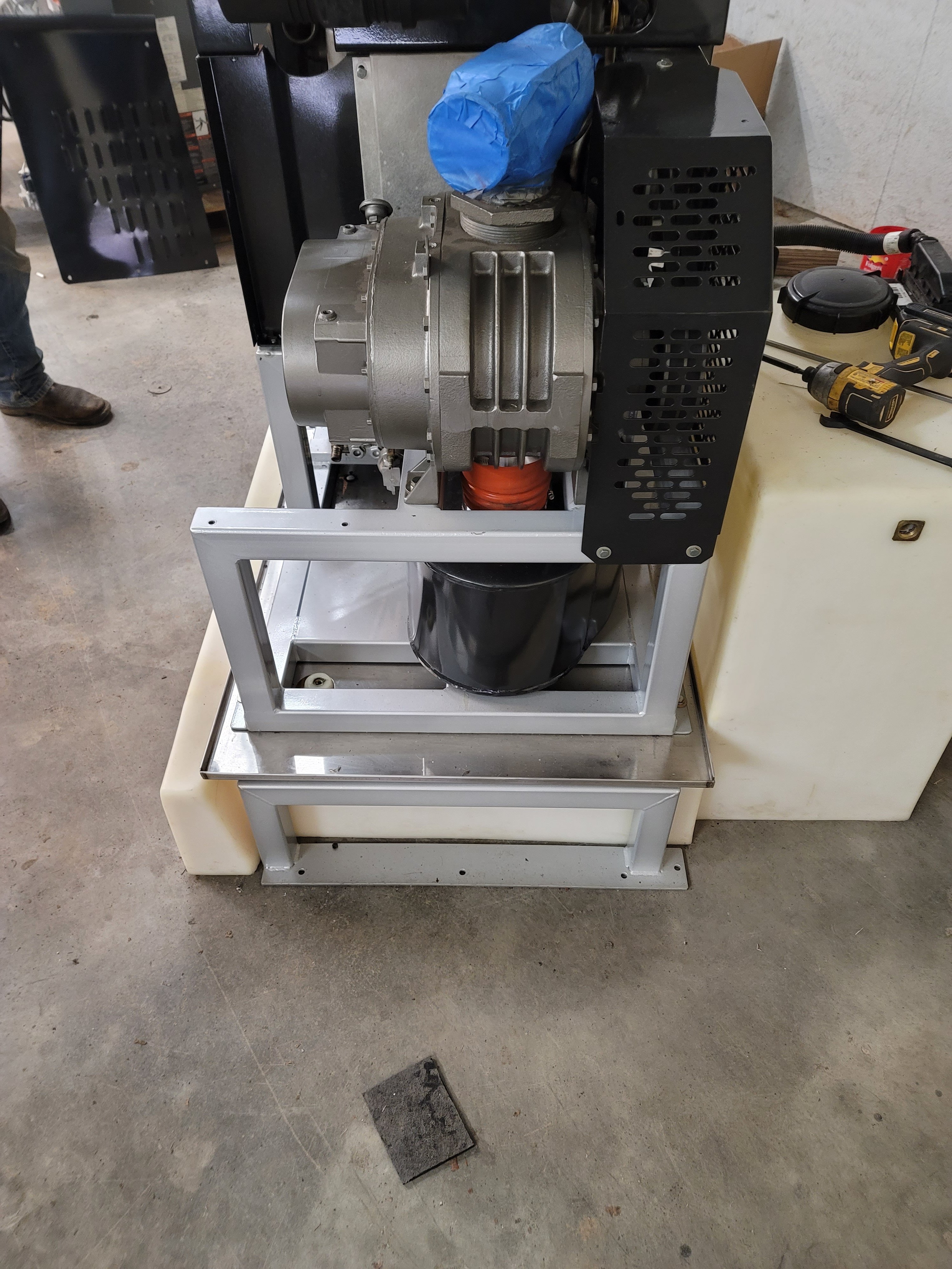

I’m taking it to the forklift later this week to move it. Rubber mats underneath are getting pulled up.
The waste tank was behind it but I think I’m gonna move it to the left side of the machine for better mounting space and ease of access to the rear and right side of the machine.

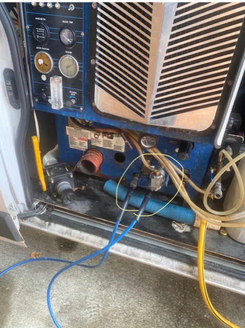

Here’s a better video of what it’s doing. My mechanic couldn’t tell if it was the engine or the blower

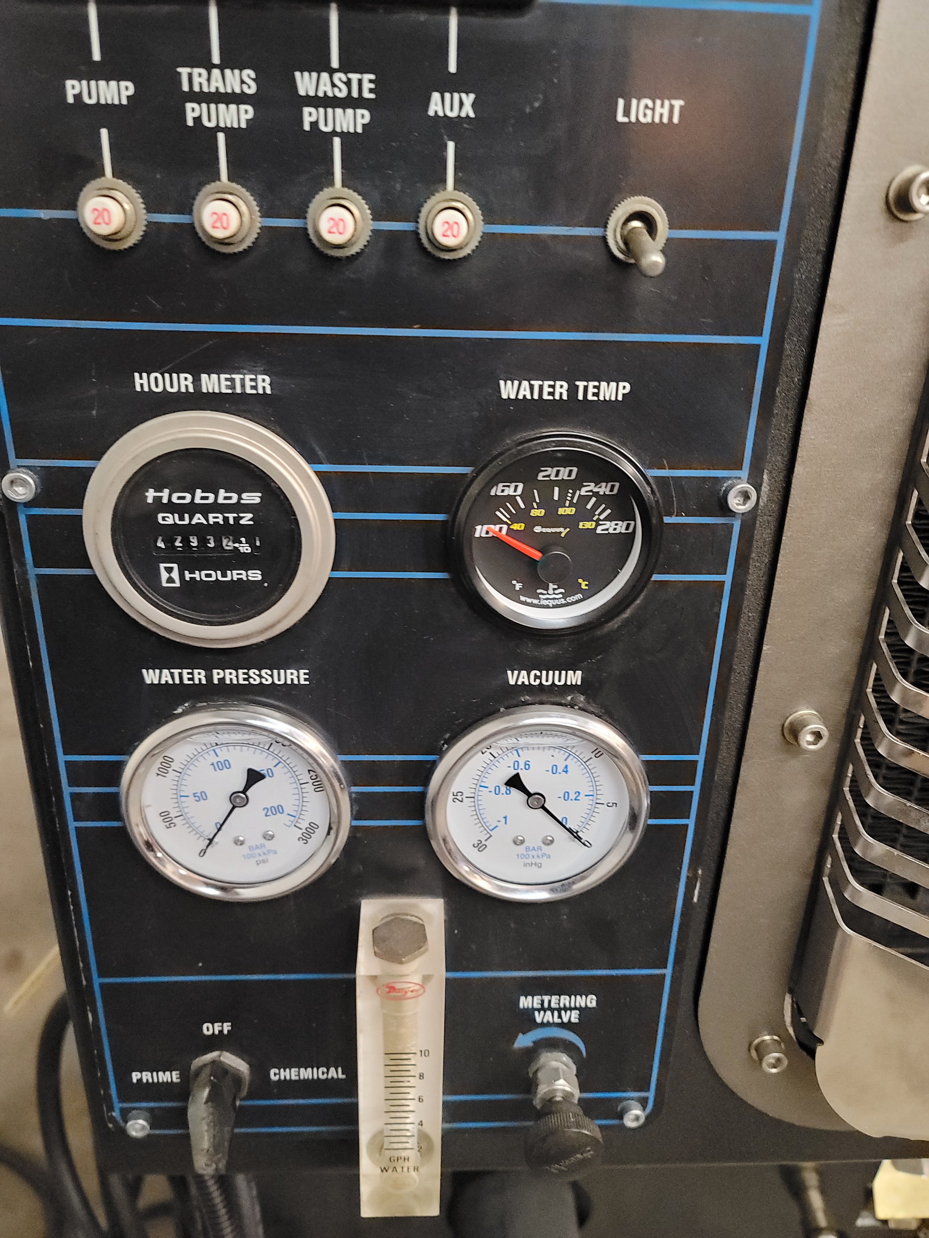

That noise goes away when I manually open the vac relief valve. Don’t insult me, I’m not a true dumbass

After all this time working on this headache. you think I don’t know how to work a vac relief valve ???!!!
It shouldn’t be making that sound at 13-14hg
🖕🏻U
14,207
Ok, I’ll adjust it
And when you see it making that grinding noise at 13hg
As I said the other day, sounds like a air leak.
Today's video, clearly a air leak but it sounds like it is leaking through your relief valve which is normal.
I know you say when you open the valve manually you do not get the noise but you are probably opening the valve further than it does during normal operation causing less restriction and less noise.
welp, do this
crank relief valve tight so it won't open.
cover the hose end half to 3/4 or whatever is needed to load the blower to 14hg.
(make sure vac relief doesn't open at all)
you'll know then if hearing a bearing, belt squealing or air whistling thru the relief valve
so easy, even a Matt can doit

i have the same machine been using for years . i have not been over all your posts but here are the part numbers for some stuff you will most likely need for the GM vortec 1.6L

i also moved my chem pump to the front of the machine to better access the diaphragm.

do yourself a favor and run a high 1/4 pressure hose to the front and mount your chem pump there with a shut off so you can turn it off for tile cleaning . its a bitch to swap the diaphragm in that position.

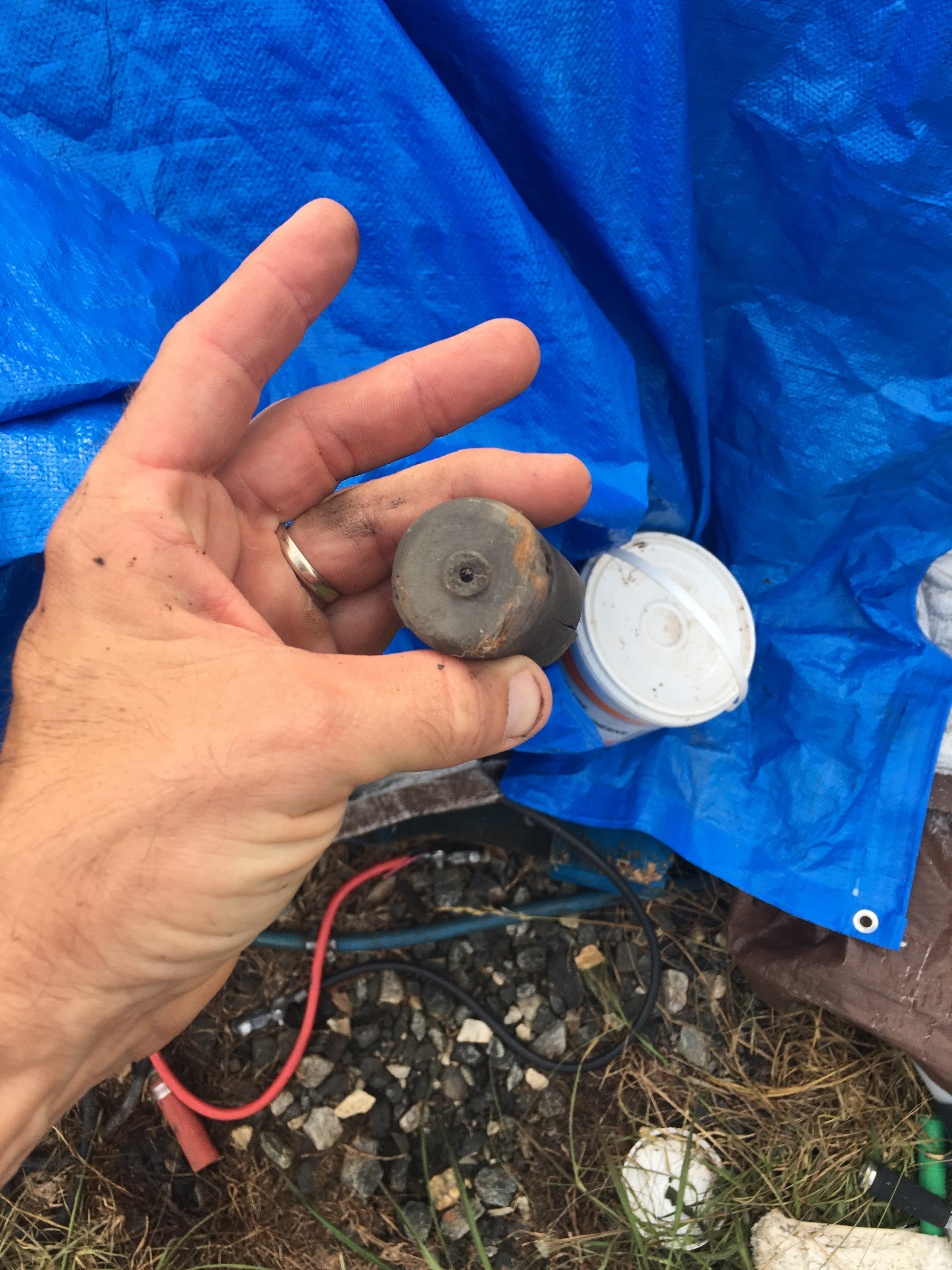

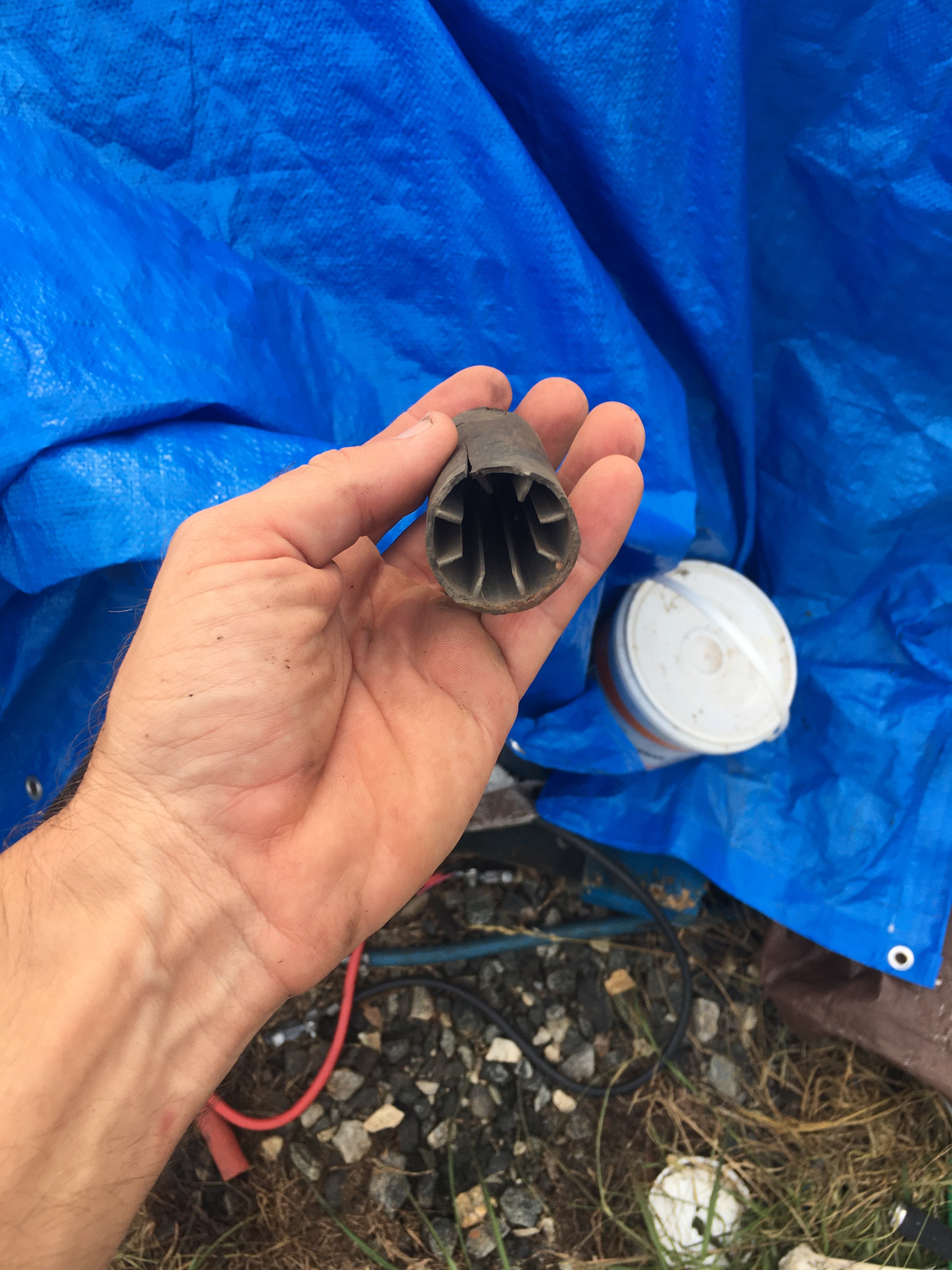

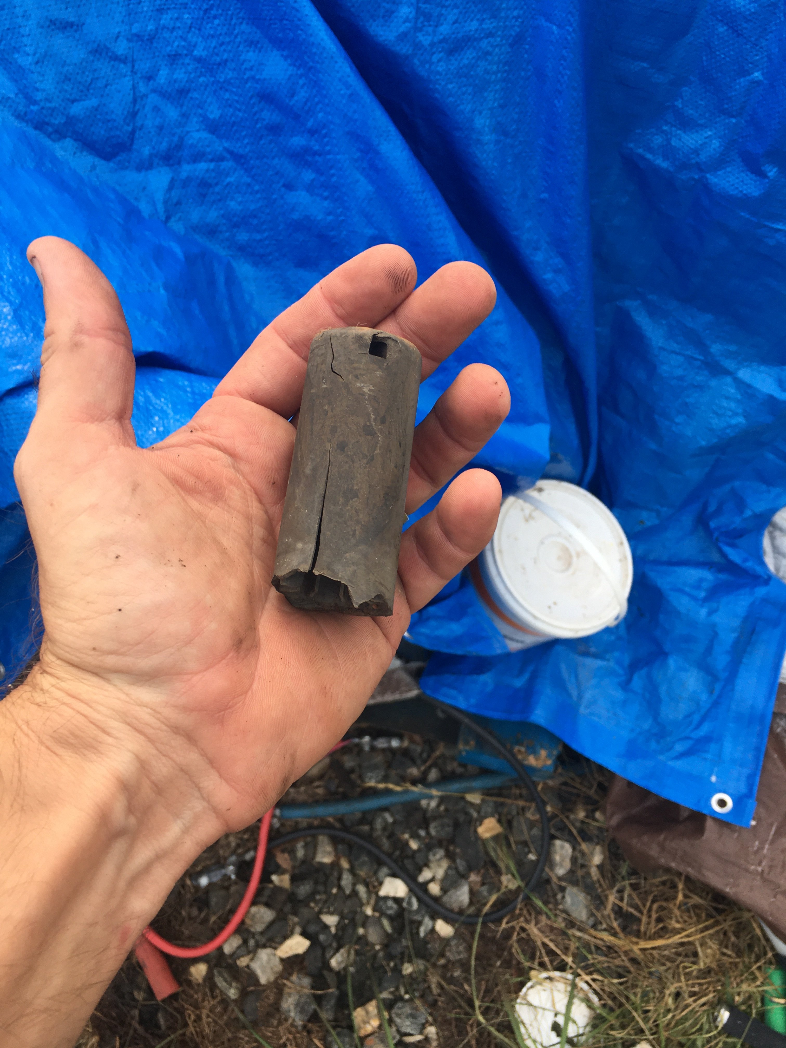

There's several questions I'd like to ask them about these thermalwaves. There was a crappy "heat shield" on top of the engine's catalytic converter that did absolutely nothing. It was just a thin piece of metal that laid on top of it. I had to come from the factory because my spare parts machine had the exact same one laying on top of it.
And the liquid heat exchanger provided plenty of heat, but it suffocated the water pump, not allowing any air to escape. I read other's comments about how the water pump's seals melted out west. I know that because they installed a tiny little fan underneath to help air flow. It wouldn't matter because the open air slots in the side panels were so narrow, hardly any air would pull through it. IT's like they wanted these things to overheat
and on my spare parts machine, I discovered this thing sitting in the silencer when I removed the blower a few weeks ago. There's no way it would've survived in one piece if it was sucked in through the blower. It had to be purposely put in there to do nothing but rattle. If the truck mount won't stop rattling, just go buy another one.
