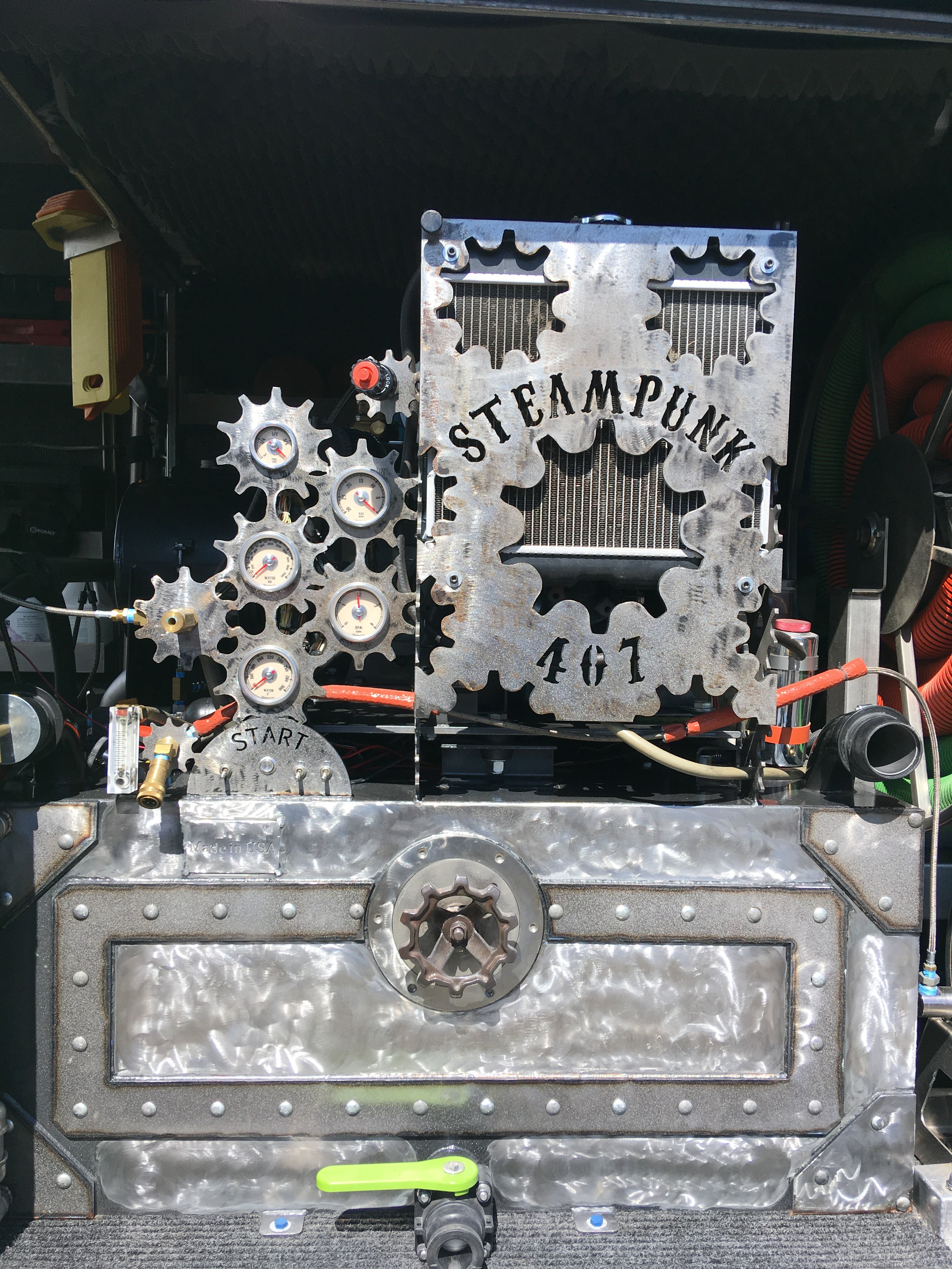

Hello, hello. So my machine cost me $24,500 in parts and took 8 months to build. Will I ever build another like it? No, because this one will last me until i retire. No hiccups or breakdowns on it (other than Kubota has shit mufflers so I had to build my own). Runs perfect like the first day it started. Maybe I’ll try and post a pic later. I only run ethanol free fuel in it, which makes a big difference.
Mike Draper
Jan 13, 2008
4,402
Here’s a recent pic. 1,600ish hours
