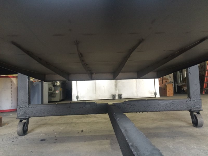

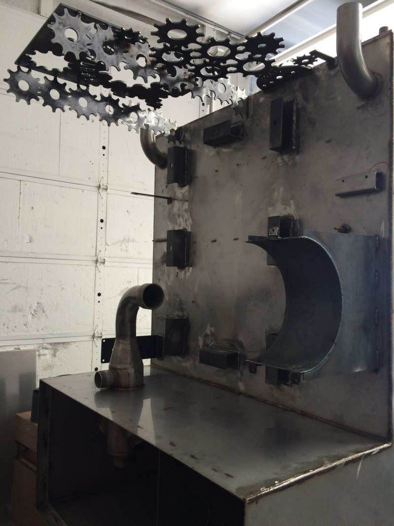

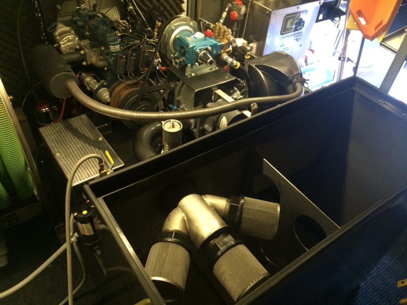

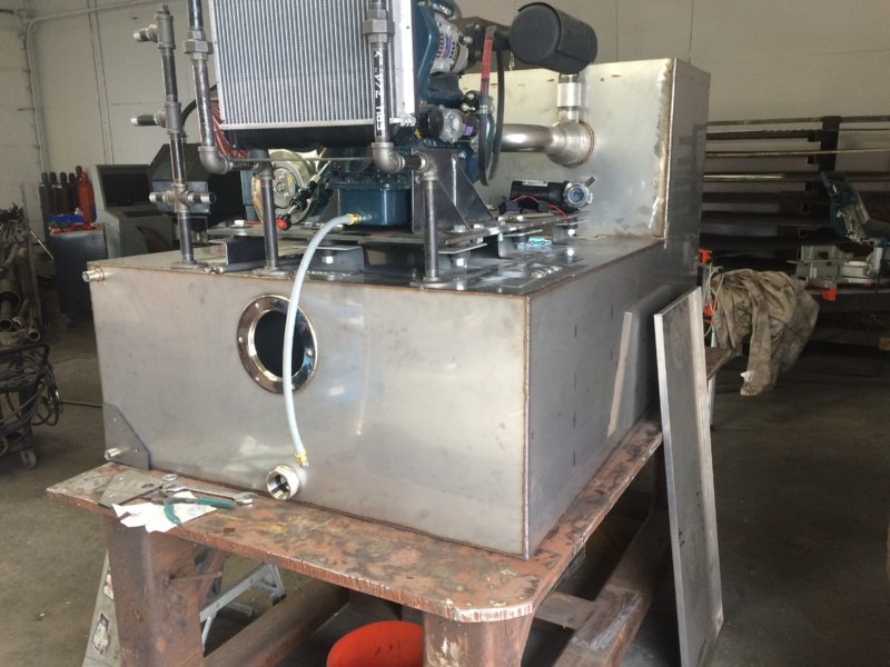

It's finally done. Been running this unit for 2 weeks and have 70 hours on it. Runs strong and smooth as can be. For many years I've been wanting to build my own rig. About 6 years ago I was talking with Olsen about taking my butler apart and reinstalling it on a box truck. Thank goodness he talked me out of it.
Fast forward six years and my knowledge of TM mechanics has grown immensely. last year my friend and MB lurker "Stan Wynhoff" finished his custom slide in. The guy is awesome at mechanics and no corners are cut on his rigs. After seeing his I felt motivated to finally build my own.
This project from my initial drawings to a running slide in took me 8 months. And of course in "Mike Draper" fashion I'm 8k over budget. :eekk: It's hard to estimate all the nooks and crannies of every part and all the time it takes for each individual part to be custom designed and fabricated. I had great help and design ideas from Les Jones. Thank you Les. You'll see many tank similarities on my unit that are the same proven fundamentals of a Judson.
At the end of this project, I'm super happy and will have a trouble free rig for many, many years. I purposely left this rig as simple and free of complex parts that wear out and cause trouble down the road.
I also couldn't have done it without the help of Jeremy and Vlad at Aero Tech. These guys went out if their way to make me some very custom parts for this rig. Thanks guys.

no warranty, just my own 2 hands. no db readings. I honestly dont like this blower. Many people sad there would be almost no difference in DB's, including manufacturers from different blower companies going from a "grease dual lobe" to a tri lobe. Well there is. I am looking at a tuthill tri-lobe grease blower. Its an exact dulpicate in dimensions. I may sell this roots and buy that as a replacement. I wanted an ultra quiet machine, not a regular sounding machine. Not going to get into price, but I'm still less than an Apex.

Just to clarify something. When I say the cost is less than the Apex, That is material parts only. Includes no money for the coutless hours of time, energy and stress spent on this project. I honestly have no clue of the time it took because it was such an invloved process. I know some knucklehead will say I can do this for cheap and have a great slide in. Its not really that easy and imagine what would happen if you made a mistake somewhere along the lines? $20k+ down the drain. I would have been devastated and financially hurt if I hadnt made this work right the first time. To each his own though.

Really love the laser cut gears all welded together make a front panel.
