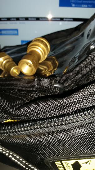

dont forget spare brass and QCs
got it......and there is an ace and HD within 5 miles of his place
I would need a roll of Teflon tape, a cherry fanta or cheerwine, and a check for whatever you think having the unit running is worth for when I fix it
