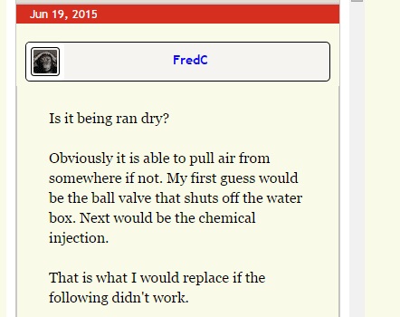

fred that post on june 9 was spot on. good guess. but just so you know us non mechanics can't think in the same way as you mcanical guys. if it was me i would have asked you right after you got the pump primed, "what is the root cause and how do we solve it." you got the pump primed and running but you didn't solve the problem. but you knew on june 9 what it could have been.
when you were with david did you want to test and/or rplace the ball valve or chem injector??? if it was me and you told me it could be those things i wouldnt have let you leave until we replaced those parts. and then run the tm and see if the pump worked. it seems that this was not done.
:hopeless::hopeless::hopeless::hopeless::hopeless::hopeless::hopeless:
If you asked me what the root cause was what would you expect me to say? There was no reason to assume there was another problem. He had the entire plumbing system apart due to a burst hose which would naturally cause it to lose prime and sometimes that is difficult to get back. That isn't a good enough root cause?
It was inspected for obvious leaks in different configs (chem on/off, bypass, etc) and held prime fine. In fact it held prime for multiple jobs days after I left.

david could get the pump to prime before you got there. but it didn't stay primed. Cobb had told him that it was a bad brass. not trying to be a jerk but not staying primed was a symptom of the real problem not the problem itself. if it was me i would have said to you, "thanks for getting it to work for now but have you solved the problem or just got rid of the symptoms?" If you replied I think some brass is bad then I would have said lets make a list and start changing them one at a time.
fred you drove so far to help him it is a shame that you two couldn't have changed some of the brass parts that day and if you guys did then maybe the bad chem injector would have been found. i would hve kept you there as long as possible and use your knowledge to fix the tm.
What is it you think that means? It was not in the brass pieces and when I left IT WAS pulling from the tank. WTF would I randomly replace brass based on something someone a thousand miles away said over a phone that I had already exluded as the issue? If I replaced the brass and primed it again nothing would have been different.
and the fact is you most likely wouldn't have said ANY of that.....you are basing what you think you would say on reading this thread and knowing there was an additional issue.
I mean you followed the thread from the beginning....where were you during the 3 weeks David didn't say anything.....did I miss your "but did Fred only fix the symptom" post?
