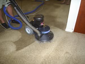

TimP said:
They can be hard to get out on an Rx-20 too.
I think it has more to do with high heat and better drying.....but I'm not entirely sure that's the case.
I think on the pile above using the wide toothed grandi groomer is the best rake for them. Dense cut pile the groomer that's more like a broom than a rake is the better choice....loop pile I rarely notice swirls in them. This thread has made me pull out the RX again on residential....
I was thinking along the same lines. I know MD uses 2.5" hose. Are those swirls from the rv360? I can honestly say I've never had that problem with the old rv360. I use the GG (hole) on it. But I don't have the high heat and major suck. I always use a nap brush though. Seems abit weird.
tracywalker
Oct 11, 2006
257
NC
Tracy
As nasty as the before picture was I wouldn't be too worried about those lines. I definintly wouldn't even think about having to replace the carpet. I bet in a few weeks of foot traffic those lines will be long gone.

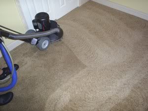

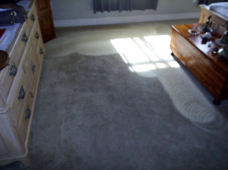

Mike Draper said:
here is a picture from a while ago. These lines are almost impossible to get out. A rake wont do anything. This was extremely dirty, when you make a pass to the left the weight of the machine will scrub harder on the back 1" which results in a better clean on that 1" area. I came back and re-cleaned the opposite way....nothing, then I pre-scrubbed with a different machine and re-cleaned with my Ti-wand. By this time the lines were only a little less noticeable. fortunately the owners weren't to picky and it didn't bother them. Otherwise You would be replacing carpet. I love the Rv-360 and think it is one of the best cleaning machines out there, however you need to be careful choosing where to use it.
Mike...."Does this look FaMialEr".... :?:
I was on the job for this one... :!: "I said WTF....?"
They "thought" the NEW RX cleaned like this... :roll:
The PROBLEM was a "Partially CLOGGED Jet"... :wink:
CHECK YOUR JETS..... :idea:
ps...These are these seperate jobs... :oops:

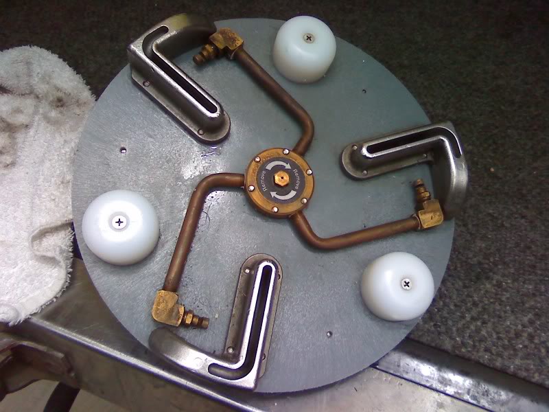

Mikey P said:
Notice the ramps..
WOW! I would say that the inside edge of that vac slot should be rolled over more(probably great scrubbing tho) :shock: Probably the reason that it distorts the pile.

the first RV had rolled over glides and it distorted the pile as well. Maybe I should explain more. on 1 out of 100 it distorted the pile.

why didn't they sink the screws down below where you'd ever wear the teflon to?
Mike Draper
Jan 13, 2008
4,402
doesn't happen, i put over 1000 hours on my first rv-360 and it still wasn't even close to the screws.
