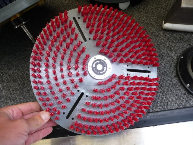

So here is the brush head, I believe this is the original design that was known for breaking motor gears when it struck a register or transition strip too hard. Harder to control and has considerable over spray compared to the new version..

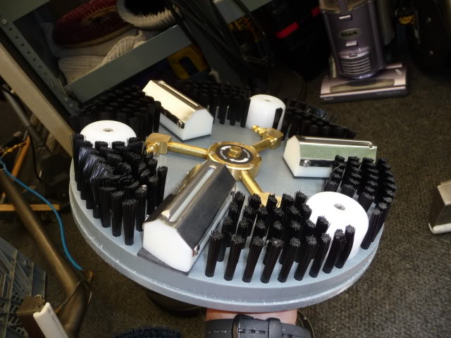

This is the pad driver that I have not tried yet..

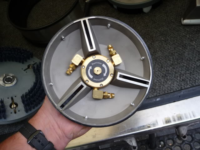

Tile head with floating vacuum/splash guard ring, not used yet..

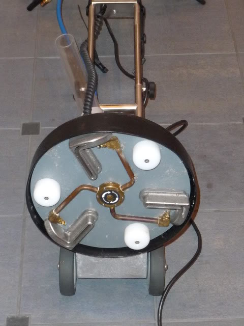

This is the flush master. Love it! Did two CGD today and it worked great just as dry as a Ti wand but 20 times as clean. Turn down the speed when you hit a uneven sub floor. You'll notice through the sight tube that the slower it spins, the more water you recover. Notice the L shaped vac ports, see how the leading edge ramps up? Designed so it glides over hard obstacles thus saving the geared motor

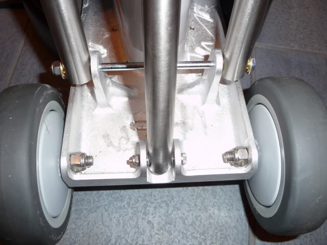

Not as beefy (over built) as the RX20 but appears to be strong enough in all areas. Time will tell.

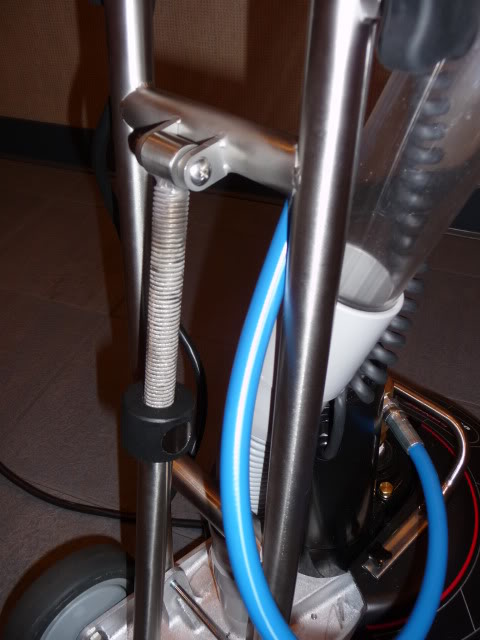

Notice the round button on that black collar? That is what you push to release the handle adjusting rod. Very cool

so why would they send something that was KNOWN to break stuff??
thought they sent it to ya to try out the new stuff
116,468
I think they market the old style brush head for just greasy spoons now
With the new head I dont see any need for a brush.
Why did they send it?
I asked for a shampoo brush and this was all they had.
