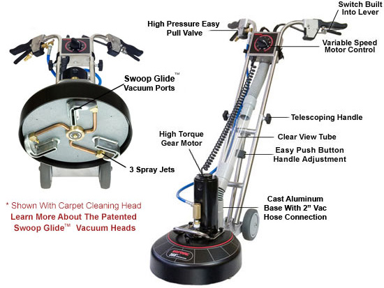

Pretty darn impressed so far.
5 jobs in has me convinced it cleans deeper than a 175 wand combo for sure.
If the same job were done with the 360 vs the wand/175 combo the 360 job would take about 15 to 20 minutes longer on average, at least that's my guess right now. Trimming out along walls corners and transition areas as well as stair cases.
For that extra rime spent you leave the home owner with more deep crud removed equally as dry carpet. I'll do more testing but I'm gonna predict that rinses don't need to be used in most home scenarios due to the intense flow & agitation, soft water will be all you need. Be prepared to dump more often. Two inches all the way to the head provides much better drying compared to the OG RV.
Perks so far..
Very lightweight
Very easy to use
As good as it gets results
Good alternative for carpal tunnels sufferers.
Well built
Stay tuned.
116,468
Of the five we did so far the brush head/pre scrub was not needed. Just pre vac and pre spray.
The RV rep told me the brush head is just for grease pit CGD

:shock: Really... They changed it that much from the regular 360?? How does the brush run on higher pile carpet? Cause with the first 360 you could hear the motor struggling with any carpet without the brush.
116,468
No brush on the head I'm using.
Just L shaped vac ports.
Glides along real well when the correct handle height is set.
116,468
Can';t honestly say Joe.
I could never use that tank for more than a few minutes.
I would imagine it would be darn near equal in cleaning results. I bet it drys better though.
But no over spray and less damage to transition areas and register covers due to the ramp shape of the vac heads.

I haven't used this 360i unit... :!:
But...It doesn't look as if it is very durable...I would be concerned if it would HOLD-UP...
under a High Heat & vac. from the LARGER unit's...such as a "V" or "AT"...looks a little
"tOyIsH"... :roll:
The additional "weight"..of the RX20...does have it's advantages...in a LOT of situations.. :wink:
http://www.hydramaster.com/accessories/rx20.asp
Overall...the RX...just LOOKS..better built... :!:
And has a LONG TRACK RECORD...of enduring the ABUSE of "TECHS"...."just saying".. :idea:
PS....What is the DIFFERANCE in price... :?:
Pss..."NOT"..that "U"...ever have to buy AnYtHinG.... :p
116,468
We'll have to do a Rx20 vs 360i shoot out at MF.
The only thing I can see that will be effected by high heat is the hose from the site tube to the head.

Mikey P said:
No sight tube on the RX?
CLEAR 2in. vac hose... :!:
But...just like the "site-tube"...on the 360i.."It will look like sHaRt..in 90 days..."
IMO ....site tubes are a .."double edge-sword".... :roll:
A picky CuStY can be .."Up your ArSe".. and QUESTION the tech..."Don't you need to go
over that area AGAIN..." "I can "STILL see dIrtY waTeR...coming out.." :twisted:

Cliff designed both the RX20 and RV360. I don't have the 360i but I do have the OG 360. RV360 does have it's limitations on uneven floors where the floating heads of the RX20 works wonders. I'm looking to upgrade the 1.5" port to 2". I haven't had any problems with the motor bogging on any carpet unless you start it at 1 or 4.
I use my 360 with my portable more then the TM. I have a pimped TI hybrid glide with 6 02 jets. More water flows with the wand but the 360 does dig more crud out. My 360 has hole glides on it. I loss some agitation switching from the full slots to hole glide but gain dry times.
