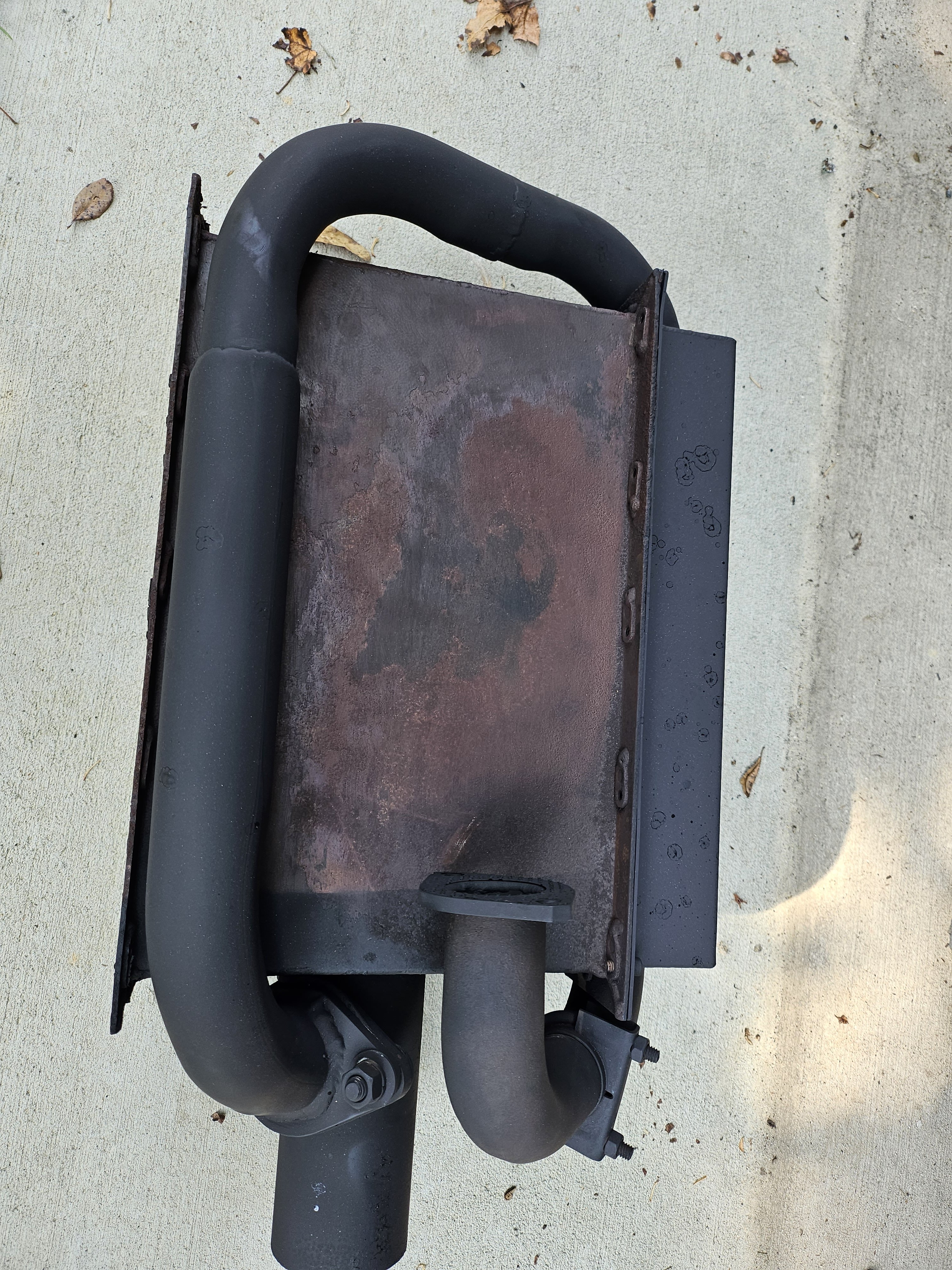

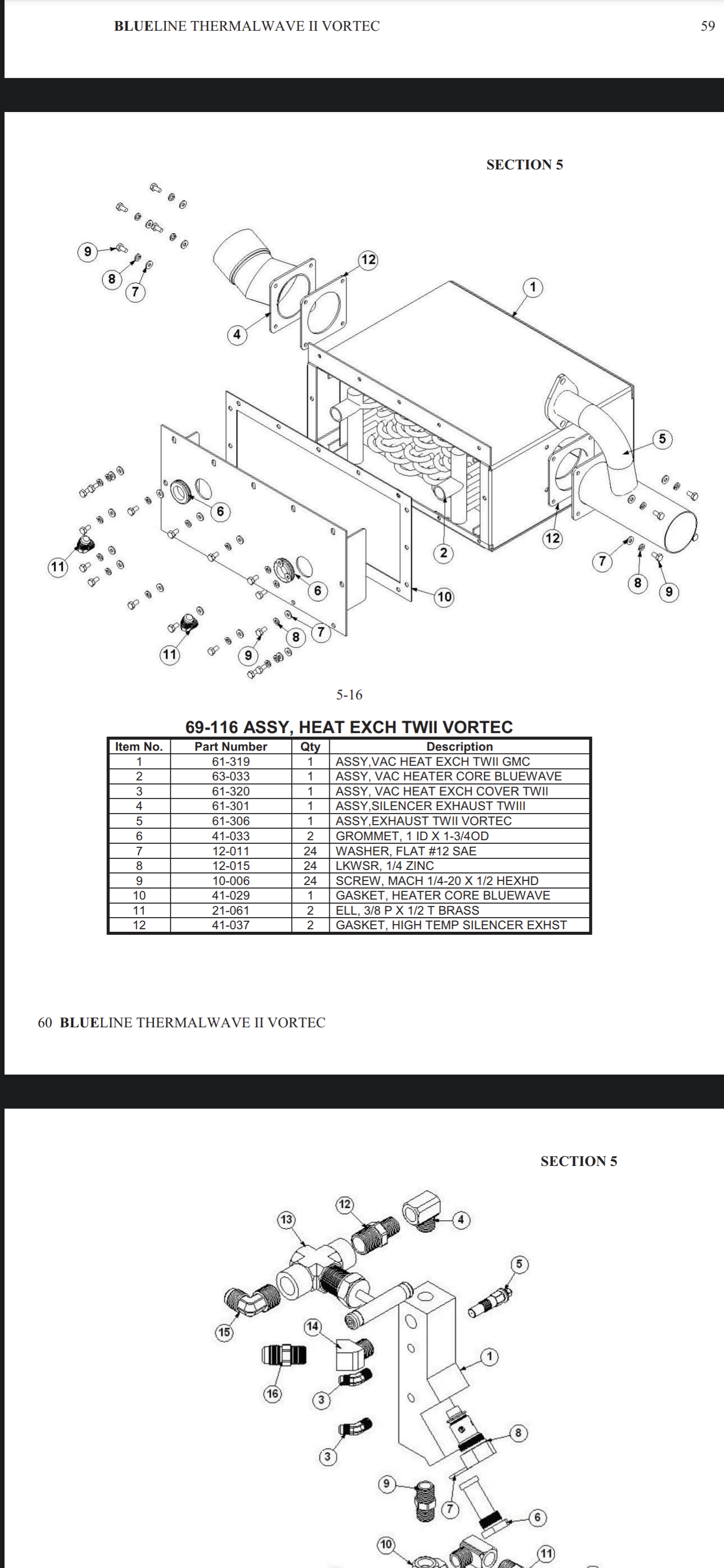

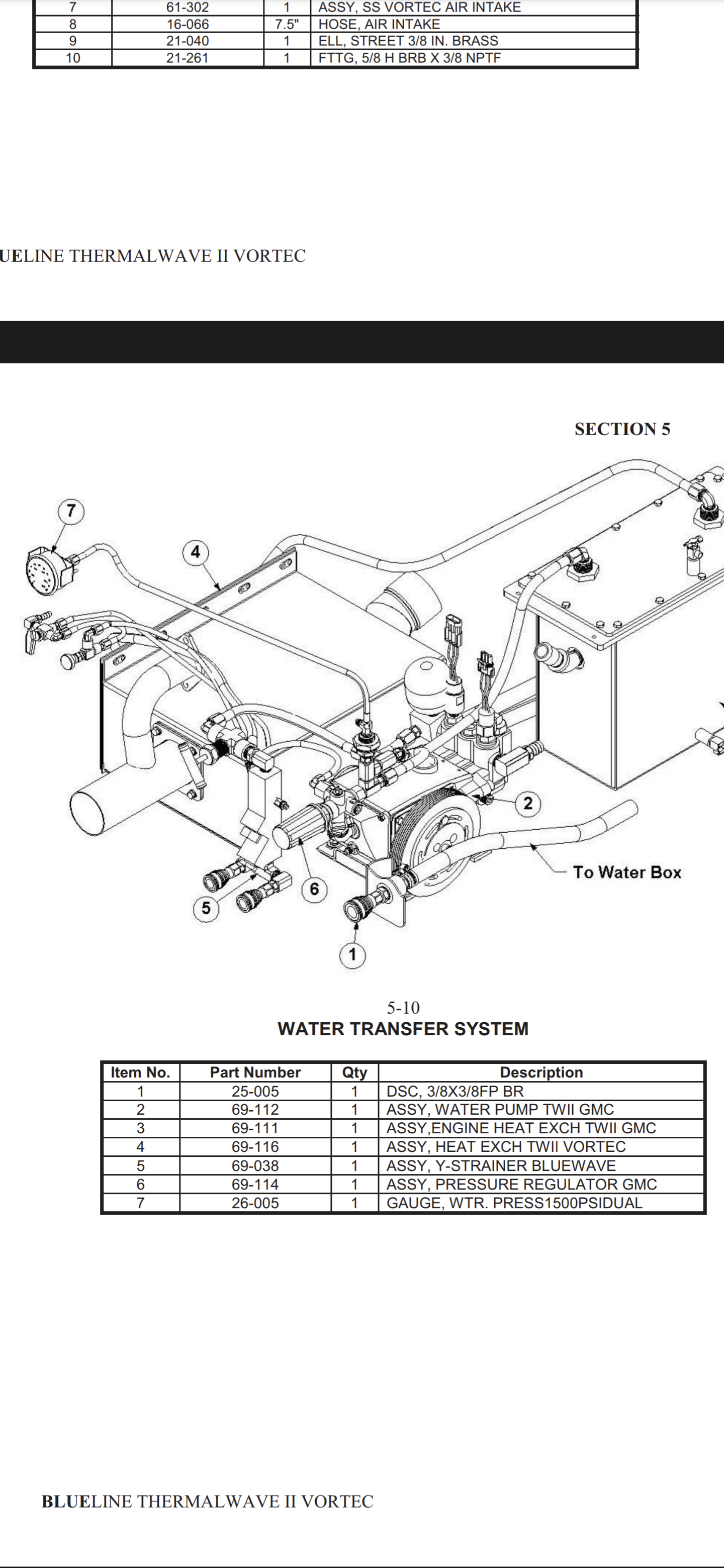

Is this what we're looking at got this from a thermal wave 2 vortec manual online???
Looks like the exhaust is post blower heat exchanger in the image.
Also there is a part number call jondon parts Dept that may have access.

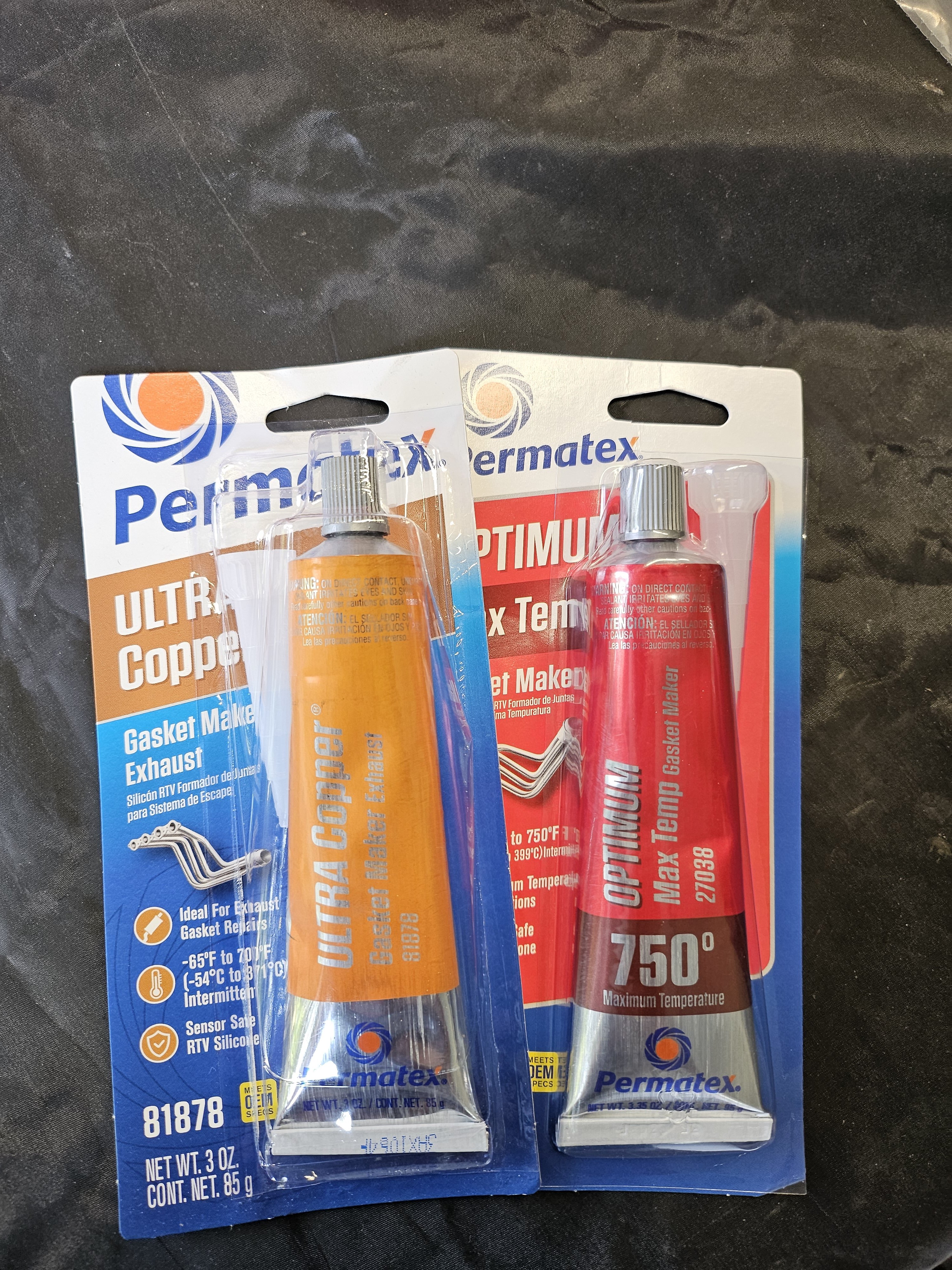

I settled on just high temp gasket maker mostly bc I don't see going past 5 years before needing some major rebuilds on my setup so the gasket maker will be fine. Higher temp for the exhaust side and copper for the non exhaust side of box not that it really matters lol just was a few bucks difference in cost.
