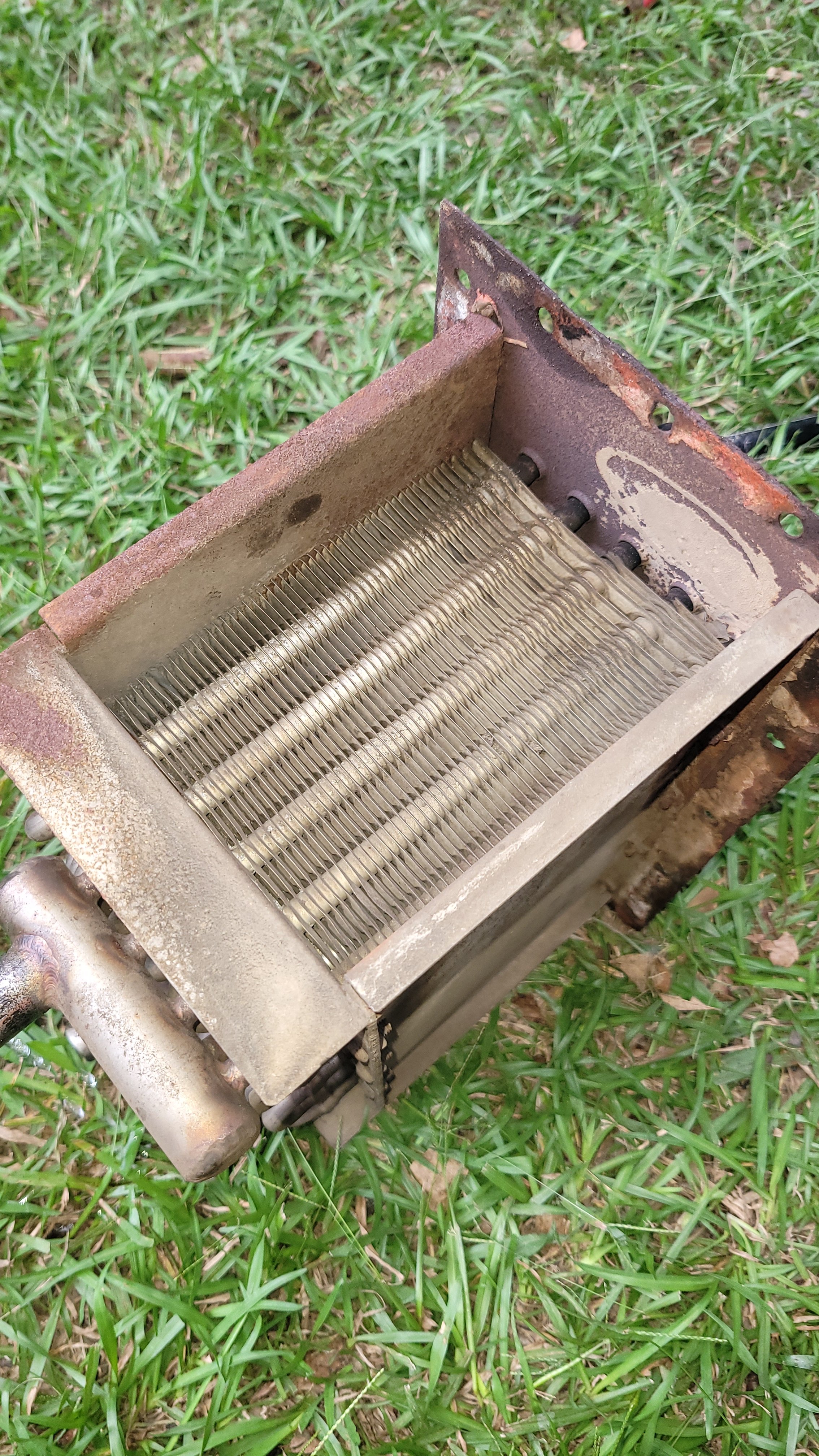

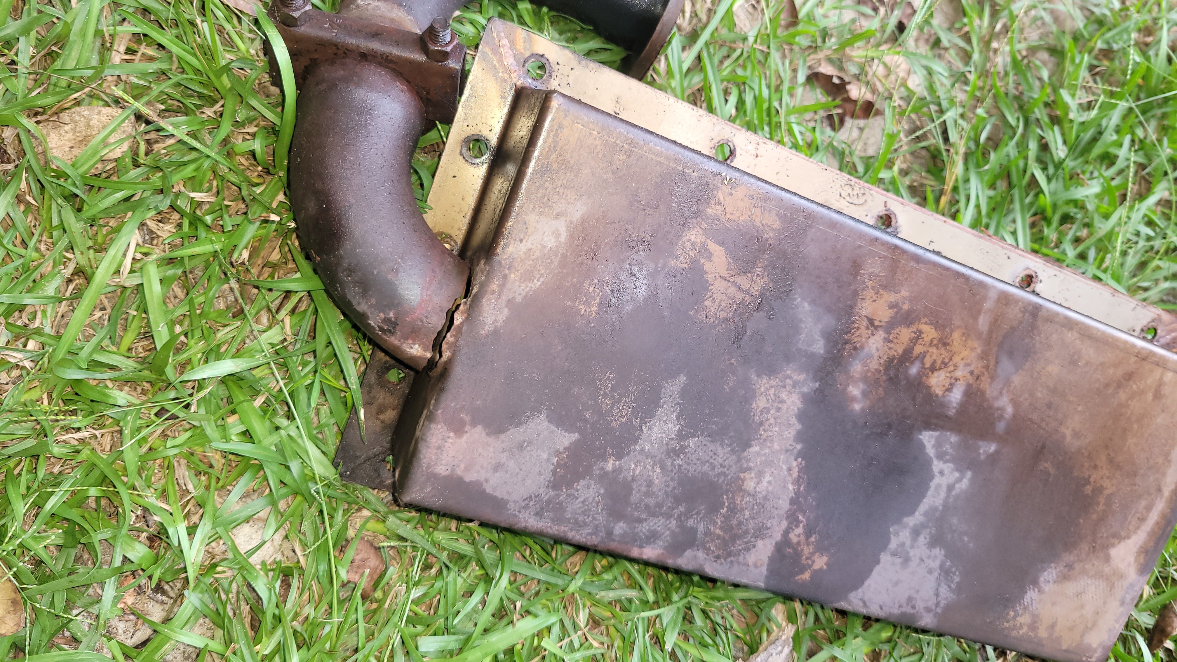

Ik this subject has been brought up and Ik I can buy gasket maker material from my local autoparts store ( I use to manage one) but im really curious as to what exact material the heat exchanger gaskets are? They seem to be a silicone material but I want to make sure whatever I get is resistant to fumes as well as the occasional chemicals that work there way past the blower. The one I purchased from jon don doesn't fit my model 🙄🙄 @BIG WOOD maybe you have some insight?

I'm desperately in need of useless knowledge to be fair lol. Not that it matters bc ik I can just use auto parts gasket and it will be fine but I can't help myself on wanting to know specifics. Also gonna try and get the correct material so I can make more on this machine for future

You’re only getting the blower exhaust through that heat exchanger so any high temp gasket material should work with the high temp red colored gasket sealer

Yea I figured as much I just noticed the old gasket is a silicone material and if it's original its lasted 7300 hours. I'd love to put something that good back so I don't have to think about it again until the heat schanger goes bad or something

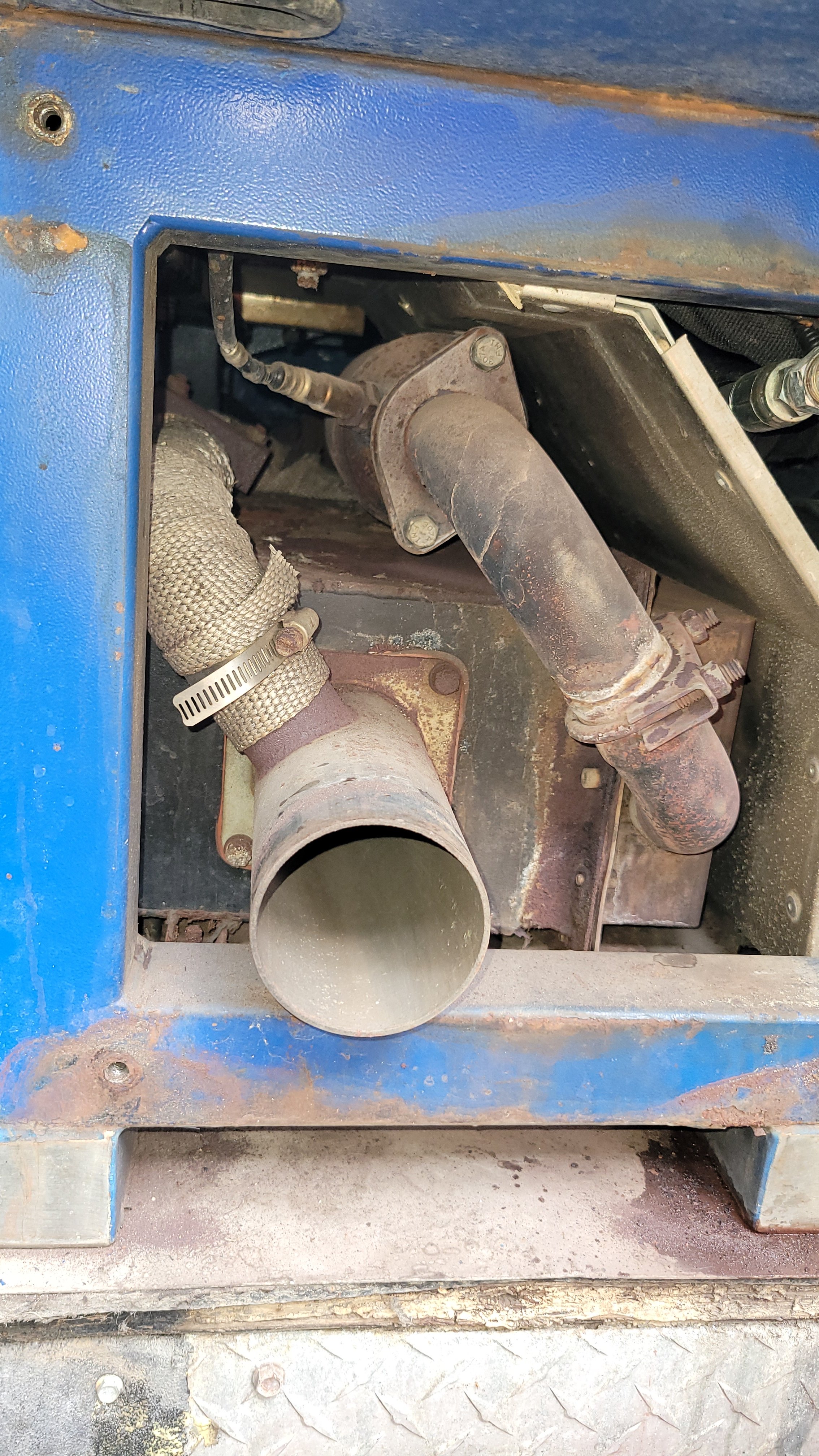

No gas fumes in that side. Remember, your engine exhaust is bypassed on top. Am I correct or does your pipe connect in that side as well?

Gas fumes go into the whole heat exchanger and effects all gaskets but primarily effects the right side
