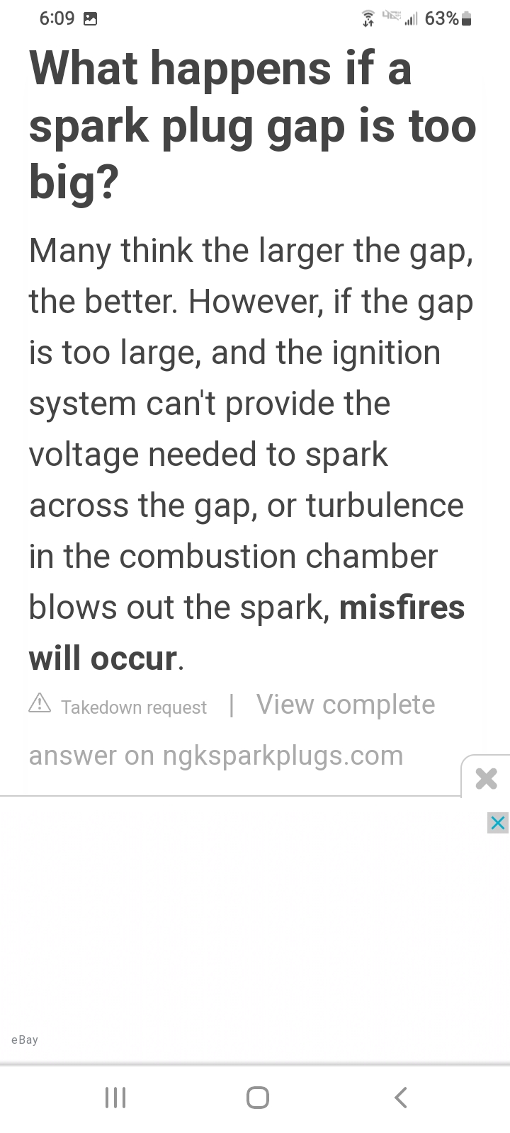

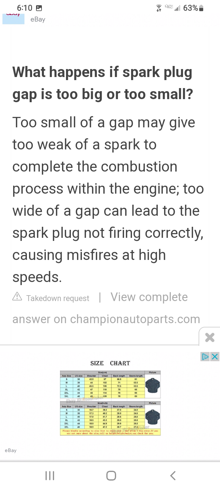

It's possible the engine wasn't producing the power needed....how far off was the gap
