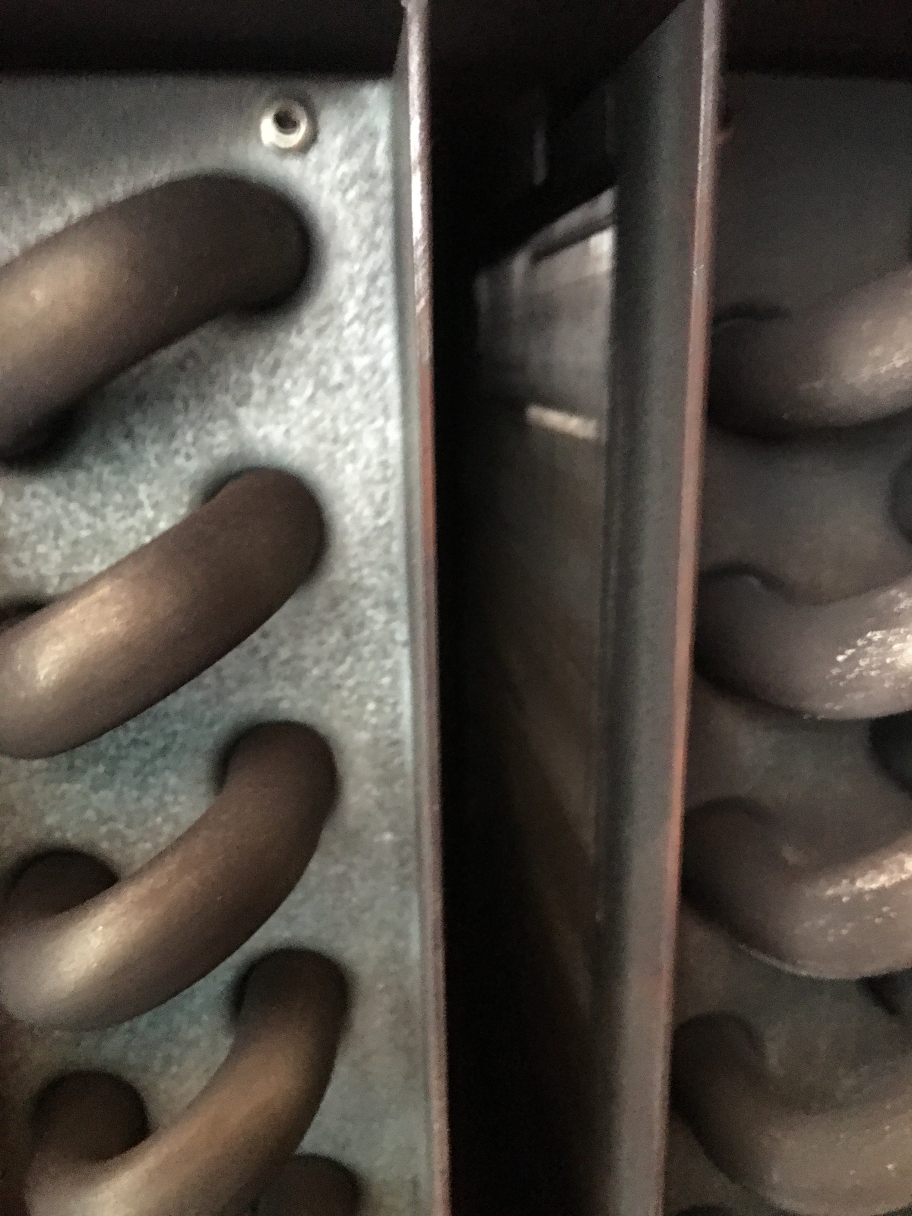

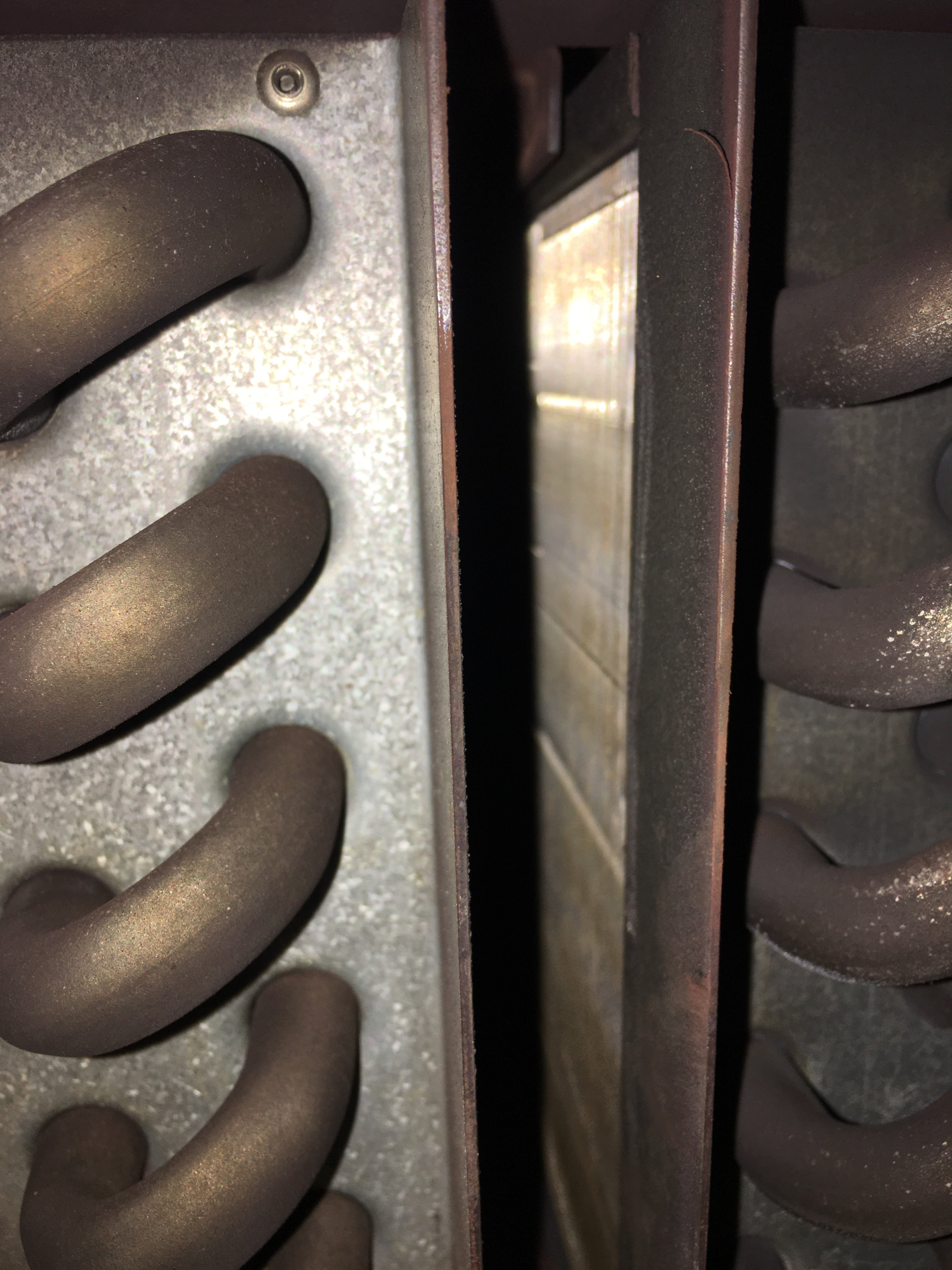

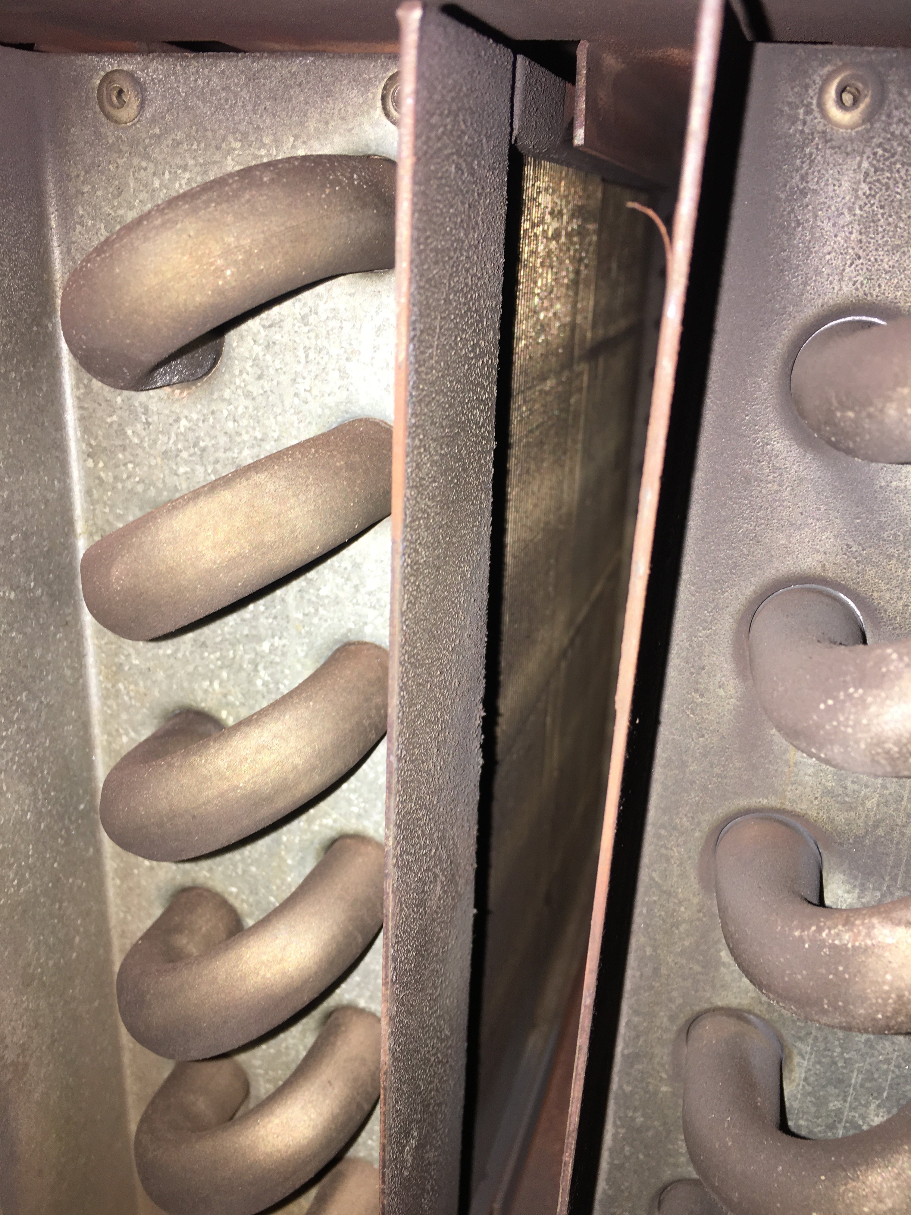

I don’t know how it looks inside the silencer yet, but I opened up the heat exchangers. I see no blockage. I wasn’t able to get a pic of the first fin coil, but I could see through a bolt hole and I noticed no blockage. It breathes fine on this part

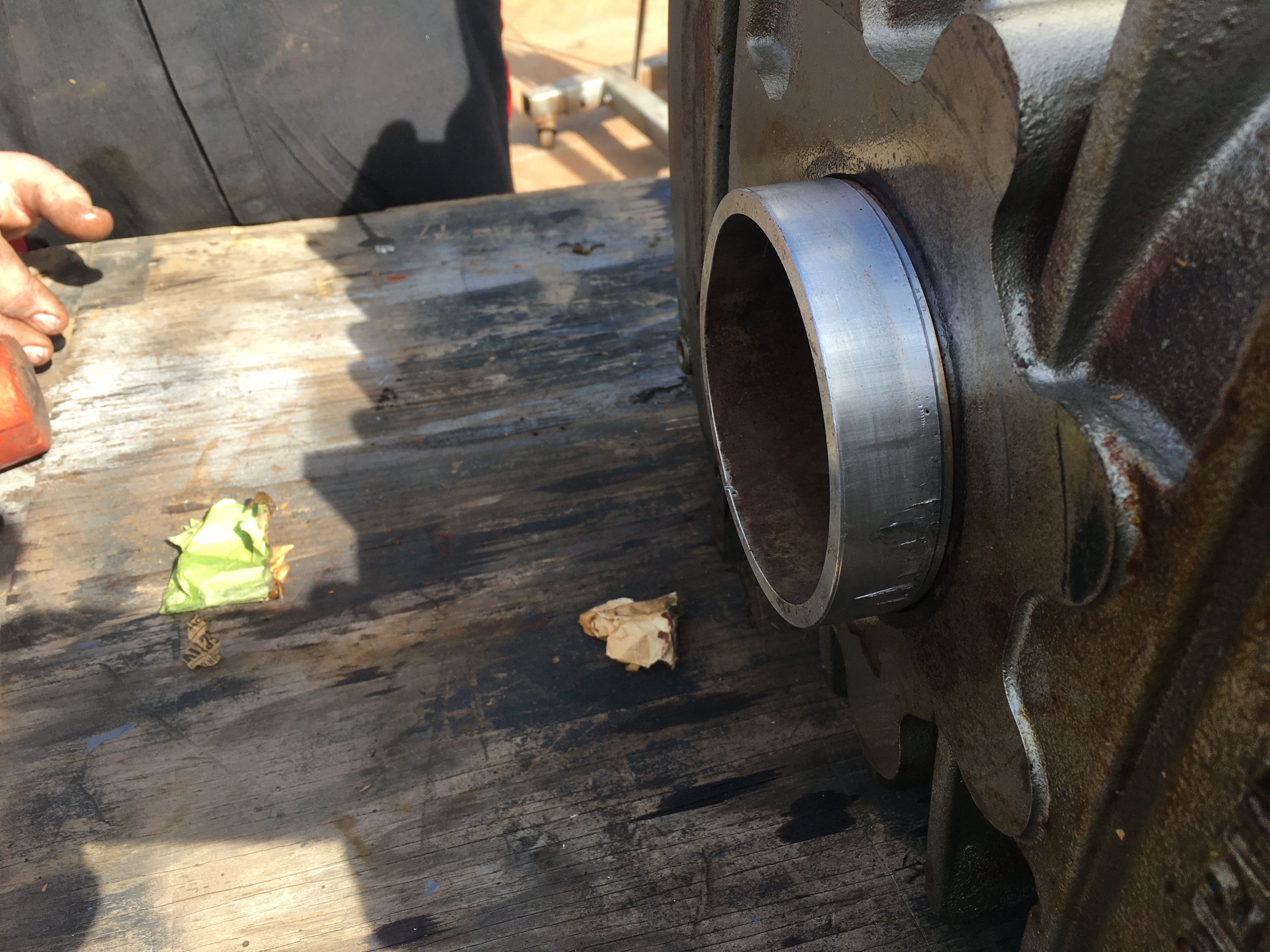

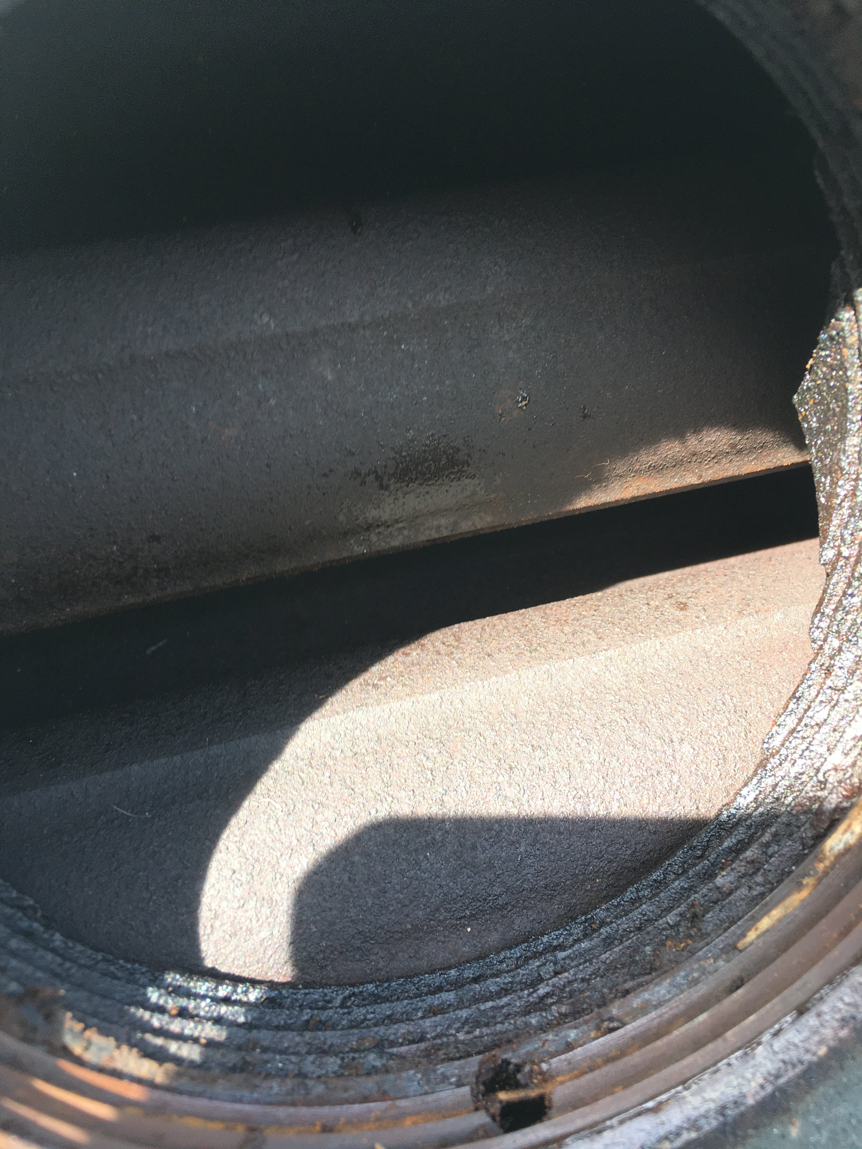

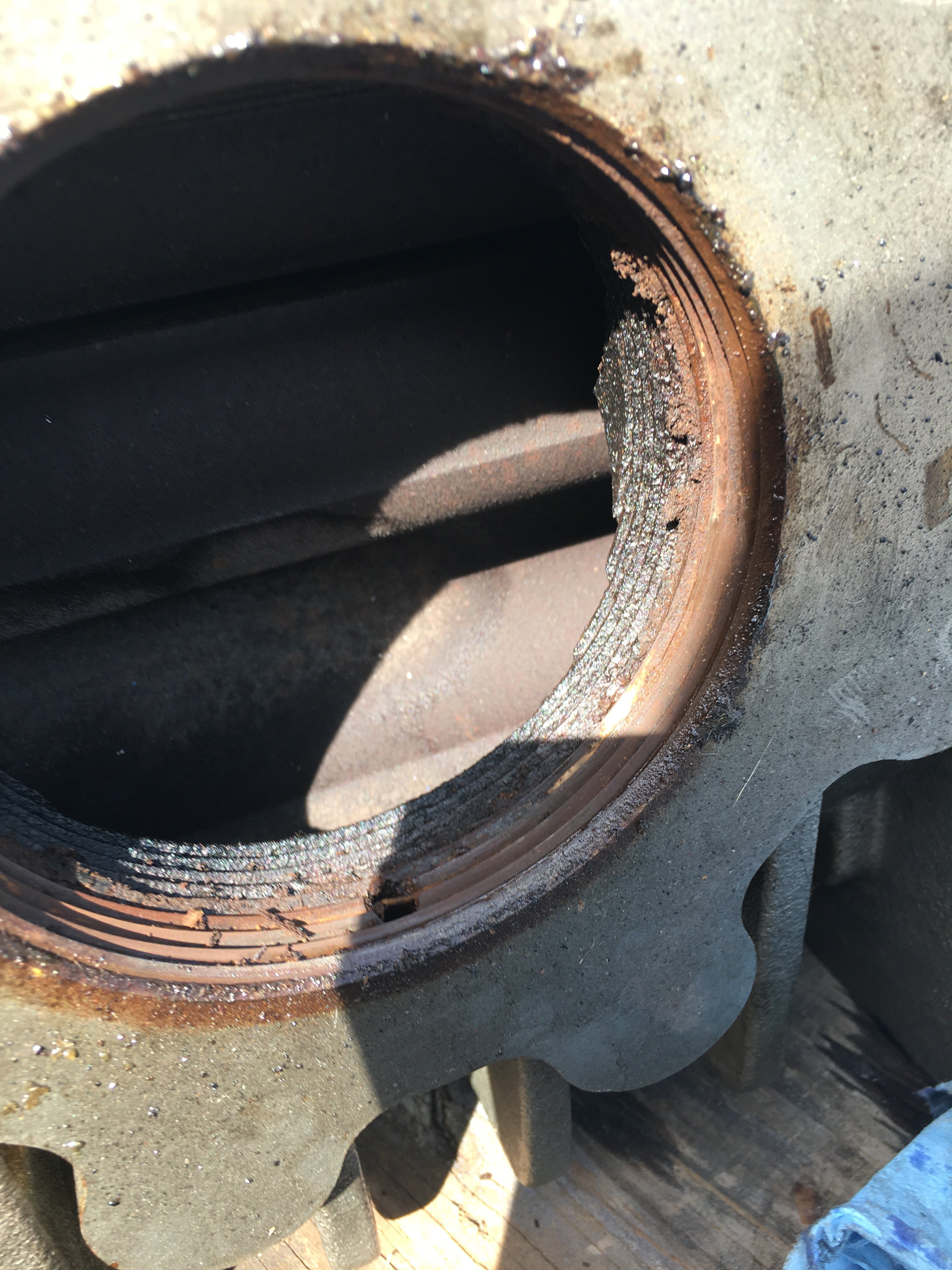

Got the blower out. Can’t remove the bottom pipe, so I’m having a new one made Monday. ☹️
Here’s a couple pics of the lobes. I hear a mild grind when I turn the shaft. I tried moving the shaft side by side and it didn’t have any play this time. Weird
05A347CC-0719-4451-9BA8-FE40F0B52914.jpeg 946BED19-13A3-4E7D-84FB-7C9FBAB72460.jpeg 4FA46CBA-99FC-474B-BB4E-189AE10FD3DC.jpeg
If it just sounds a bit scratchy it’s probably just the rust buildup
but maybe when it heats up there is more interference.............I'd expect more noise though
