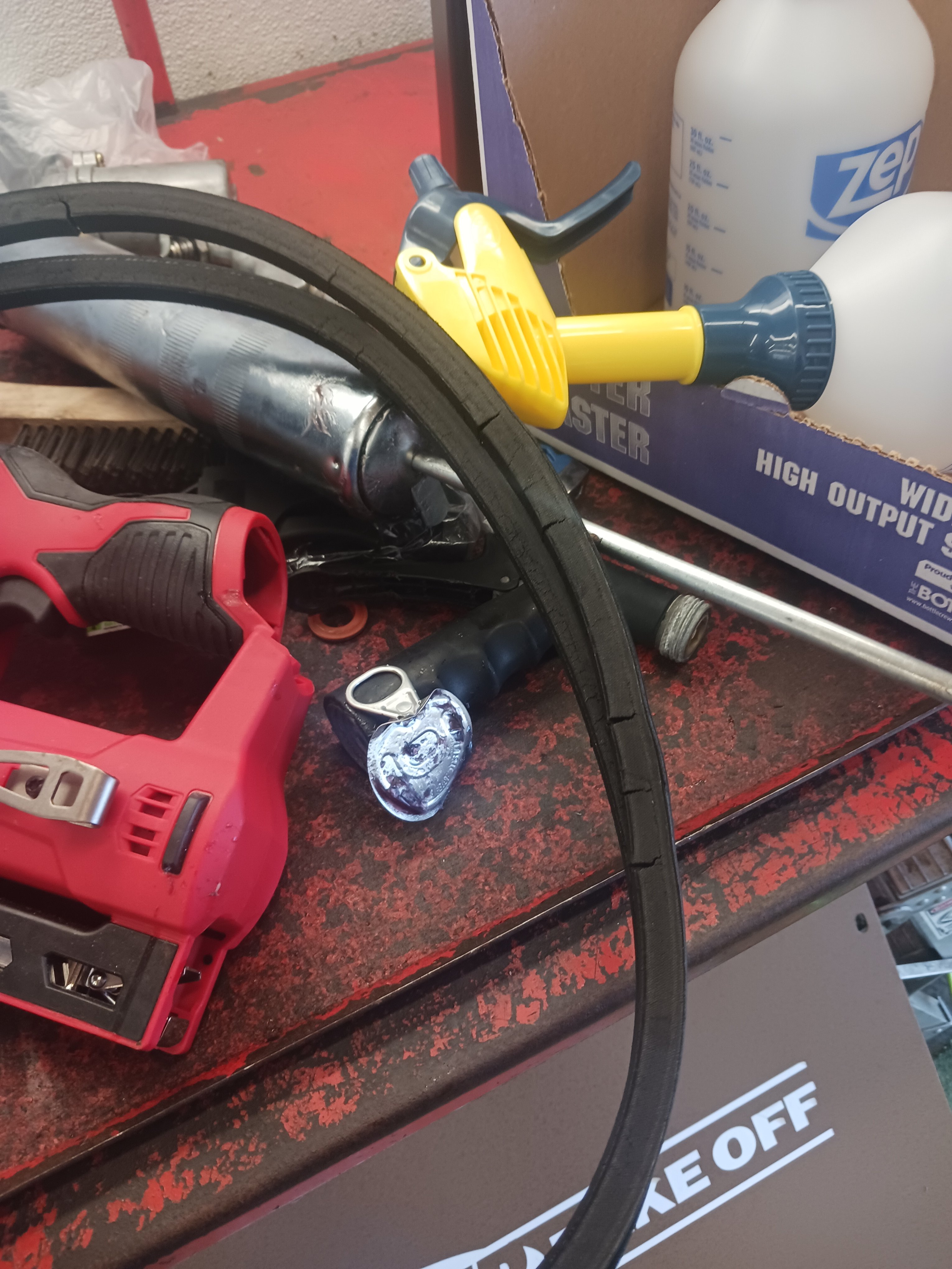

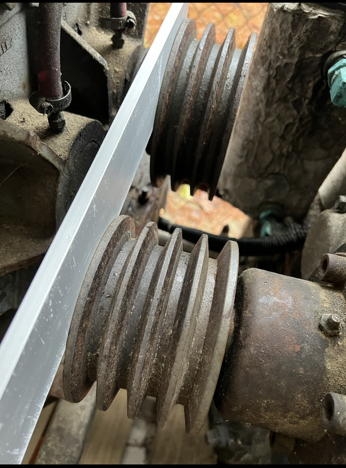

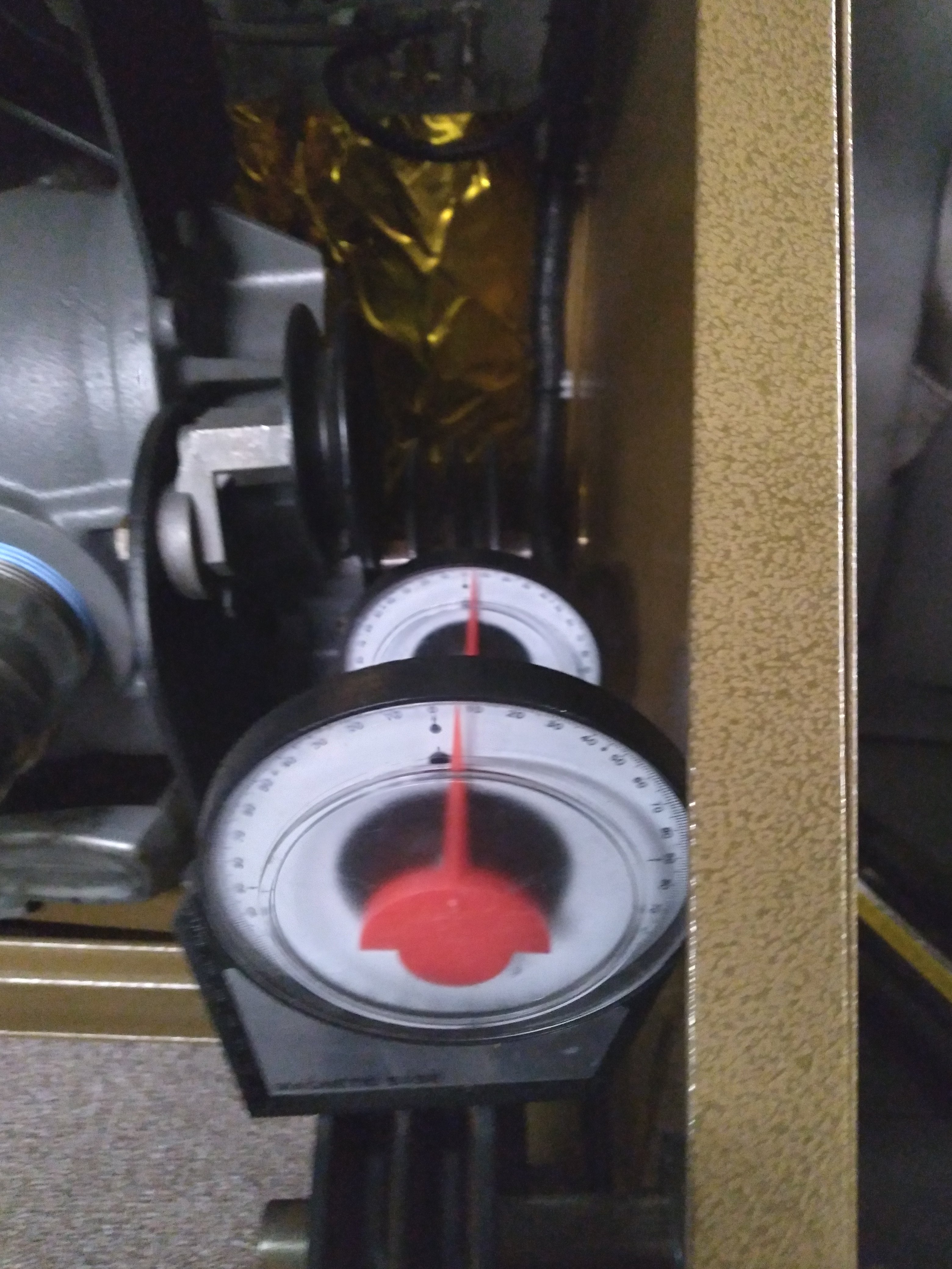

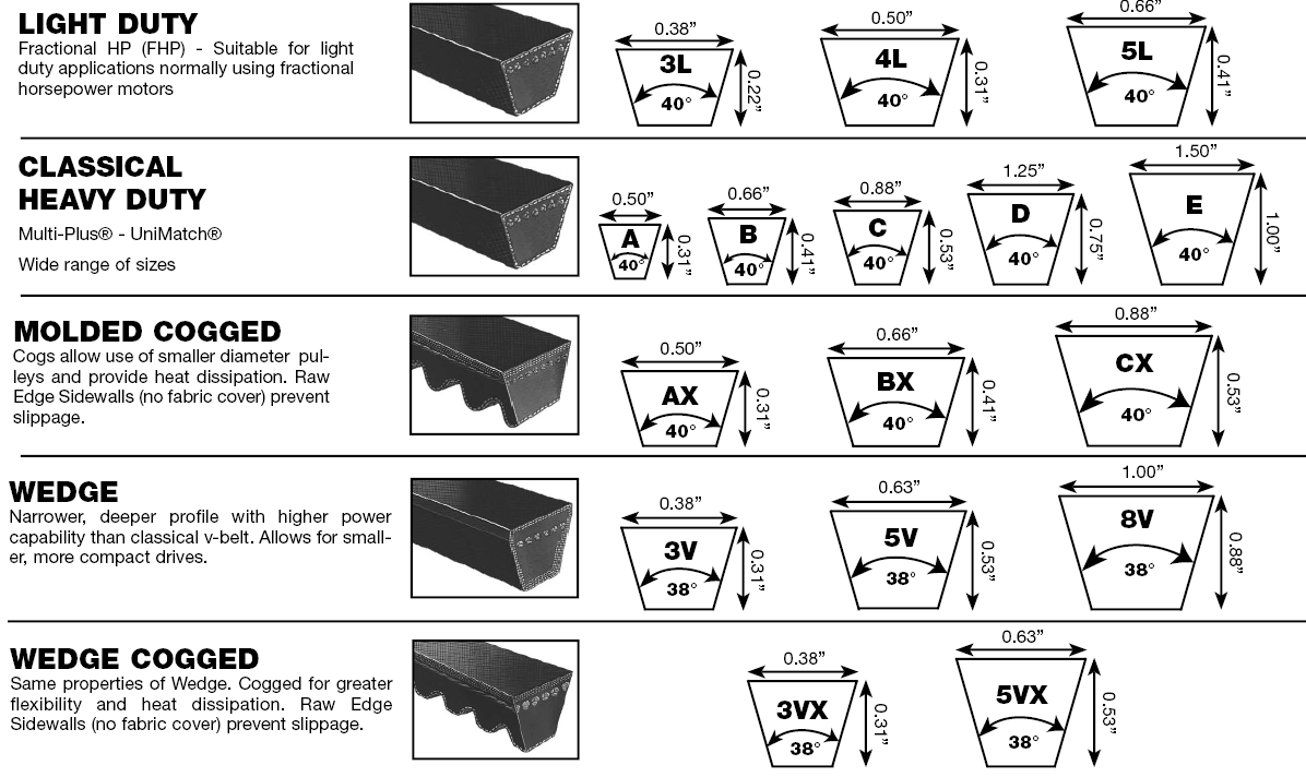

B 41 is a standard vbelt, they tend to heat up especially the smaller lenghts heat could be all or part of your problem may i suggest going to a clogged belt (BX41) belive it or not they have approximately 6% better grip and power transfer but more importantly way way way way (4 ways)less heat. The 2 killers of bearings is lack of lubrication and heat.when i built frankinstien i experimented with belts, my main blower drive belts are B41 first i used as you standard B41 (first picture) than aramid (second picture) now clogged BX41 (picture 3)no heat , problems gone even when tighter than normal. if your blower is properly lubricated then maybe your problem is heat. Alignment was not an issue on any of these belts (picture 4)

And for the pulleys to be in line, the mounting plate needs to be same distance from the frame on both sides where you adjust the tightening bolts. There was no uneven tension on the pulley
This assumes everything is square from the mounting to the shaft
I went out in the rain for you to show checking on my genesis project
check at the pulleys not the mounting/frame
I have an alignment magiggy somewhere but I'm not digging it out
14,102

Looking at specs im using molded clogged BX blower belts AX pump belt
Molded clogged wedged clogged potatoes pototoes,
Im retracting this statement it appears upon closer inspection wedged belts appear to be narrower and set deeper into the pully i have no experience with them bx and b belts have the same dimensions
