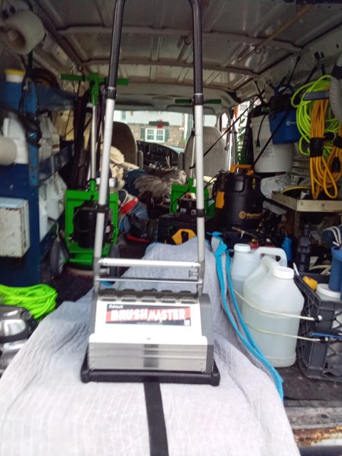

A good CRB like the 14'' Brush Master Pro 35 does all the work. It has a faster brush rotation, is built like a tank and heavier than most CRB's. The added weight makes a positive difference. It makes it a more aggressive scrubber and helps it dig out all the crap the vacuum misses
I can't imagine using the VLM Method without using a good CRB

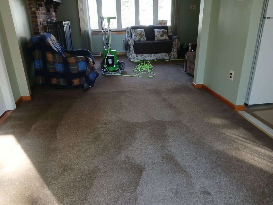

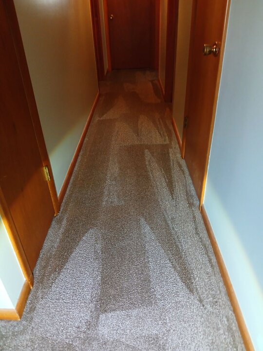

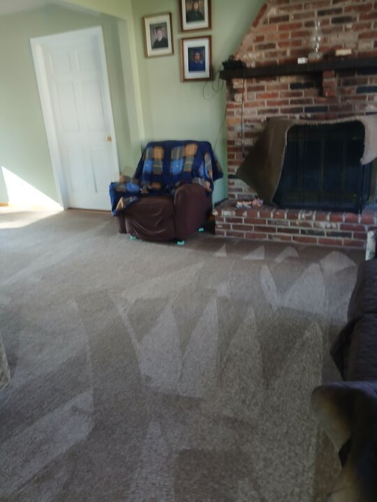

Did this job today. 2 bedrooms Hall Living Room Dining Room
Used 3 gallons of water and 8 oz Encap-Punch per gallon
Carpet will be dry 1-2 hours
Vacuum - Kirby Avalir 2
Detergent - WORX Sprayer 8002 Teejet Encap Punch at 8 oz
Scrub - 14'' Brush Master Pro 35 CRB - Grey Brushes
Extract - TOPS Odyssey - Thin Microfiber Bonnets
Groom - 10'' CRB - Grey Brushes
Bottom picture is with swirl marks from Odyssey before it gets groomed

Looks good for what it is, but calling that “extraction” is doing a lot of heavy lifting.
Two bedrooms, hall, living, dining on 3 gallons total isn’t flushing soil, it’s lightly dampening fibers and moving stuff around. True extraction is about rinsing and removing suspended soil, not just scrubbing in encap and wiping the tips with a bonnet.
VLM absolutely has its place, maintenance on CGD, interim cleans, etc., but using it as your only method on residential and comparing it to HWE is like using dry shampoo and calling it a shower.
I always chuckle when VLM guys use terminology like “extract.” Smear, disperse, or hide would be a lot more honest. 😄
