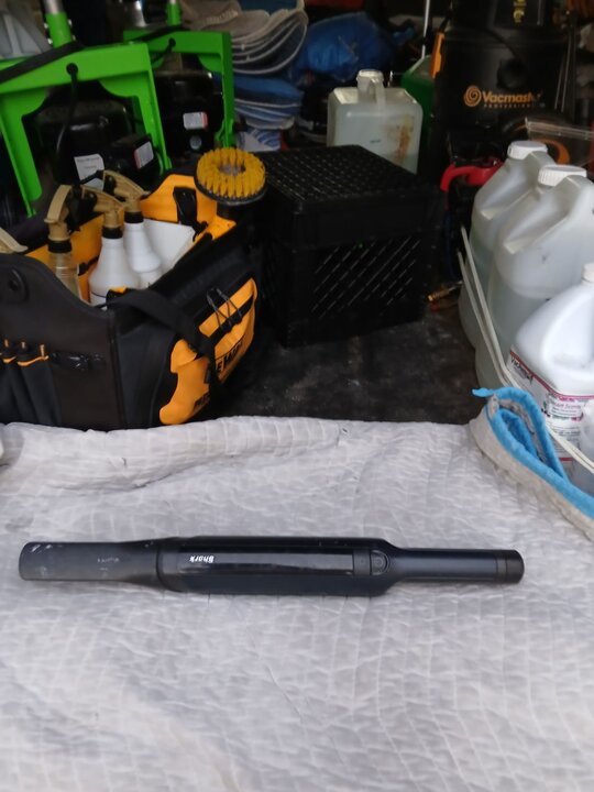

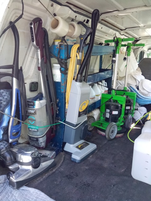

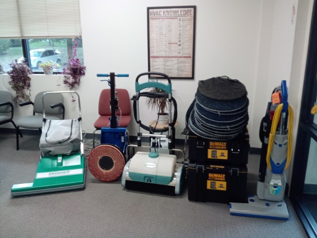

I always have 3 vacuums on my Van for Residential and a Handheld for stairs and a Handheld for crevices when using Kirby. Shark Kirby 12'' Pro Team Eureka Handheld Shark Handheld. Last week my Kirby belt broke. No problem I have 2 backups. That Shark Handheld is a handy tool to have. Fits in my spotter bag and has good suction for a little vacuum
Usually 2 for Commercial a 20'' Linhaus and 15'' Pro Team
And when needed I bring Big Green. A 28'' Bissell Big Area Vacuum. I love Big Green for long Hallways Conference Rooms big Offices

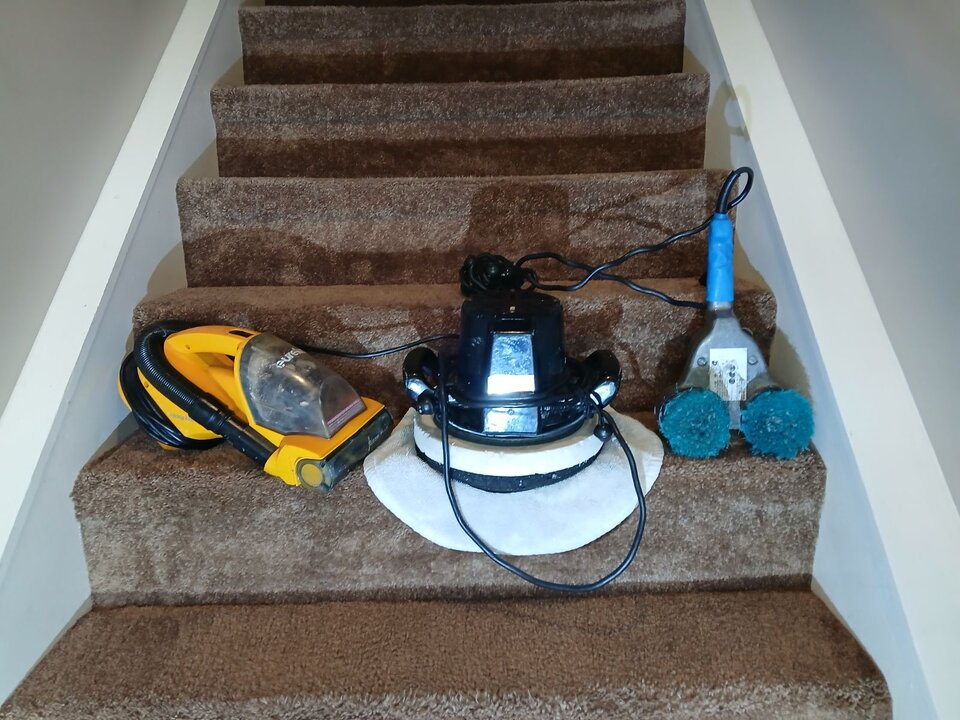

It'll be hard to beat Hydrox and Tops for that.
I've been using Hydrox ( Yes on Residential ) more and more on lightly soiled Residential nylon and getting excellent results
And I'm using Hydrox on some lightly soiled furniture with the VLM Method
It has a light clean fragrance needed for Residential
LESS water MORE agitation !!!

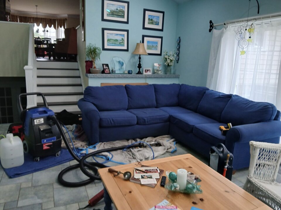

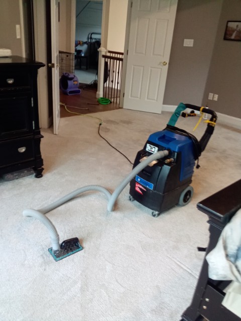

I should mention I do have a portable for flushing out urine stains/spots with a Water Claw. I charge extra that and some furniture with loose fitting fabrics are very hard to clean using the VLM Method
View attachment 132937View attachment 132938
Im glad you bring in a machine to properly flush out those nasties. I respect you a little more now. I always thought you just buffed those spots
