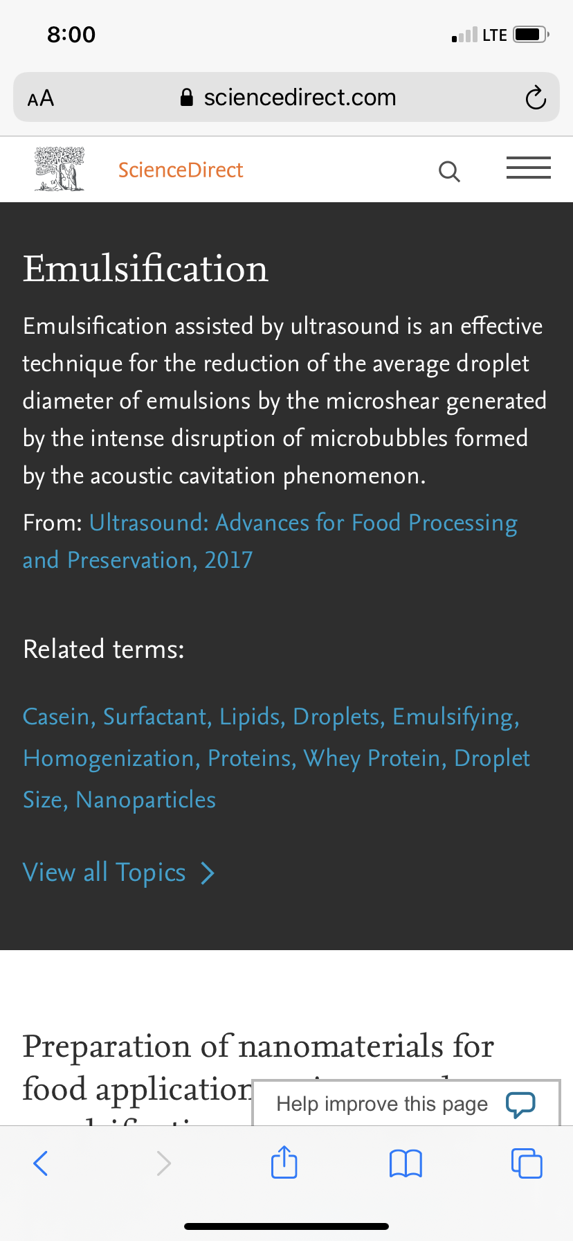

Have another cup of Joe, and lets hear your thoughts on quantum physics and how it relates to emulsification

wrap your morning brain around this one fellas.... F3721207-E864-407F-817D-621957A77F3E.png
