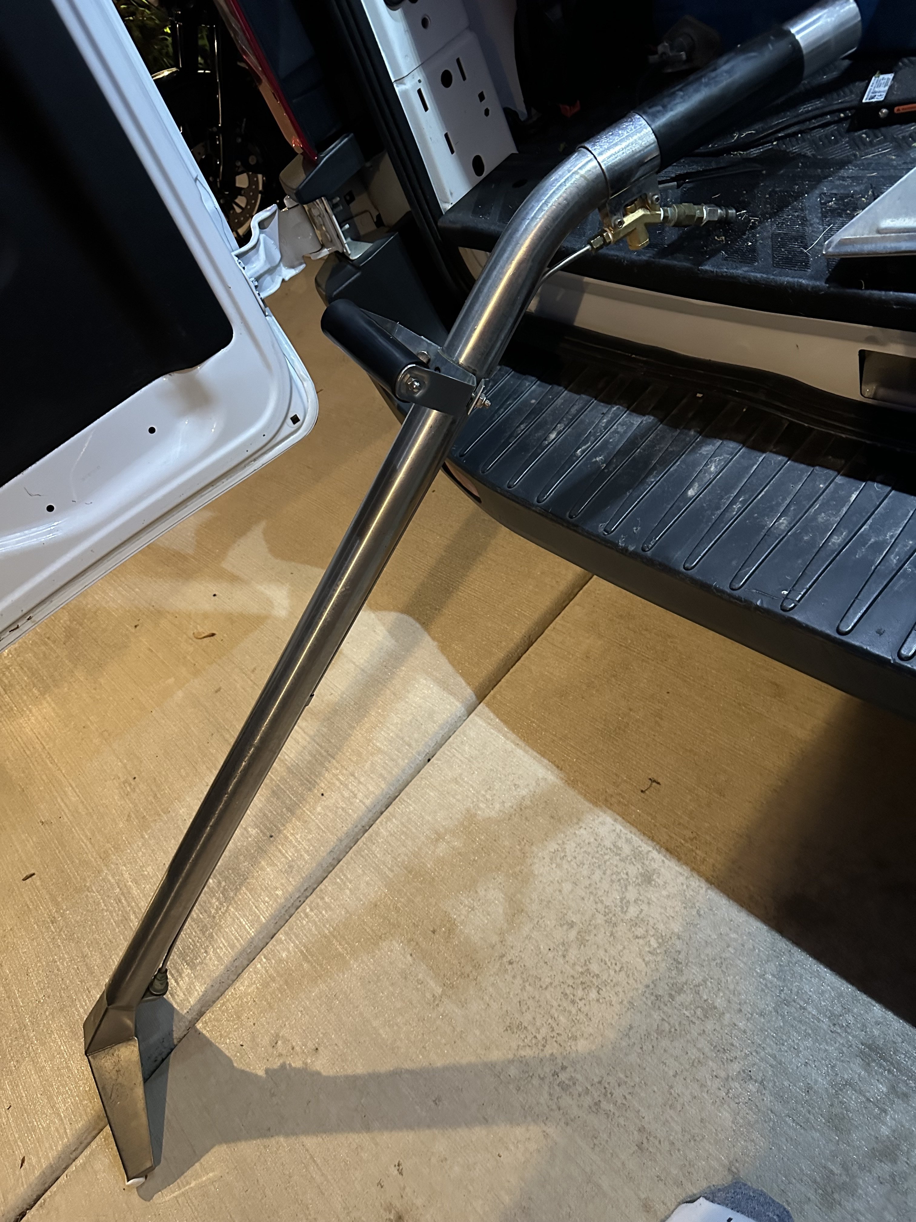

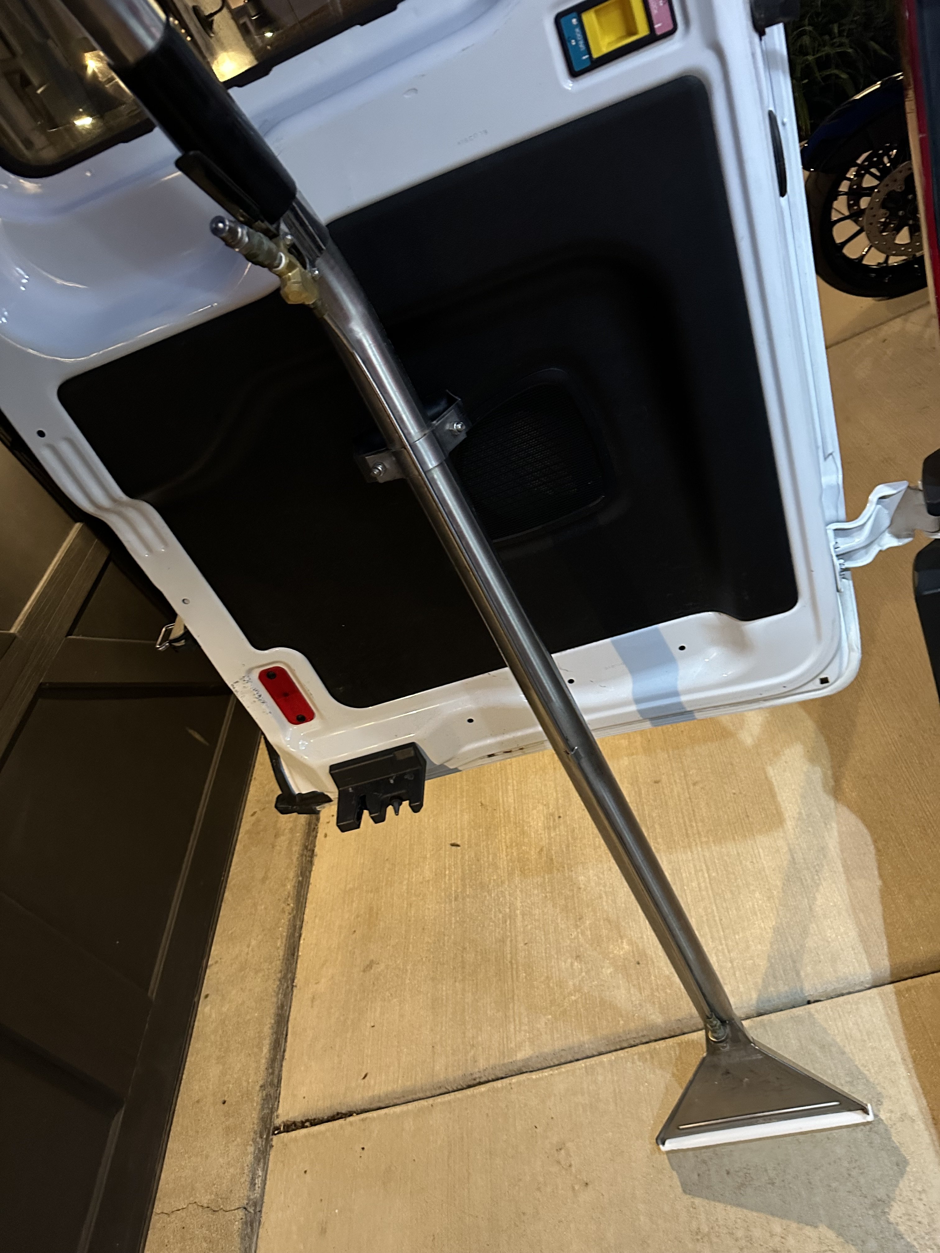

A full 2" Hoe?
Pics please
Greenie ordered it for me back in the day. I also have a 10 inch Prochem wand (I believe) that I bought from Brevick that is awesome for cleaning area rugs, no glide needed.

Why? Is it because 01 jets get clogged often?
What has more impact and flushing ability, four 01 jets or two o2 jets?
Many carpet cleaners/humans, can't wrap their mind around this (simple) concept untill they try, see and feel the difference.
Hook at a four jet wand set to 4 flow and run your hand throught the spray at 400 psi, now do the same with a two jet wand. You may need to use the back of your hand, which is more sensitive, to feel the diffferance in IMPACT.
View: https://www.youtube.com/watch?v=j7YH2ZRFmiQ&t=26s
Ive sold a LOT of these Chosen wands and all customers say the same thing, "I can't beleive at how well and evenly it cleans/flushes, and the dry times are incredible."
and then they comment on how easy it is their body, how manuvable it is and how well it gets under things...
If it were jusst my findings I wouldnt say much, but the masses agree...

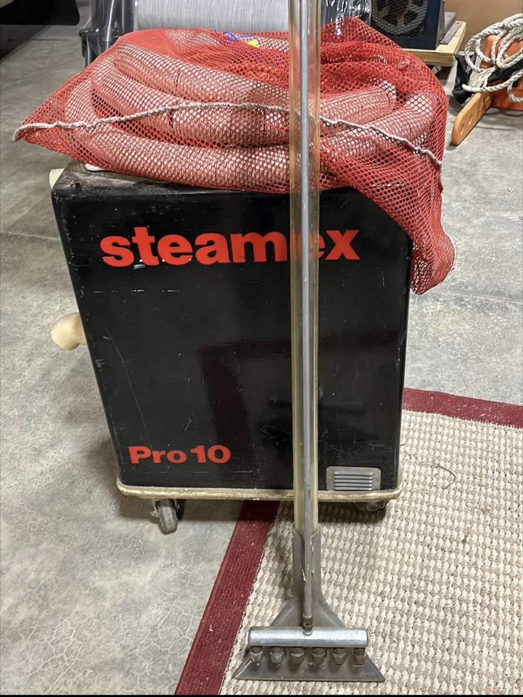

If you match the flow with the vacs or blower then over wetting not a problem. The steemex in the picture is the same as the one that came with the purchase in 81 with a propane tank that leaked. Junked both of them . Purchased a Hoover 20 gallon extracter. then a ninja. Finally White Magic. But that was then just sliding along now 43 yrs later everything is for sale in sunny Florida YEA time to RETIRE. jz
