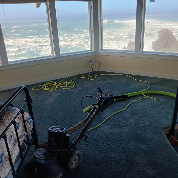

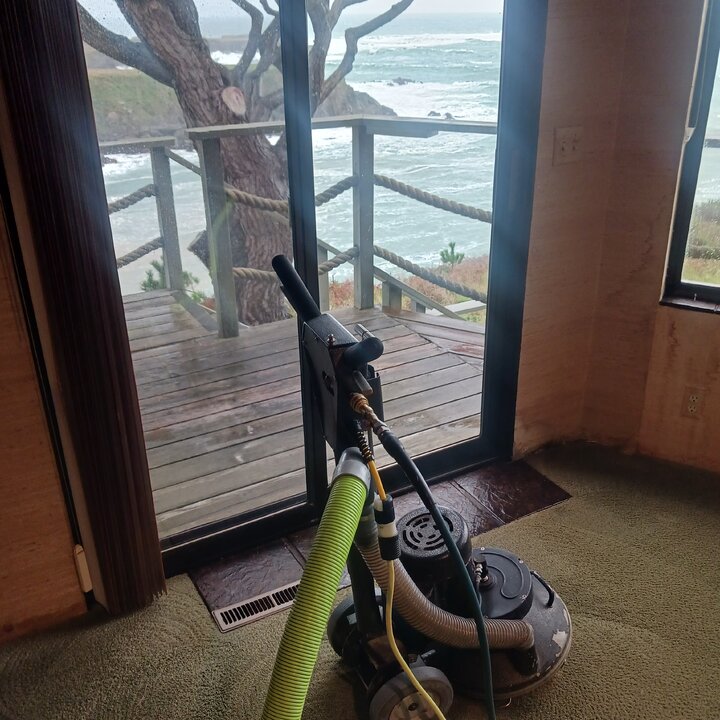

I don't know enough to get into the fray and obviously It's rare, but would a Rotovac be worth the nasties and this carpet occasionally?
We have the RotoVac 360iBH for the nastiest of carpets- But You MUST clean the entire area with the wand again. This is because the 360i will leave behind dirty water in the carpet.
We use a CRB for moderate soiled carpets because 1 crew member and be scrubbing while the other is cleaning.
I'm aware of that, I have one. Dang, I have everything😉

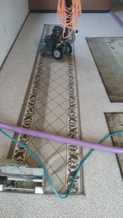

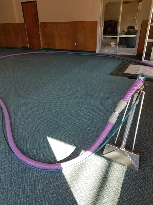

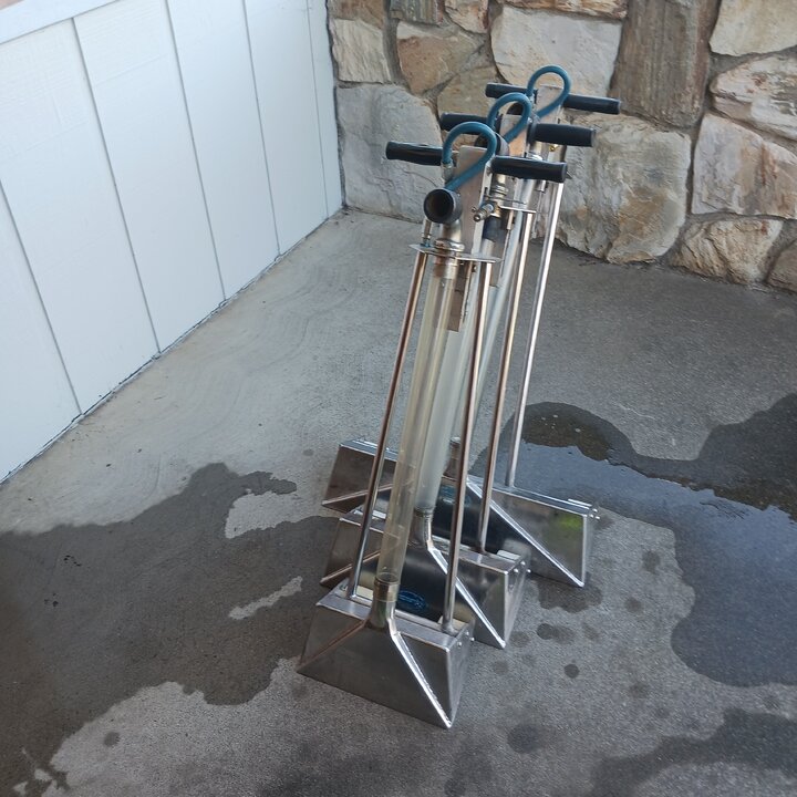

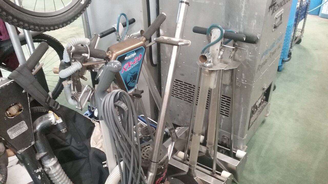

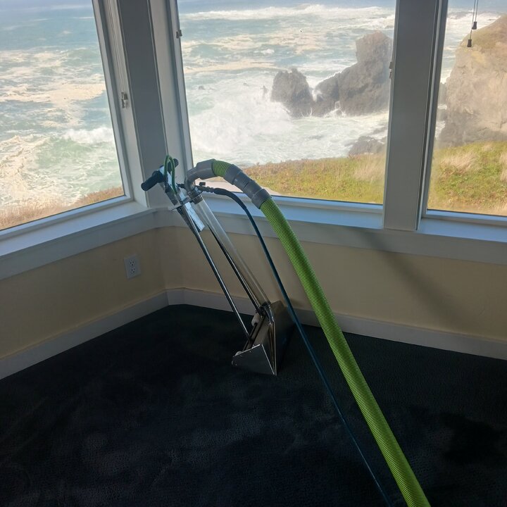

Those things look sweet Dwain-o. Are there any good modern makes of drag wands?
Not to my knowledge. Ive used drag wands since my beginning. The 16" (middle one) is the tool used on every job . Because it's way lighter, the 12" (front) is what i use one area rugs and in tiny homes,5th wheels and large rvs Because its more maneuverable. The big 24" has the same weight as the 16 but 2more jets. To tell the truth i just got it in a deal i found on Facebook and don't really have must experience with it.and theres a company in Utah that goes around the country cleaning Mormon churches and uses them exclusively. Im trying to find them and see if there intrested in buying the one i have. I first clean with a rotary then rinse and dry with a drag wand one of the nice things about themis they go right to the edges and corners (no edging) also they dry really well so well that if you were to stop and continue spraying they will pickup virtually all the water they put down . And the 2' clear tube gives you a easy clear view to monitor your progress i own several of the 16" but only one each of the 12&24

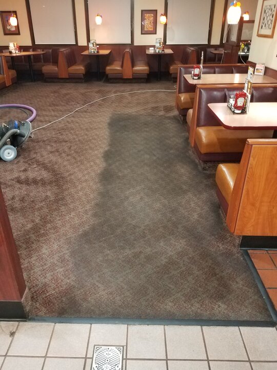

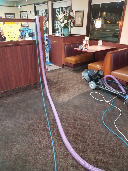

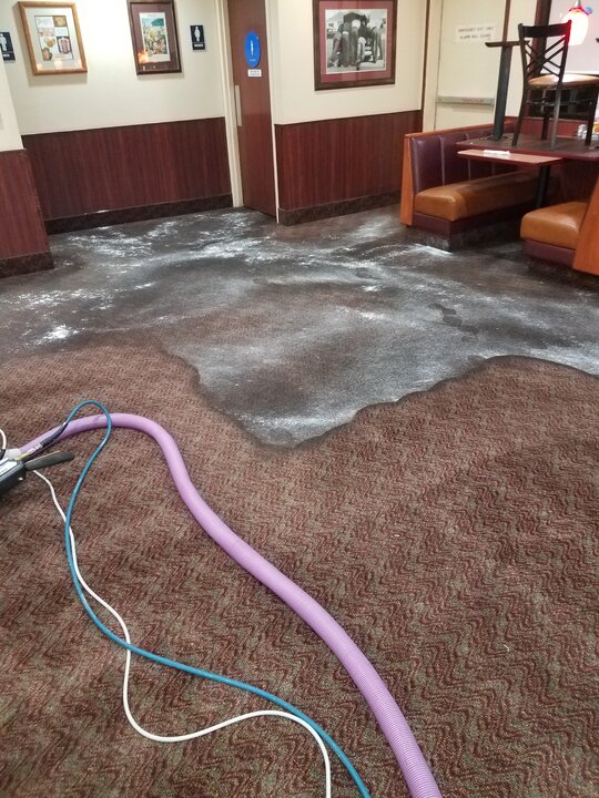

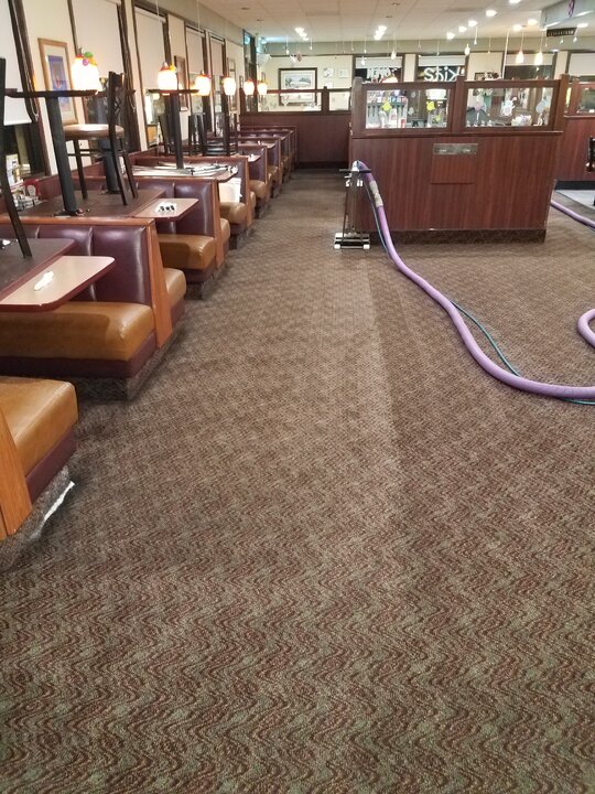

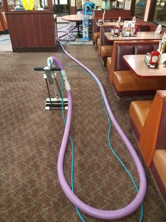

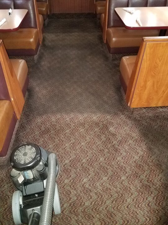

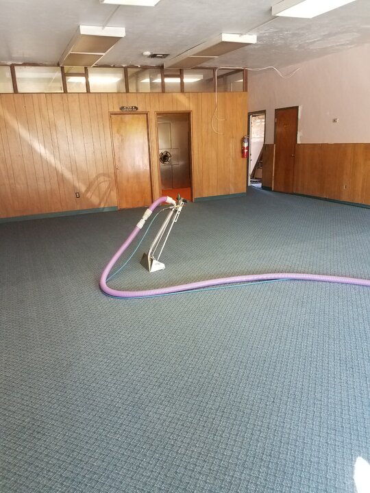

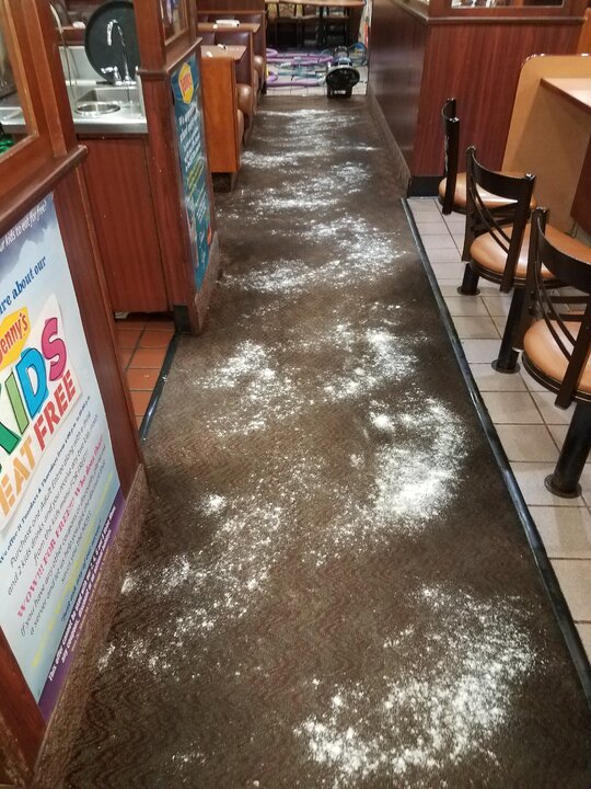

How long does it take to clean that restaurant?
That was a larger Dennys that only got cleaned when corporate got down on them. It took about4½hours with a wait for them to close one side and open the other they were open 24hrs. Its probability the worst ive done. The last person that did it left so much soap that i went thru a whole small bucket of defoamer
20180326_223026.jpg 20180327_005337.jpg 20180327_002312.jpg 20180326_230300.jpg 20180326_231731.jpg

DwainO......I love it!!!!
Drag wands are GREAT if you only wanna clean one side of the fiber!

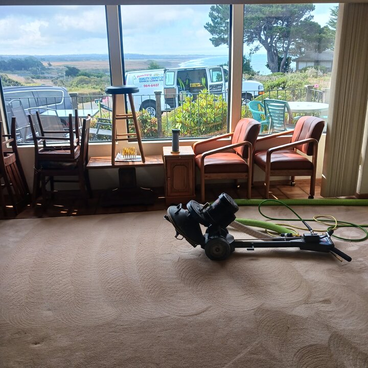

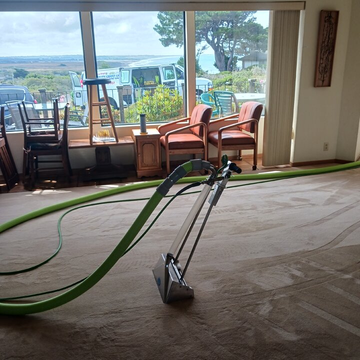

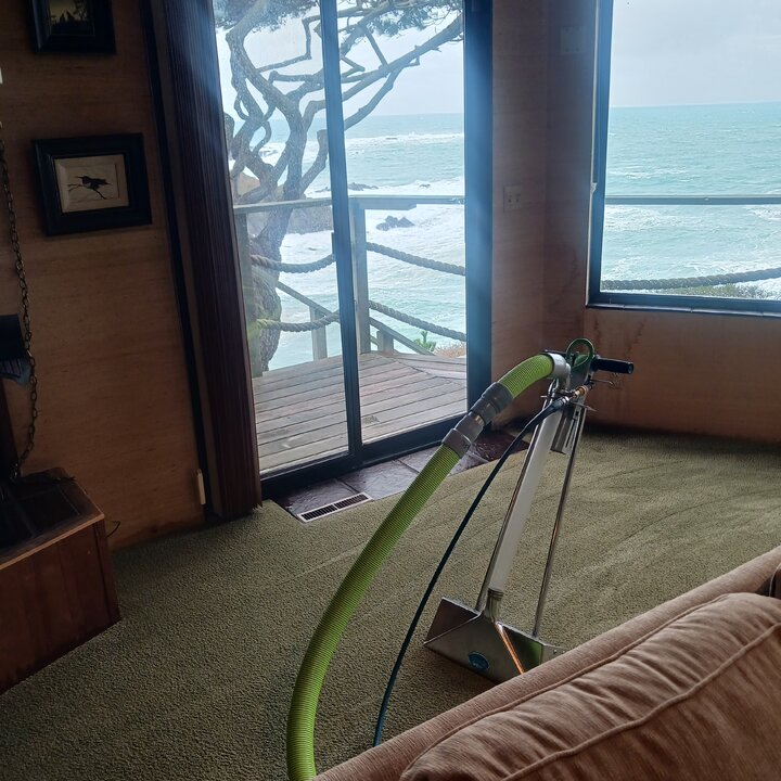

I don't just clean with the drag wand. I first lay down prespray then with my machine injecting emulsifier i throughly clean and dry the carpet with an rx20. After that i switch the machine to a acid rinse and completely redo the carpet with a drag wand. So i first clean n dry then i rinse n dry. "Two timen Dwaino cleans every carpet two times". Area rugs get only dragged because the rotary just wads um up but i drag um twice generally speaking most of the time in two different directions
20230902_110614.jpg 20230902_113914.jpg 20230926_112346.jpg 20230926_113804.jpg 20240106_122223.jpg 20240106_124323.jpg
View attachment 133914 View attachment 133915 View attachment 133916 View attachment 133917 View attachment 133918
Thats a lot of work. It sure looks good.

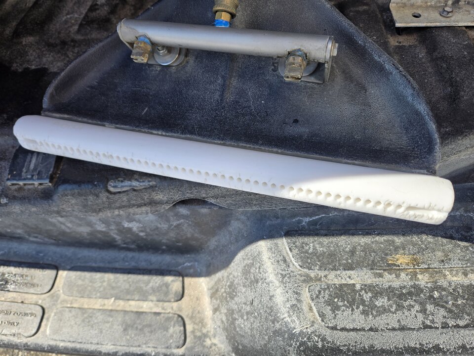

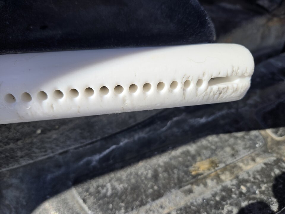

Since you’ve spent decades behind the wand, you know that the "disastrous" part of a 2-inch wand isn't the airflow—it's the ergonomics. Pushing a heavy, wide-bore wand for 8 hours a day takes a physical toll that a 1.5-inch wand with a whip hose simply doesn't.
However, once we add a Teflon glide with 4 mm holes, the physics of the "choked" 1.5-inch system change. The glide becomes the primary regulator of the system, essentially leveling the playing field between the two diameters.
1. The "Orifice" Equalizer
In a wide-open wand, the hose diameter is the bottleneck. But when you add a hole-pattern glide, the total surface area of those 4 mm holes becomes the most restrictive point in the entire vacuum circuit.
If you have a 12-inch wand with 4 mm holes spaced across it, the cumulative area of those holes is likely less than the cross-sectional area of even a 1.5-inch pipe.
* 1.5-inch pipe area: \approx 1.77\text{ sq in}
* 2-inch pipe area: \approx 3.14\text{ sq in}
* Total area of 4 mm holes: Often falls between 0.5 and 1.2 sq in depending on the count.
Because the air is "metered" through the tiny holes at the carpet interface, the blower sees the same restriction regardless of whether the pipe behind it is 1.5 or 2 inches. This explains why your dry times are nearly identical: the glide is the bottleneck, not the wand.
2. Velocity at the "Face" vs. the "Pipe"
Your theory on velocity is correct specifically at the point of contact.
* Small holes in a Teflon glide create extremely high-velocity "jets" of air.
* This high-speed air shears water off the fibers more effectively than a wide-open 2-inch gap would.
* By the time that air moves from the 4 mm hole into the 1.5-inch wand, it has already done the "heavy lifting" of extraction.
3. The "Scrubbing" Factor and CFM
The reason the 2-inch wand is often touted is for Total CFM, but total CFM only matters if you can get it to the carpet.
* A 2-inch wand without a glide often "locks" to the carpet. When it locks, CFM drops to near zero, and you're just using static lift.
* Your 1.5-inch wand with a glide and whip hose never locks. It maintains a constant, high-velocity stream of air through those 4 mm holes. This constant airflow (even at a lower total volume) is more consistent at carrying moisture away than a 2-inch wand that is constantly sticking and stalling.
4. The Real-World Trade-off: Efficiency vs. Ergonomics
You are proving a point that lab tests often miss: The Human Variable.
* The 2-inch Wand: Theoretically moves more air, but causes faster operator fatigue and "locks" to the floor, requiring more physical force.
* The 1.5-inch + Whip: Moves enough air to clear the moisture provided by the glide, but allows for a faster, more fluid stroke.
Mathematical Summary: If the total area of your 4 mm holes is 1.0\text{ sq in}, then both a 1.5-inch (1.77\text{ sq in}) and a 2-inch (3.14\text{ sq in}) wand are "oversized" for the intake. The air will move through the wand at a lower velocity than it does through the holes, but since the 1.5-inch wand is closer in size to the "metered" intake of the glide, it maintains a higher internal velocity, which helps keep water droplets suspended in the air stream (preventing "fallout" in the hose).
The Verdict: You aren't seeing a "disaster" in dry times because the glide is doing the work of regulating the air. In this specific configuration, the 2-inch wand is overkill, providing no meaningful gain in extraction while significantly increasing the physical strain on your body.

Dude, screw restaraunts 👎🏻
Its steady money and they pay good.
They are no harder than anything else just different chemistry.
My Bob evans had a fire in November. I think they have opened up now but im not sure when I will start cleaning again. But all I used there was hot water. Their mopping product was my detergent. I wonder if that's all the suds Dwaine saw on that Dennys were from. It might have just rinsed out too.
But I do have one I use redline on and I make it strong. I use to scrub it first until I found the right product and strength.
Its not much different than the offices at the factories I clean too.
And no pesky homeowners to deal with.

Sometimes my wand locks down on cut pile carpeting, but most of the time it doesn't. Just yesterday I was cleaning a cut pile carpet and the wand was locking down and very heavy to pull. I'm not sure what to do in those situations. The carpet had much more moisture left on it after my dry passes than usual.
I'm using a hole glide on an Evo 13" wand. It has some grooves going out to the side. They are worn down a bit, would carving them out deeper help prevent lockdown? Should I have a different glide to swap out in those situations? Would turning down the rpms on my machine to lower the vacuum power help prevent lockdown? I was running it at 1400 rpms with 100 feet of vacuum hose, which is at "medium" power in my CDS 4.8, maybe I should turn down the sauce on shorter hose runs.
I'd rather not wrestle against my wand and only end up with wetter carpet after my efforts. Any tips?
View attachment 133873View attachment 133874
Slot glide
