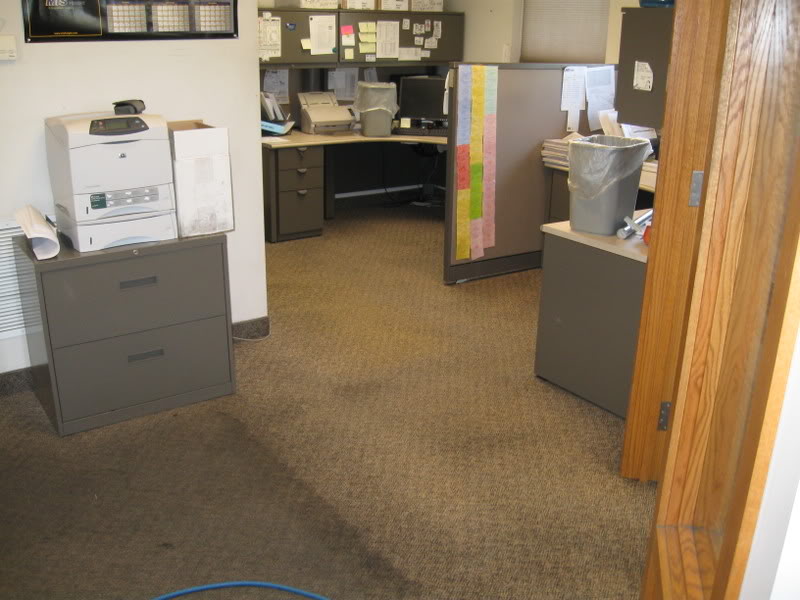

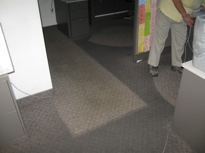

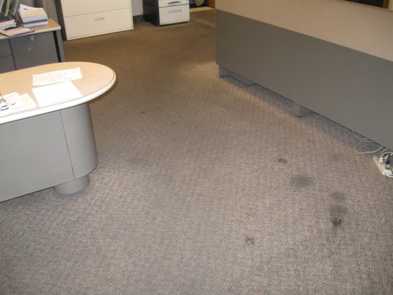

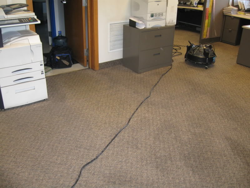

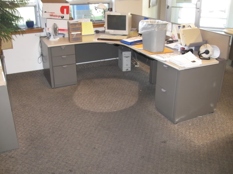

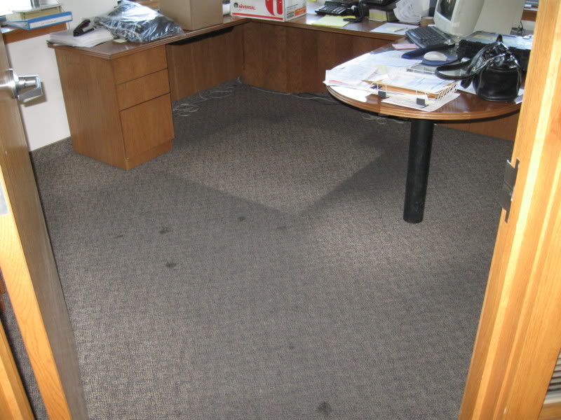

What could I have done better?
B
B&BGaryC

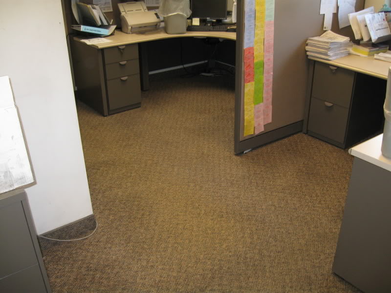

I cleaned a freight company office today. HWE with 220-240 ATM... Greenhorn wand ten flow, bumped the pressure up to 500 PSI. Used a strong solution of bridgepoint Zone perfect mixed with citrus solve. I used Power-Point in my head-cap jug metered around 4 or 6 gal/hour.

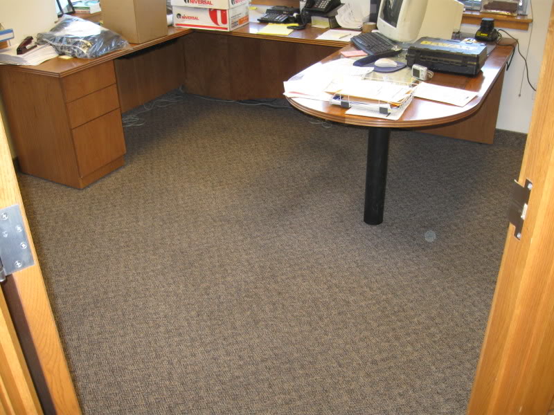

I pre-scrubbed with an adsorbent pad and post padded with cotton. You can still see where the mats were. Is there something I am missing?
And yes, that's my helper in the before pic...
I don't really know what I was thinking with the last two pics. I didn't keep track of my before and afters too well...
Anyway, lemmenowhachathinkin...
117,380
Try pre scrubbing with a Red pad next time and trigger spraying some Encap and 30 vol along with your post padding, but once a carpet is that bad it will never be 100% again.
They should be thrilled with what you did.

First thing I don't get is why you're using Zone Perfect when you have carpet in that condition. If you're a bridgepoint man you should of at least been using traffic slam or flex, I probably would of pulled out power break myself though and mixed for heavy soil and applied it liberally 1 gal per 100-150 ft. You need to choose the right chemical for the job, and I'm one that leans towards going above what is recommended and let the chemical do the work. Boosting those with some citrus and some H2O2, roto scrubbing with a 175 with at least a white pad and rinsing with an emulsifier (which I think you did) would of done a lot better. Don't worry so much about carpet warranties when the carpet looks like that....the warranty is gone. So you're job is to get it as clean as possible and if the customer is worried about the protector you can sell it to them of course. In my opinion based on what you used I'd say you under cleaned that job. Now if you pulled out the big guns like I said above and got the same result I'd say you did your best so you need to make sure you are using the right tool for the job.
C
Curtis Pennington
Wow there is better chems but your procedure was right on....cant clean a shirt you havent washed in 8 years.

Yep, Powerburst(if you are a bridgepoint fan Power Break) and a red pad (I would have used a green, but you are not ready for that). I agree with the others, they should be pleased, that carpet was trashed. In an environment like that it is difficult to completely erase the outline of the mat as the fibers are significantly distorted from abrasion as the wheels roll off and on the mat. It just grinds the sand into the fiber and vacuums (if that place even has one) don't do well on the transition when/if their staff is vacuuming.

B&B I think you did pretty good actually, the only thing I would say is I would have run an olefin specific prespray, like prochems olefin preconditioner, or what I use is prochem renovate, I think they are the same product the first one is just diluted more for what you buy, you need something to break up the oils on carpets like that, and often your standard presprays for rez jobs just aint powerful enough

I like Ice Blue/Baby Blue burnishing pads for scrubbing/encapping. Stiff enought to shear the crap off the carpet & soft enough not to damage anything. No break in needed.
Any way, for mat lines like you have in the pics Releasit DS & Punch at 6 oz each per gallon & 2-3 oz of 30 volume will work wonders, as will Vac Away's Cyclone VLM & BP Solvent Clean. Whatever you use hit it with a scrubby pad & follow with cotton. Personally I like to OP with the pads & juice above... Works out nice. Oh yeah... Place fans as needed.

I agree with the red pad and if you have a cimex cut some little pads out of a big pad to fit the cimex, scrub the crap out of it, you can't hurt it
I would also go with the olefin product line from ProChem, I wouldn't use powerburst, scrup in the pretreat and rinse with the deep clean, you will never get all the dirt out of it with a one time cleaning but can over time with a every 3/4 month cleaning you will
make sure you tell them it is olefin and the enviroment it is installed in because it will look like crap in 3 months no matter what you do to it
