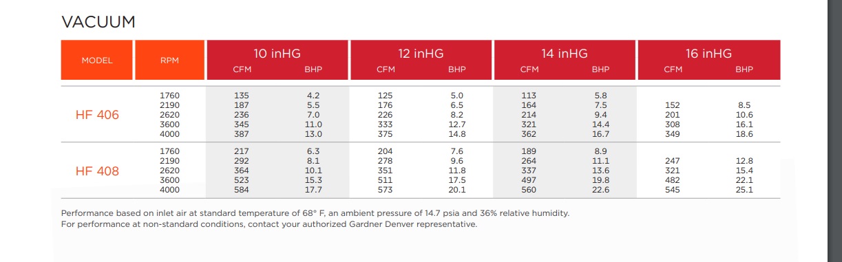

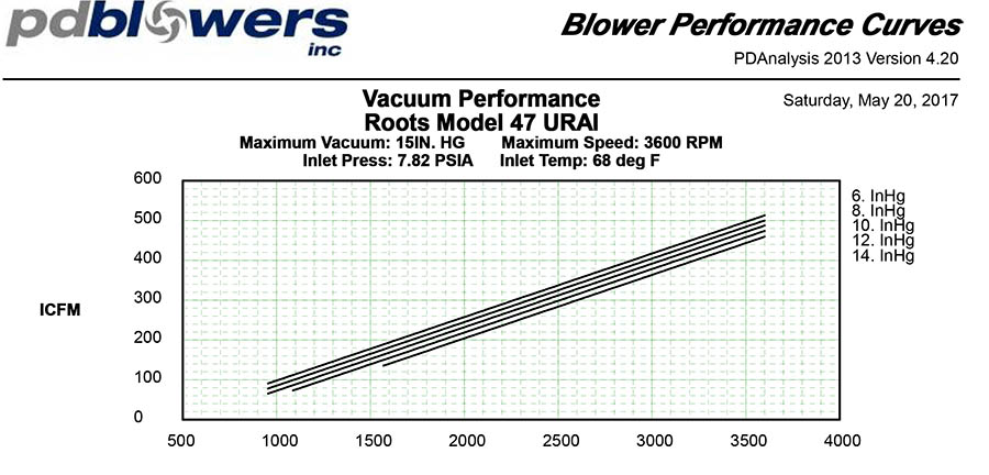

What blower is really needed for single wand cleaning at 100'-150'?
What blower is on the 570? I looked it up online and it said HF408. How would that compare to my 47 blower?

The Peak spins the 46 blower at 3000 rpm, so same exact vacuum performance as the 370 I guess.
