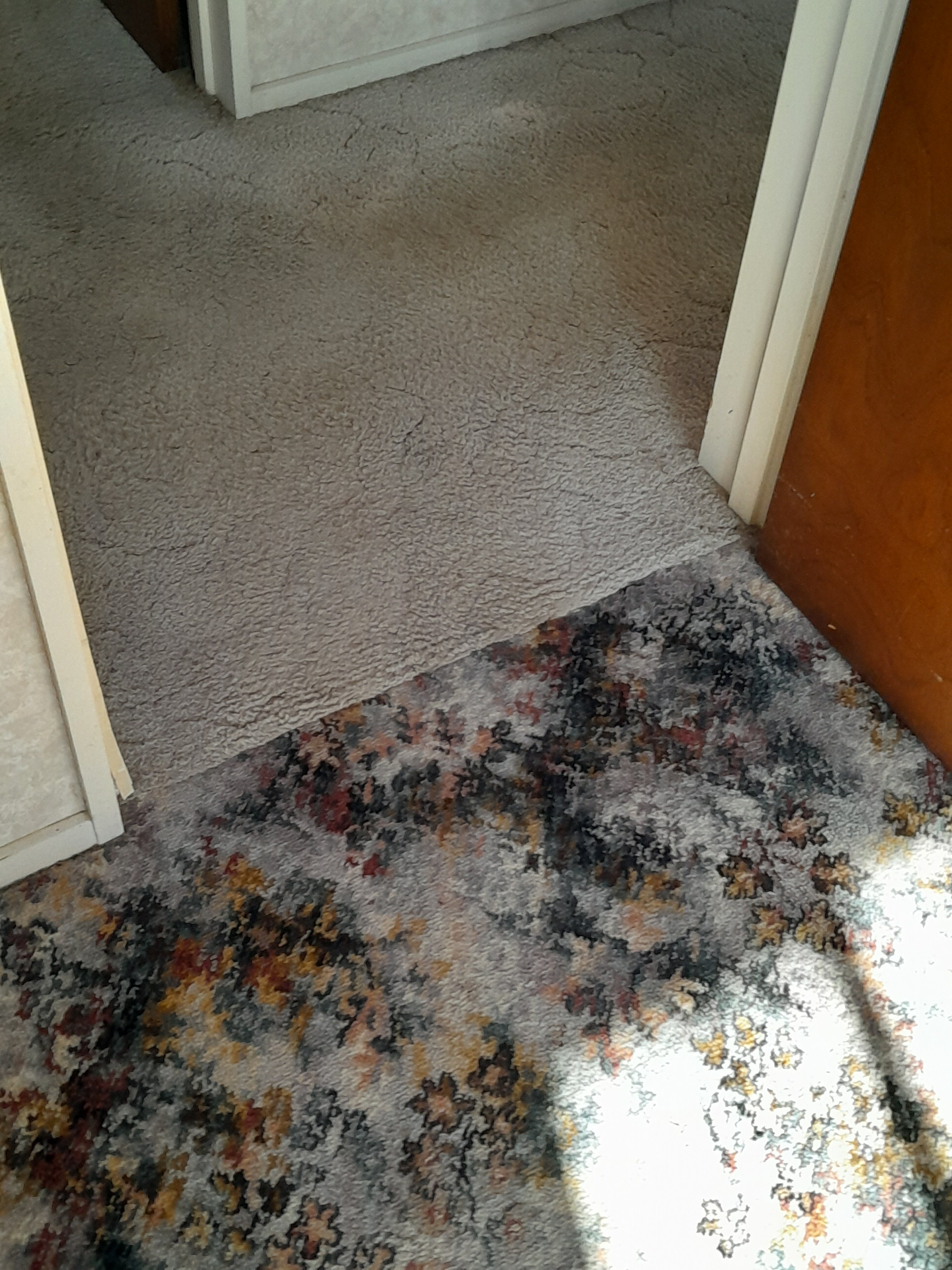

What are (all) the visual and tactile clues that a carpet is Polyester?
117,387
What clues do you use to determine Poly from Nylon, or Wool for that matter?
We use to be able to rely on the frizz/loose staple fibers but now that the mills have that under control, what clues do you use?
12,856
Guitar playing and working in service repair part time through my career here have calloused my fingertips to where I can tell by feel as much as I used to.
Synthetics used to feel more slippery, especially olefin and to an extent polyester. Wool felt more dry.
Now? I just snip a yarn and do the burn test.
I also can't smell as good as I used to, so I go by how the flame acts and the ash acts.
Polys? Black smoke. Hard plastic ash after it cools (AFTER IT COOLS!)
Nylon? White smoke, a little blue at the base of the flame if I can get a good look. Hard plastic ash. See above caution.
Wool? Self extinguishes. Ash crumbles.
And don't do it in the house. Collateral damage from flaming bit dropped by carelessness or pain are real risk.
14,646
Poly gives its image almost immediately after the first year by showing the matted down look (crushed fibers)
And nylon is good at showing pile distortion (wavy look of pile laying another direction)
And wool is so expensive, the customer will tell you before you step on it. Lol

Anytime the homeowner says "The carpet retailer says I have PET carpet and I got that because I have dogs"
11,571
Mostly not crush resistant, and pile reversal.
Olefin is usually cheap crap easy to spot.
Polyester untwist horribly in high traffic areas and heavy use areas.
11,571
I can honestly say that in my 15 years of hackery, carpet ID has never mattered.
The only reason it helps is setting the expectations of cleanability, and how close it will return to looking like new.
11,571
Nylon doesn't have reverse Nap or pooling like polys, and is crush resistant
14,646
I agree with nylon being crush resistant. But I've seen the pile reversal several times on older nylon heavy carpets
11,571
It happens, but polys are notoriously bad
