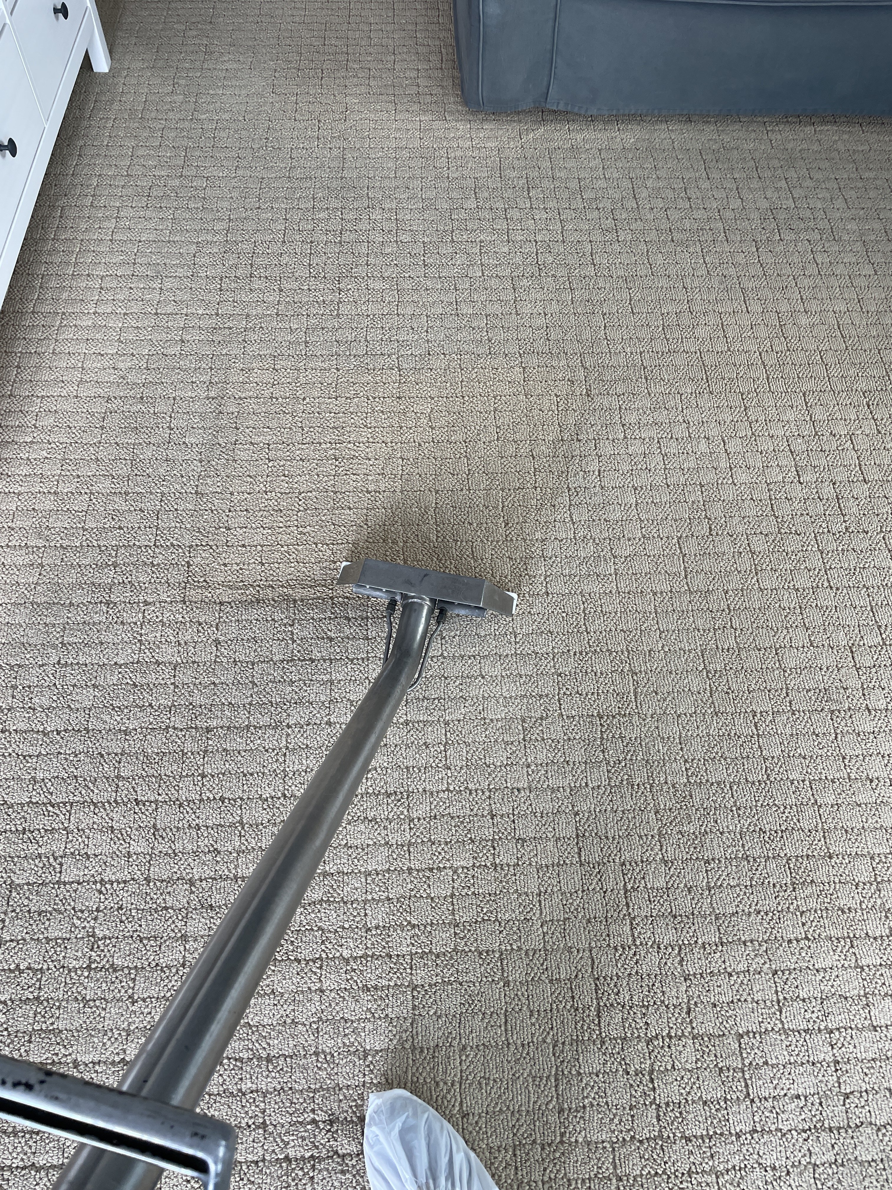

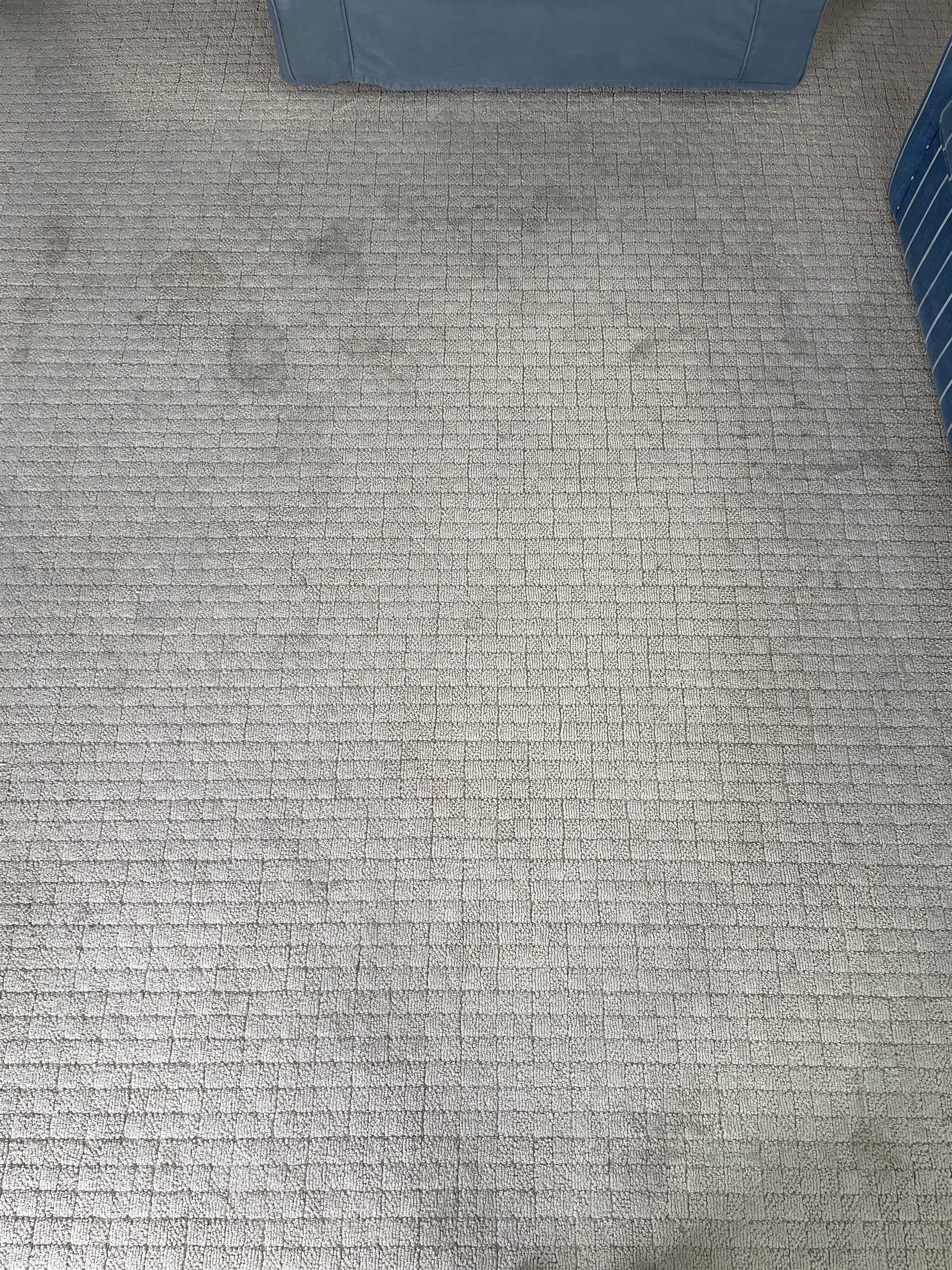

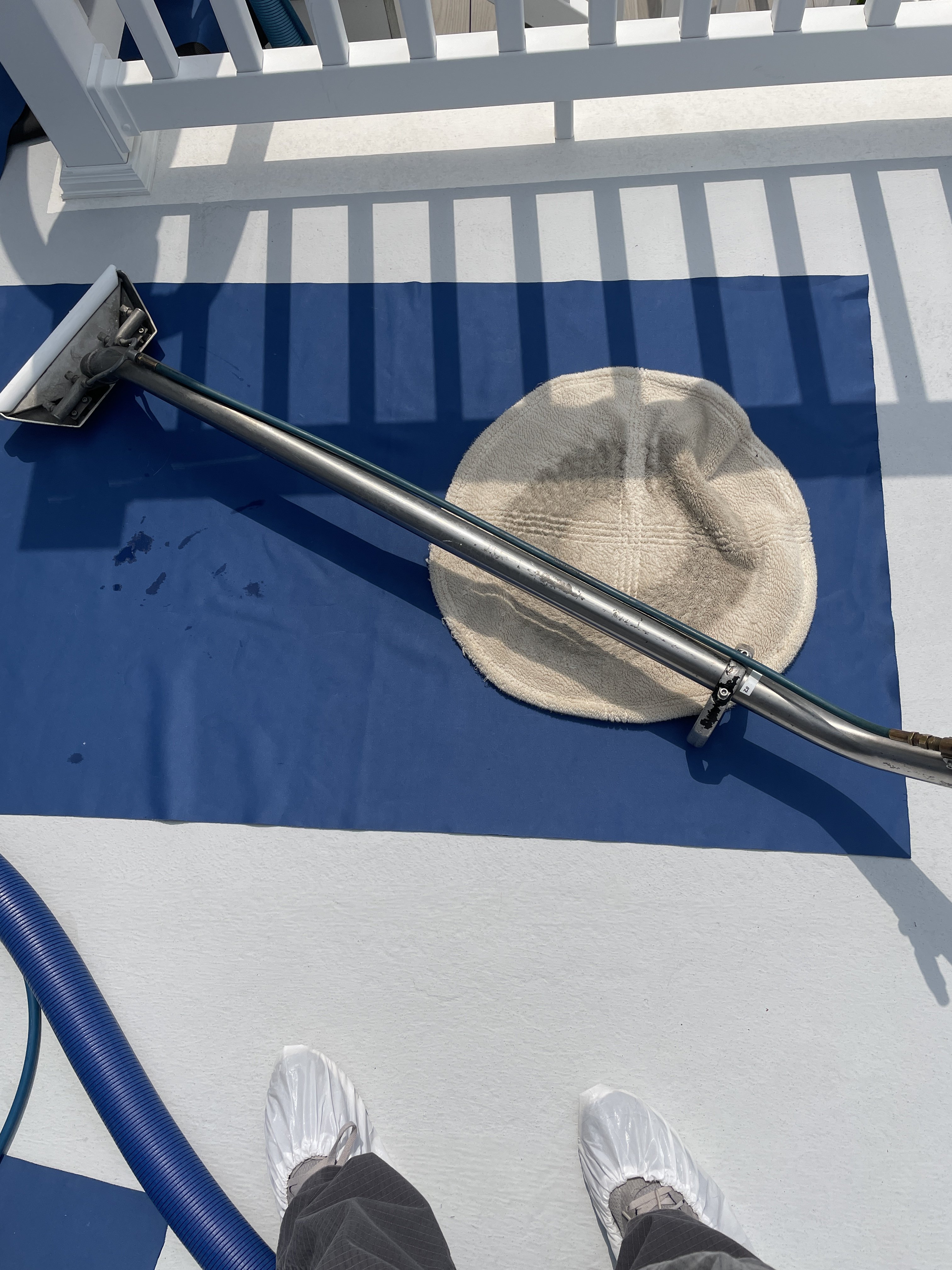

I sold a $300 touch up today for a customer that has a rental. I am gonna pad this in a month. I HWE today, but did a VLM in a demonstration today. I assured her, no more worries if her place needs a cleaning with a 2 hr window of changeover. Here is how it went
Before (I HWE under the couches, done)
After

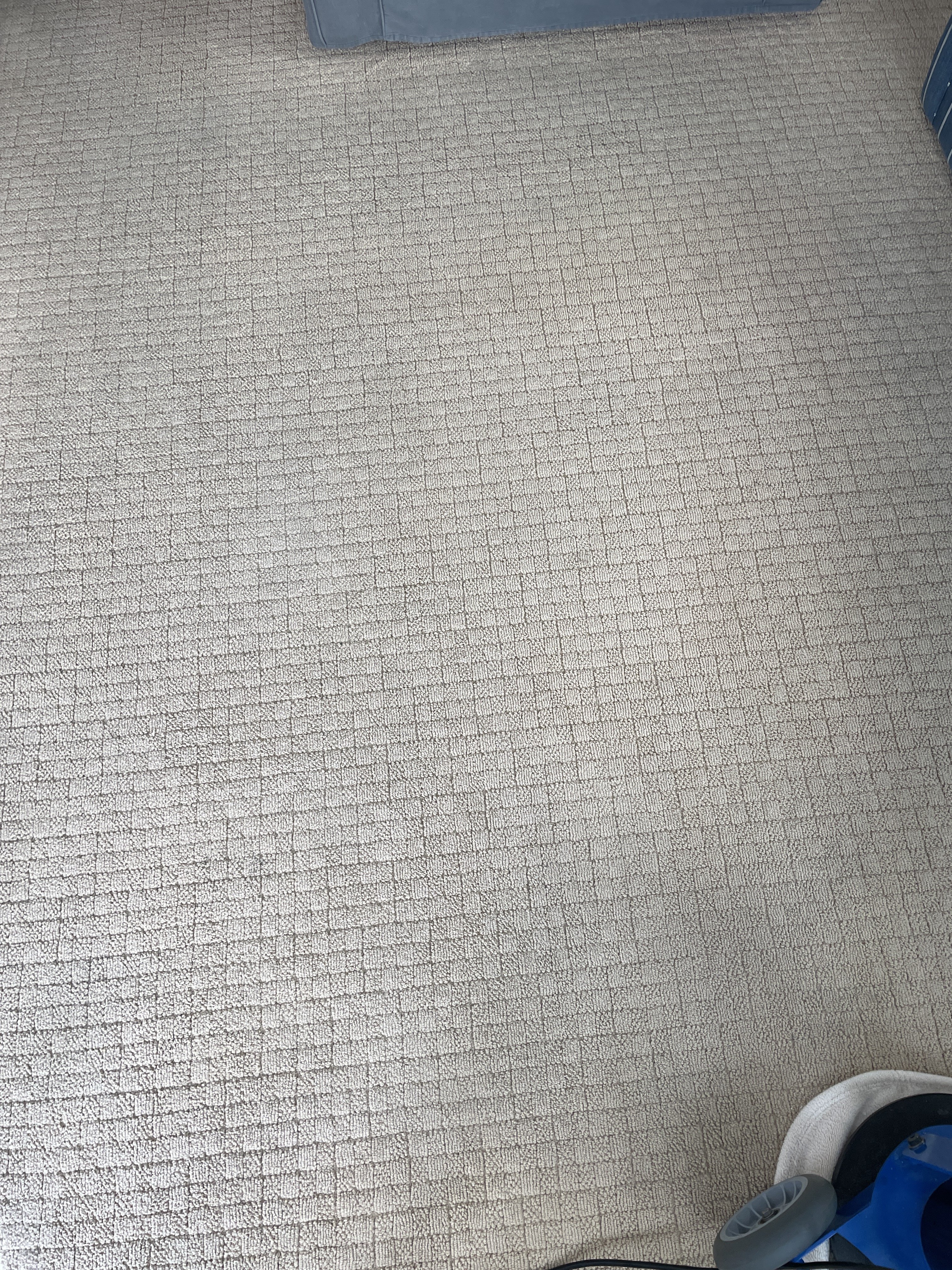

I did not do a good job padding, because I was set up for HWE already. I did this as a demo to show how I could put a band aid on it for the immediate time. I only sprayed a few ounces of Pad Cap Pro, NO dwell time, and was an instant no brainer for my customer t0 book a 30 minute appt in a month for $300. Win Win. She is so comforted now.

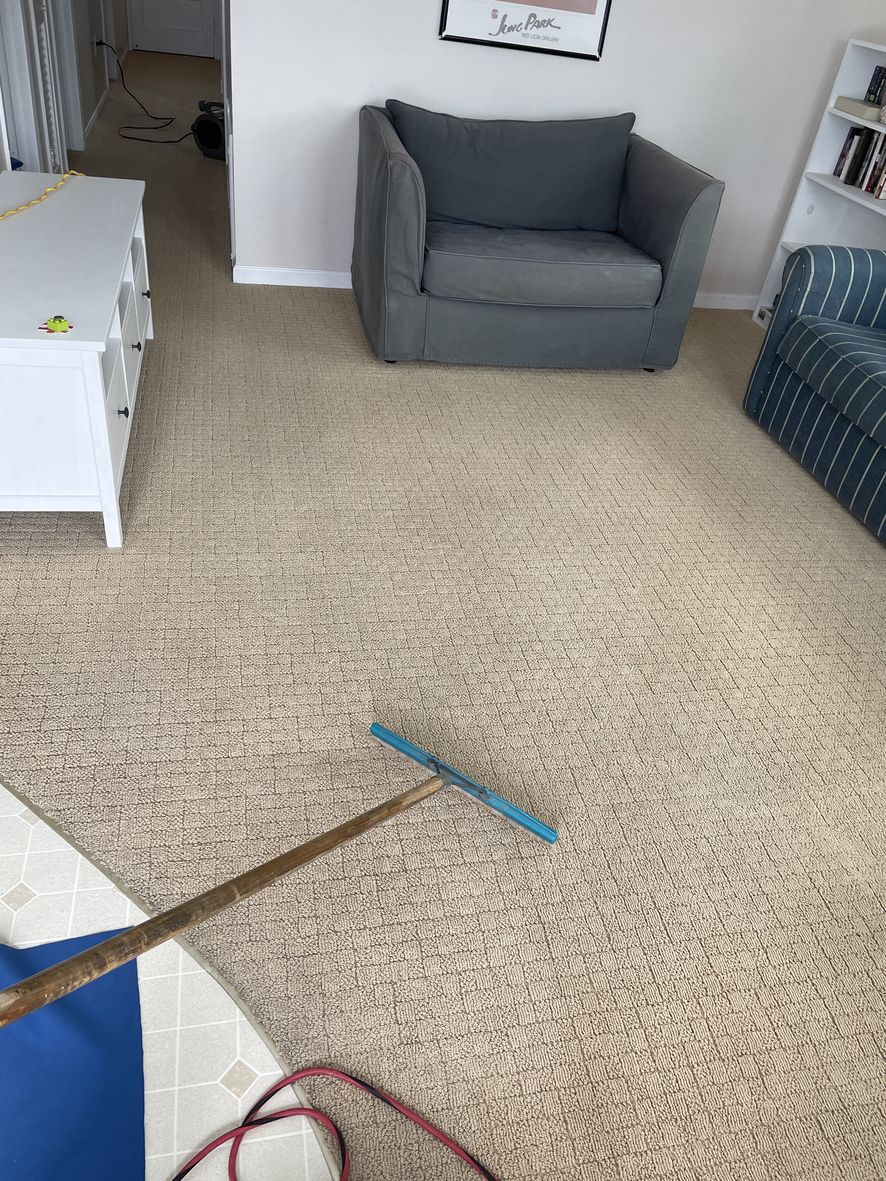

THEN I HWE after the hack pad job (the original work order. this pad was just a demo. Google cant sell for you like you can)
Fisnished
You can see the HWE did zing it, but if they knew I could have made it better without being as invasive and dry time restricted, they would have done this last season.
If I spent more time and more experience, I probably could have made them look great without hwe.

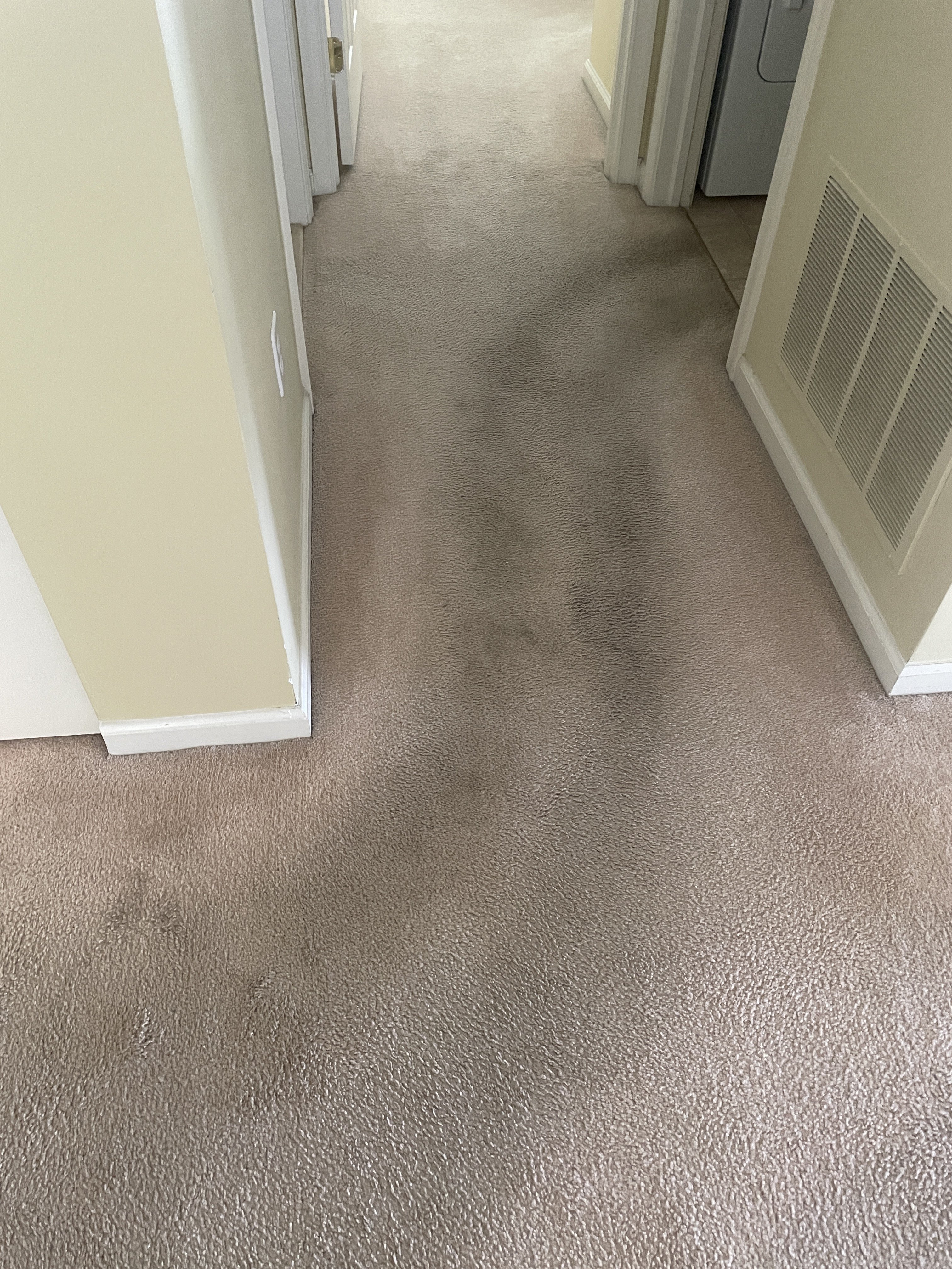

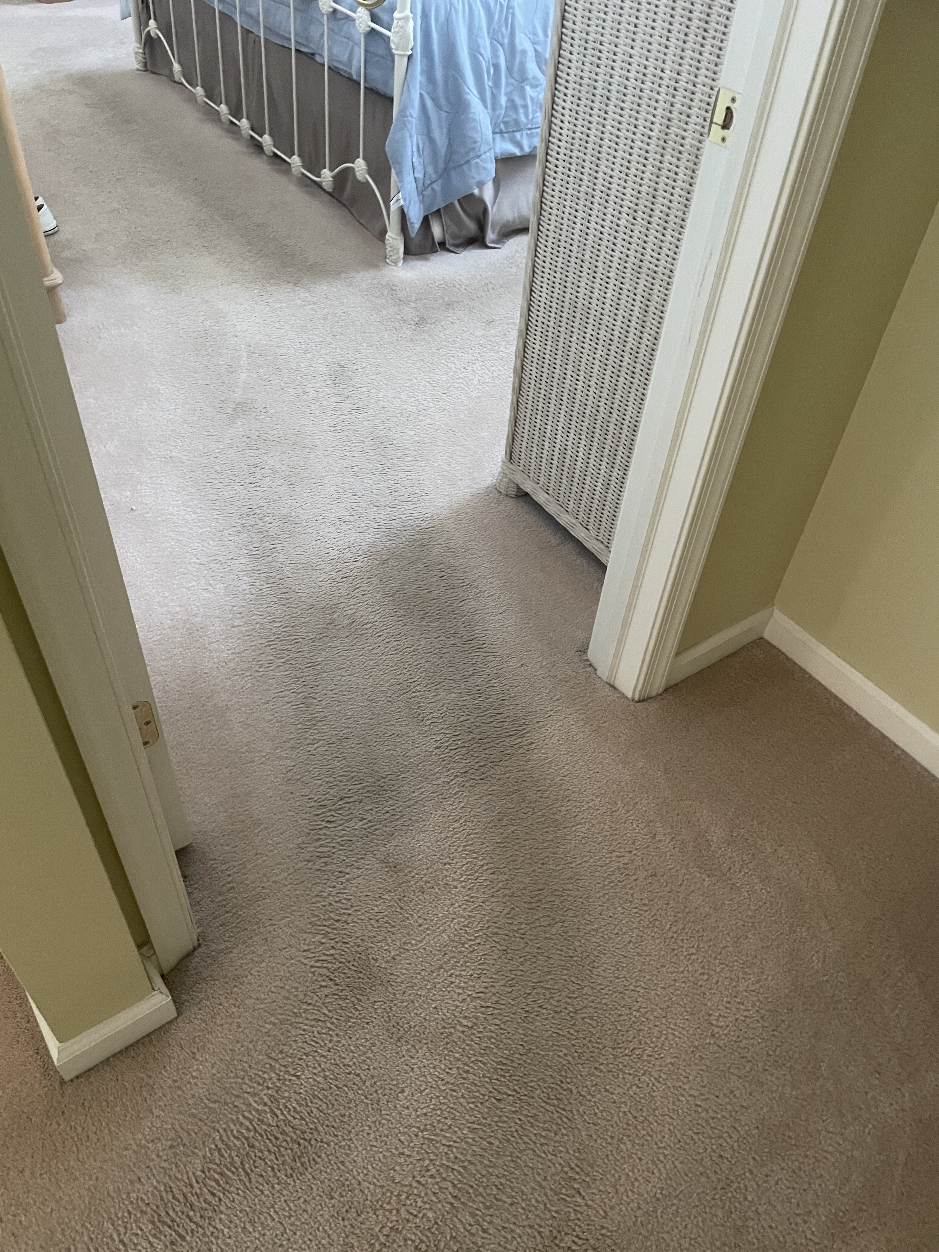

Thanks! These parrallell tracks are very common in 55+ communities. If I can "fix" them, it will be good. I will post the results.
The old shuffle marks.
Rubber sole shoes old retirees traveling the same paths shuffling.
It's one of the hardest things to break free.
The friction and rubber.
I tell people get different shoes or slippers.
The other thing is barefoot with lotion, that cleans up easier. just soils fast when the lotion oil up feet and walk.
Usually around the primary room around the bed.
