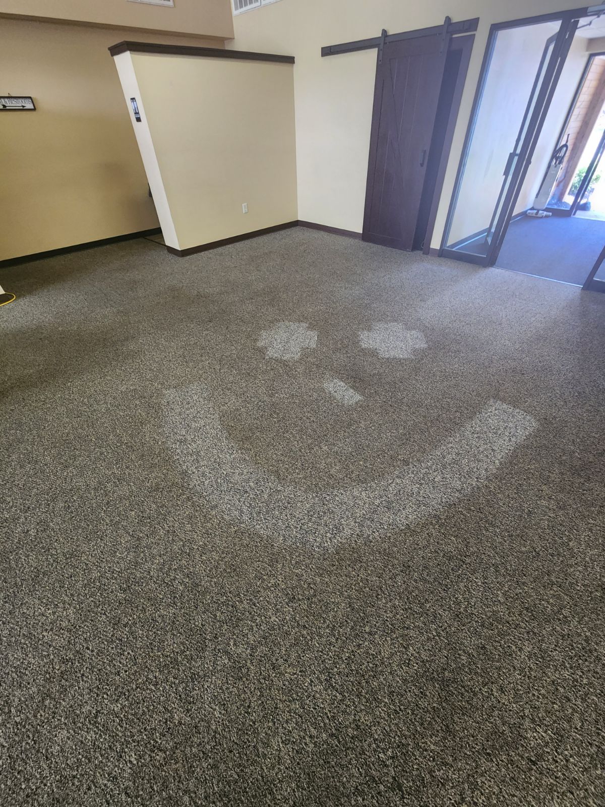

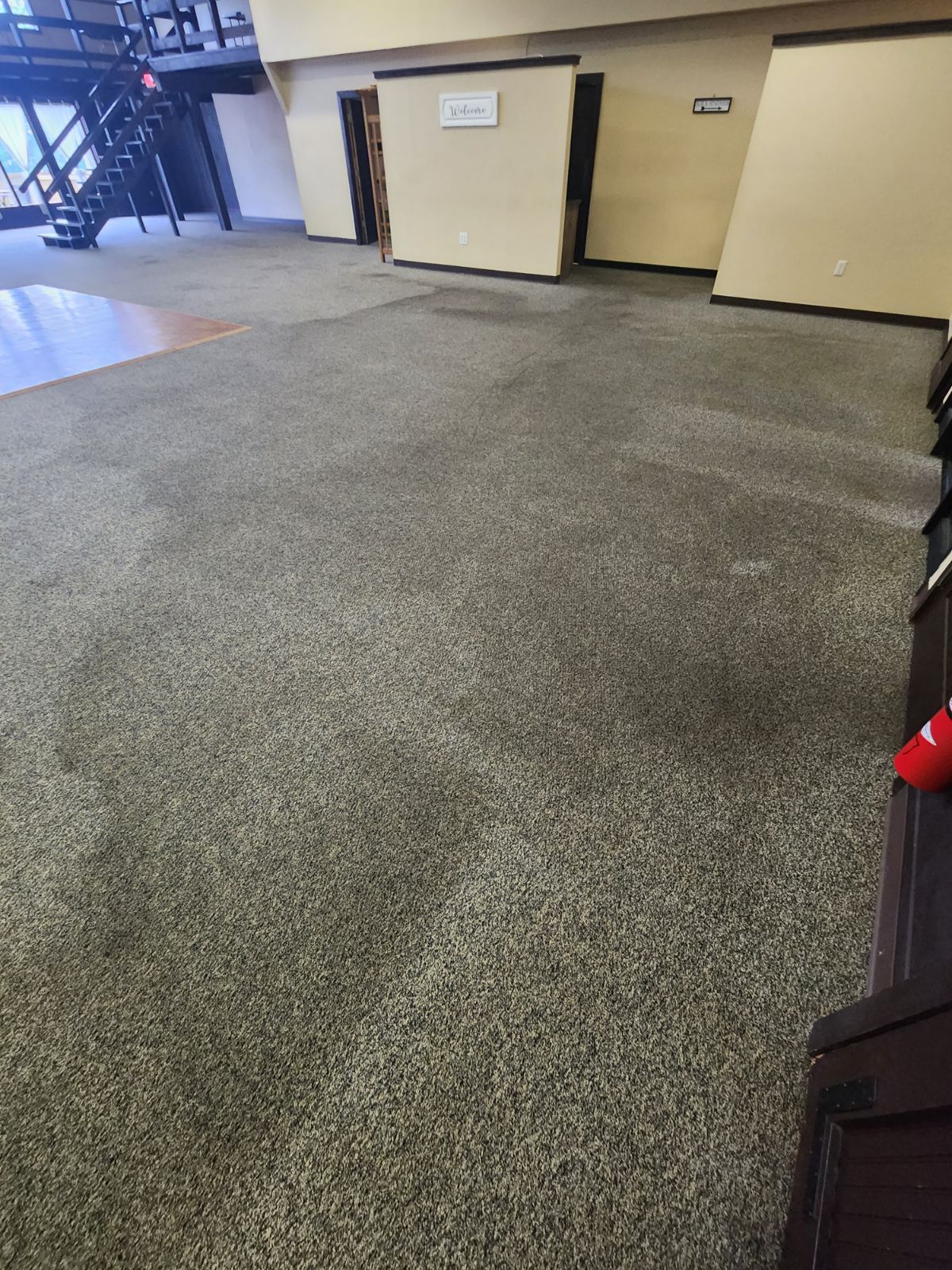

Our best customer yet found us searching the web last week. The roof leaked last month and soaked the carpets. All was repaired and dried out but the carpet looked terrible. She thought it was water damage because the dark area was exactly where the water was. When I met her and took measurements of the space I brought in a spray bottle of encap and a terry cloth. Sure enough the dark area wiped right up. It was soil wicking from where the water had drenched it. The manager was very happy with how it all turned out today. Cleaned up nicely.

The place only had cold water while we were there. I was worried it would hinder cleaning it well. Bridgepoint Flex powder is awesome stuff. I am really impressed with that prespray compared to everything else I've used.

Did you find out how long the carpet had been wet? You mentioned it was drenched. My concern would be what's under the carpet and in the padding.
When trying to correct wicking I always try to be on acidic side. I agree Flex is a good prespray, but this situation you would have been better off with Flex Ice or an Encap.

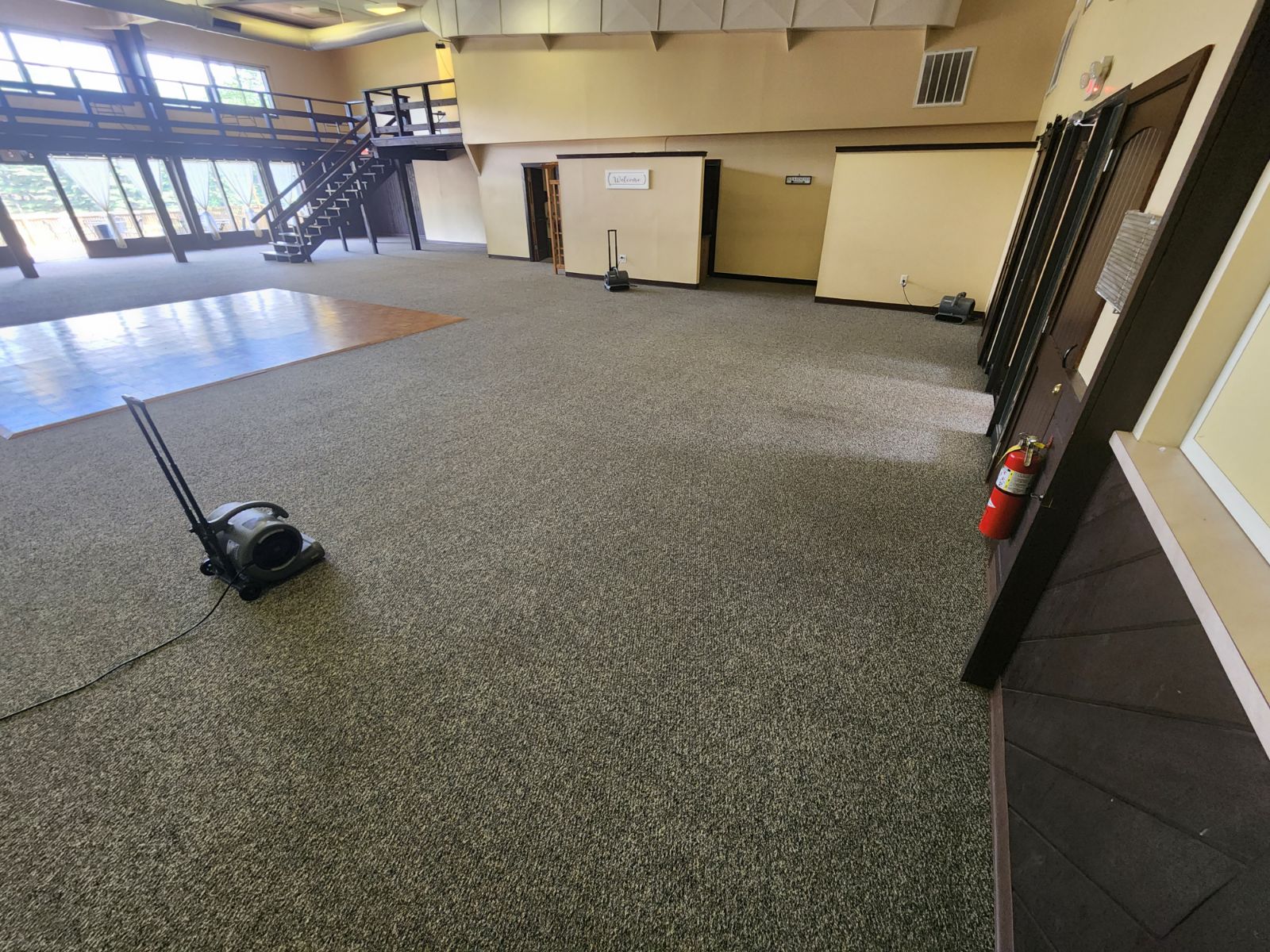

Thanks man I appreciate the helpful critique. They had insurance and a third party take care of the water damage and restoration over a month ago. The floor sits on cement. Insurance just didn't pay to replace the carpet so they wanted us to clean it. Place seemed bone dry. The guy that used to do all of their carpet cleaning recently retired.
I didn't feel compelled to check under the pad because of the situation, maybe I should have? I was just called for carpet cleaning though and it seemed like there weren't any underlying issues.
About the potential for wicking. I have Encapuguard by Bridgepoint which is 3.5 pH and designed to help prevent wicking. Maybe I should've used that? I've never even opened it yet. If one speed dries with multiple air movers like I do (used 3 today) is wicking ever really an issue? I haven't come across it yet. But I always use a bunch of air movers....

Sounds like all your bases were covered and your customers are happy. Job well done.
Encapuguard is a great product for wicking. I used to post bonnet every carpet with Encapuguard, it always left the carpets looking great. If you got the wicking to go away and stay away, that's all that matters.
Even when speed drying and perfect wand strokes, some carpets are just prone to wicking, but thorough cleaning and removing as much moisture as possible is your best defense.

Water “stains” on carpets are caused by particles water picks up as it travels through and/or over building material. As the carpet dries, these particles wick to the top of the carpet.
These “stains” usually clean up quickly, and wicking after cleaning is not an issue because the wicking occurs during the drying process. Make sure the carpet and pad are dry before cleaning.
The hydro-sensor is a handy tool to have for this and other applications.
