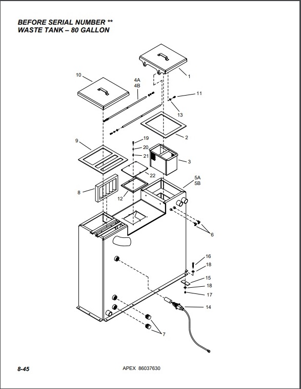

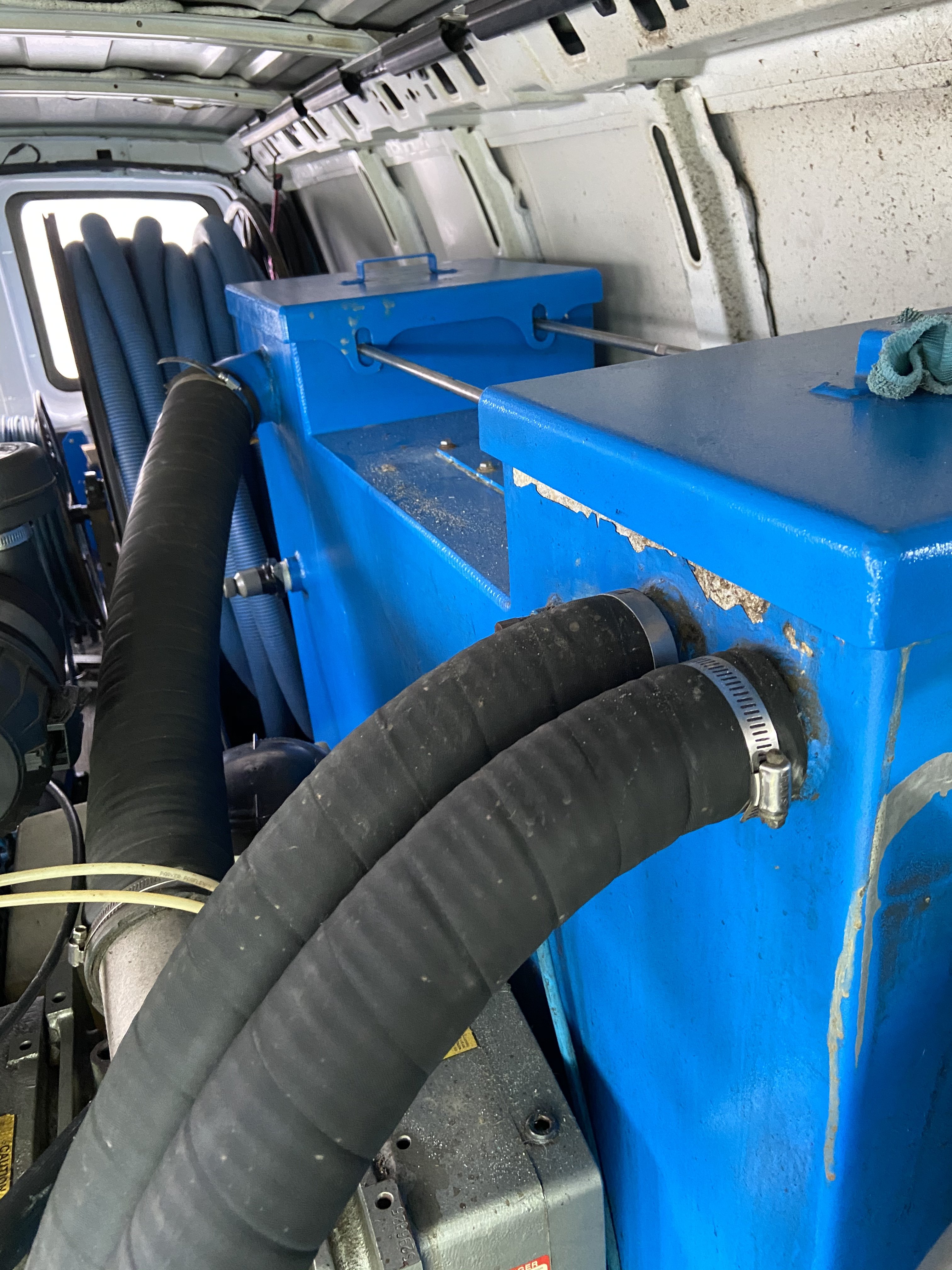

Legends didnt make it, Prochem did. Legends just bought Prochem.
Anyway the pictures of the waste tank look like it hasnt been cleaned properly for awhile. As Lee said, there are holes in the two baffles between where the waste water comes into the waste tank to where the blower filter is. They are located near the top of the baffle. On each end of the tank there are *flaps* that cover these holes so you cant see them and you need to get a nozzle underneath the *flap* to clean. If you look at the baffles from the middle access panel you should be able to see the holes on each side. They are near the top of the baffle. These allow air to flow throughout the waste tank without drawing water up from the bottom. Dime to a dollar they just need to be cleaned out. Problem solved.
Dont make it any more complicated than it really is.
And clean that waste tank

I did. Set at 13hg. And Thank you I will be taking off the middle access panel to the tank and checking it out today.

I don't really know how to interpret the manual....didn't spend much time trying but
Further down in the manual you will find the following:
"Using a tachometer, check the engine speed. Full throttle engine speed is 2400 RPM. Idle engine speed is 900 RPM. Refer to the “engine Speed” section for instructions on how to re-adjust. "
"DO NOT attempt to adjust without a tachometer and NEVER adjust the engine above 2700 RPM (Full Load). Permanent damage may occur. "
manual I'm referencing
