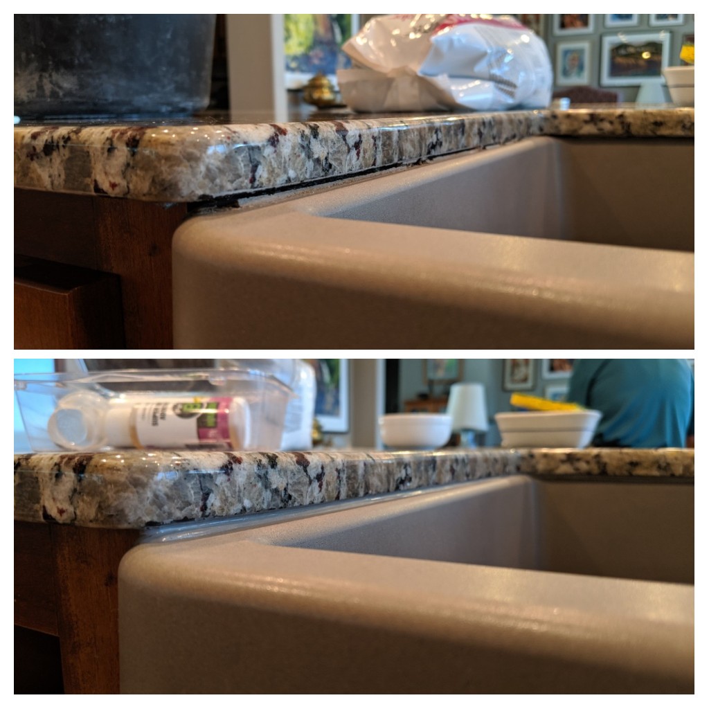

I better after shot of the triangulated sides would have been appreciated
117,380
Doug Rice
Feb 28, 2011
425
That looks like it's going to continue downward. Have they been sitting on the sink? Is the sink sitting on the cabinet frame?
