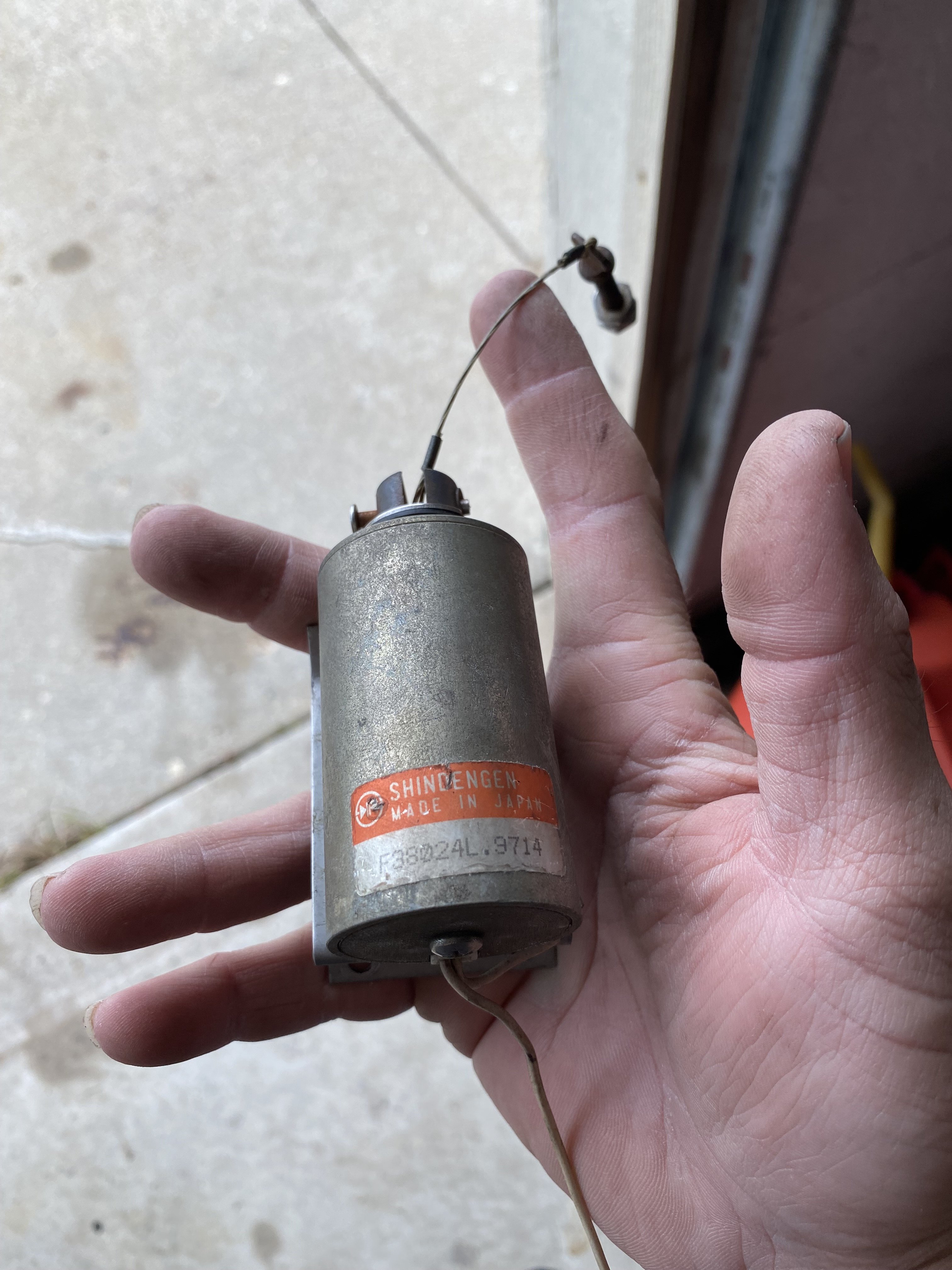

The way the PTO Steam Genie I got had this what I think is a 12v diesel cutoff switch.. It basically energizes sending 12v to the solenoid when you turn the unit on and the pulls the throttle pedal with the cable to the desired RPM..

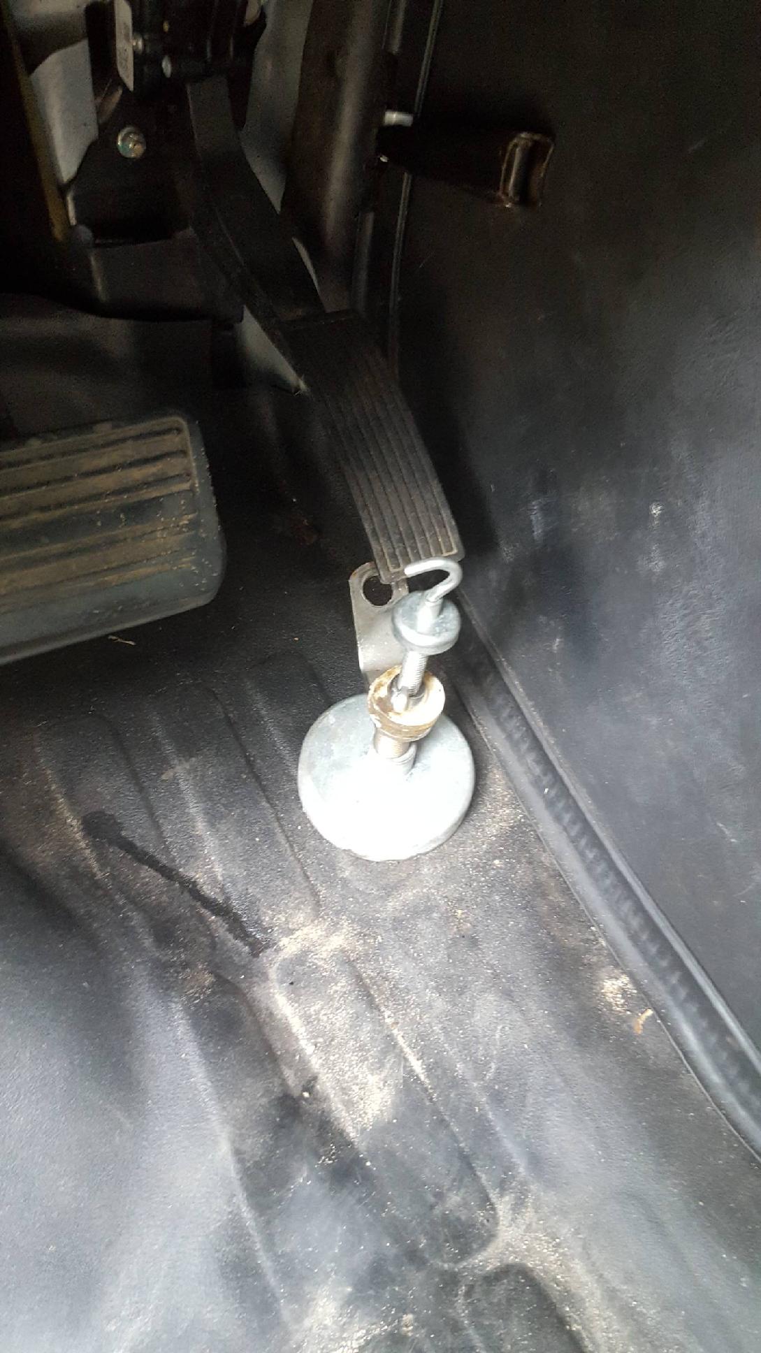

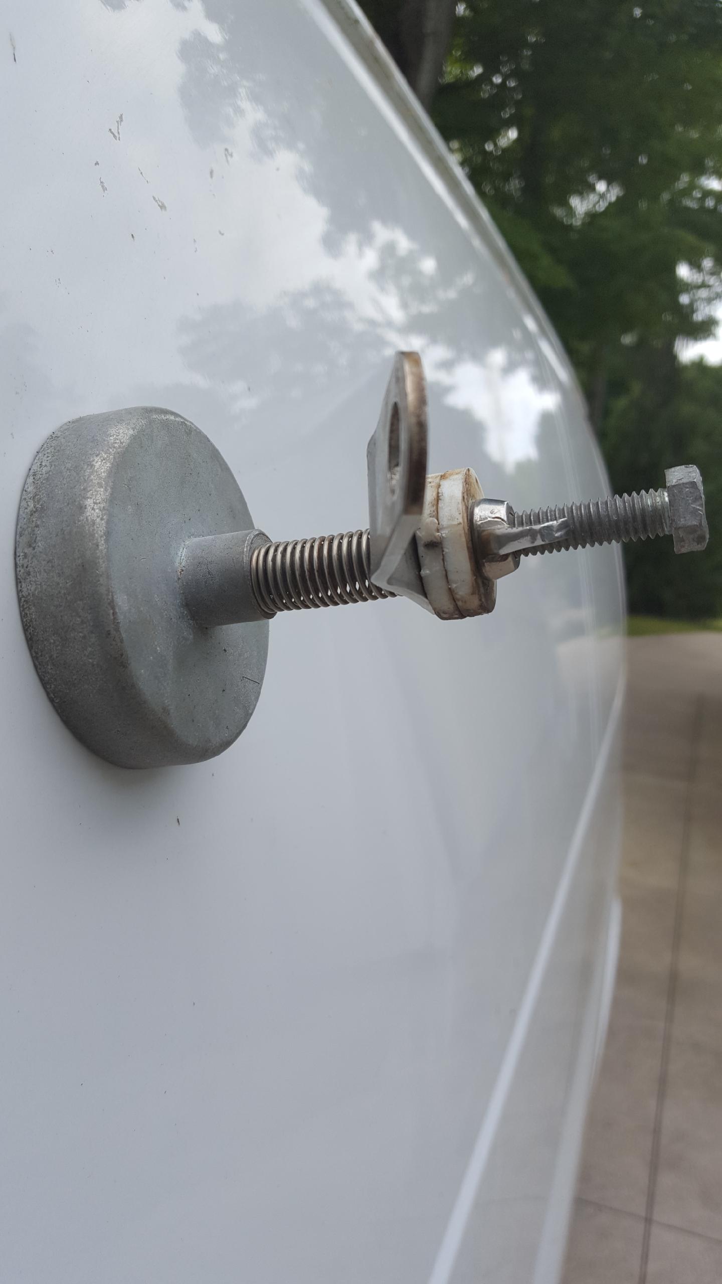

@Rob Grady Made a cool gadget to work with electronic throttle (drive by wire).. A magnetic mount adjustable to desired RPM..

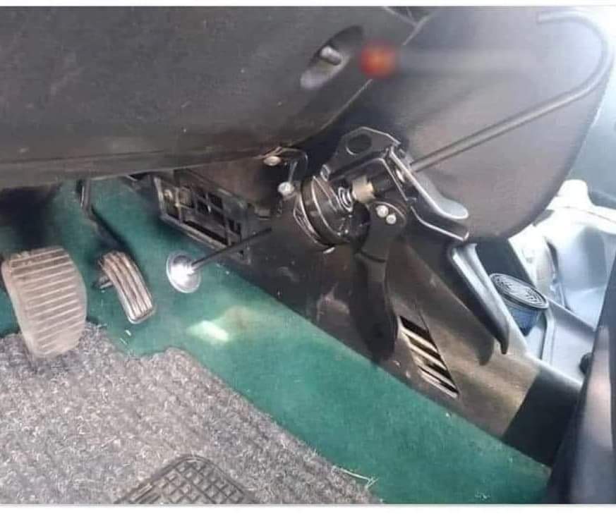

@Able 2.0 Sent me this as a joke, but it's not stupid if it works..

The way the PTO Steam Genie I got had this what I think is a 12v diesel cutoff switch.. It basically energizes sending 12v to the solenoid when you turn the unit on and the pulls the throttle pedal with the cable to the desired RPM.. View attachment 112601
View attachment 112602View attachment 112603

It gets mounted under the dash.. You drill a hole on the top of the throttle pedal.. It pulls the top of the pedal which simulated like stepping on the pedal.. It works on a 2000 Chevy.. It works for other diesel applications..
I’m sure it should work for you.. But then again, I have no “real hands on” practical experience with it yet..

Patent not pending. The magnetic throttle control I use for my 07 Butler works well for my purposes. I can set speed/rpm by dialing down on the threaded rod, using a TinyTach to determine engine speed.
I am only using this setup as an interim measure until I can dig deeper into the mysteries of the Butler wiring this winter.
There is an engine shutdown sensor buried deep in the front of the 6L that has a bared wire that prevents the unit from engaging. I have the unit running on just the hot wire from the clutch to an on/off switch.

It''s not complicated. Look at the pic Nate posted. Nothing more than a heavy duty magnet with a threaded rod and a SS bracket that dials down/up to set rpm.

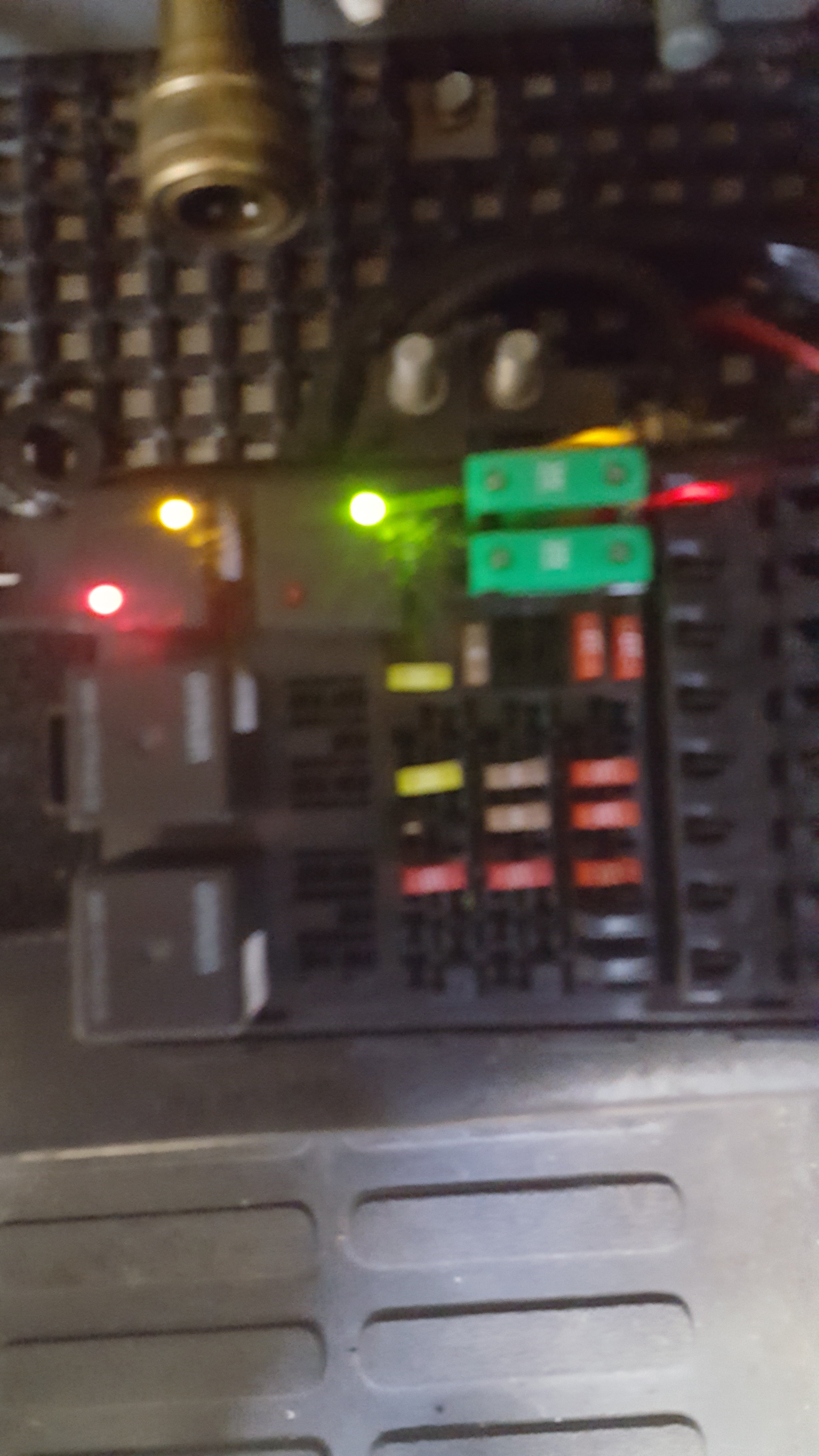

I was referring to how butler does it. Computer board ? Throttle positioning censors? I know nothing about anything other than Vacuum advance and would like to know how the newer pto advance set up works for future reference
Sorry I can't help much on that. There is a fuse/relay board behind the passenger seat that monitors the whole system. I do know that the wiring on my 07 Chev it's specific to that model year.
