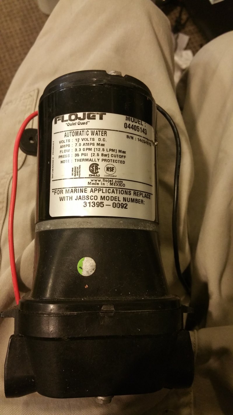

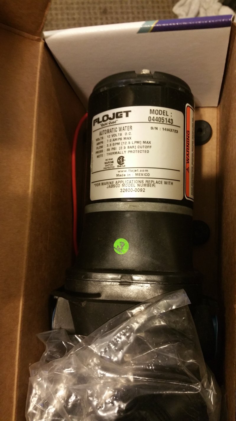

I do have another pump that is the same with like a month of wear that I will throw in also..
