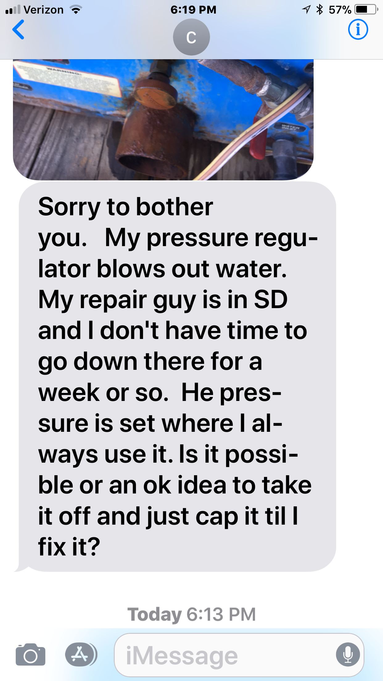

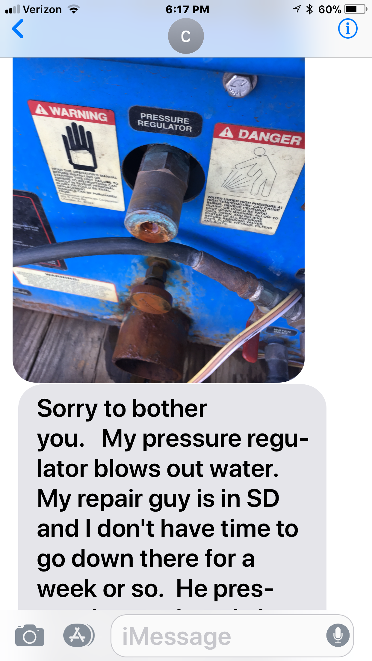

I told him no because you pull it out and you got no pressure regulation.
11,570
But why would it spray water besides being old.
A
Able 1

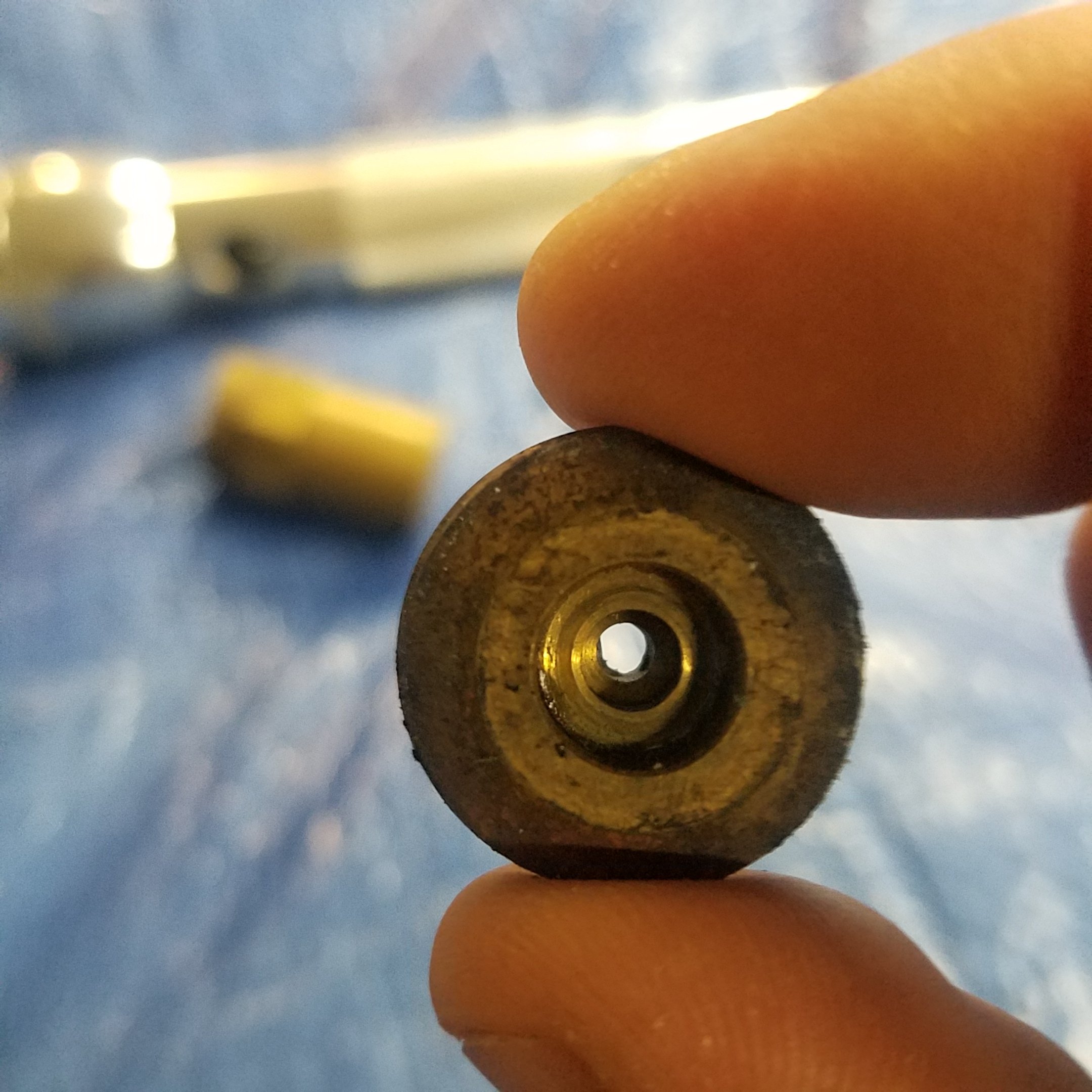

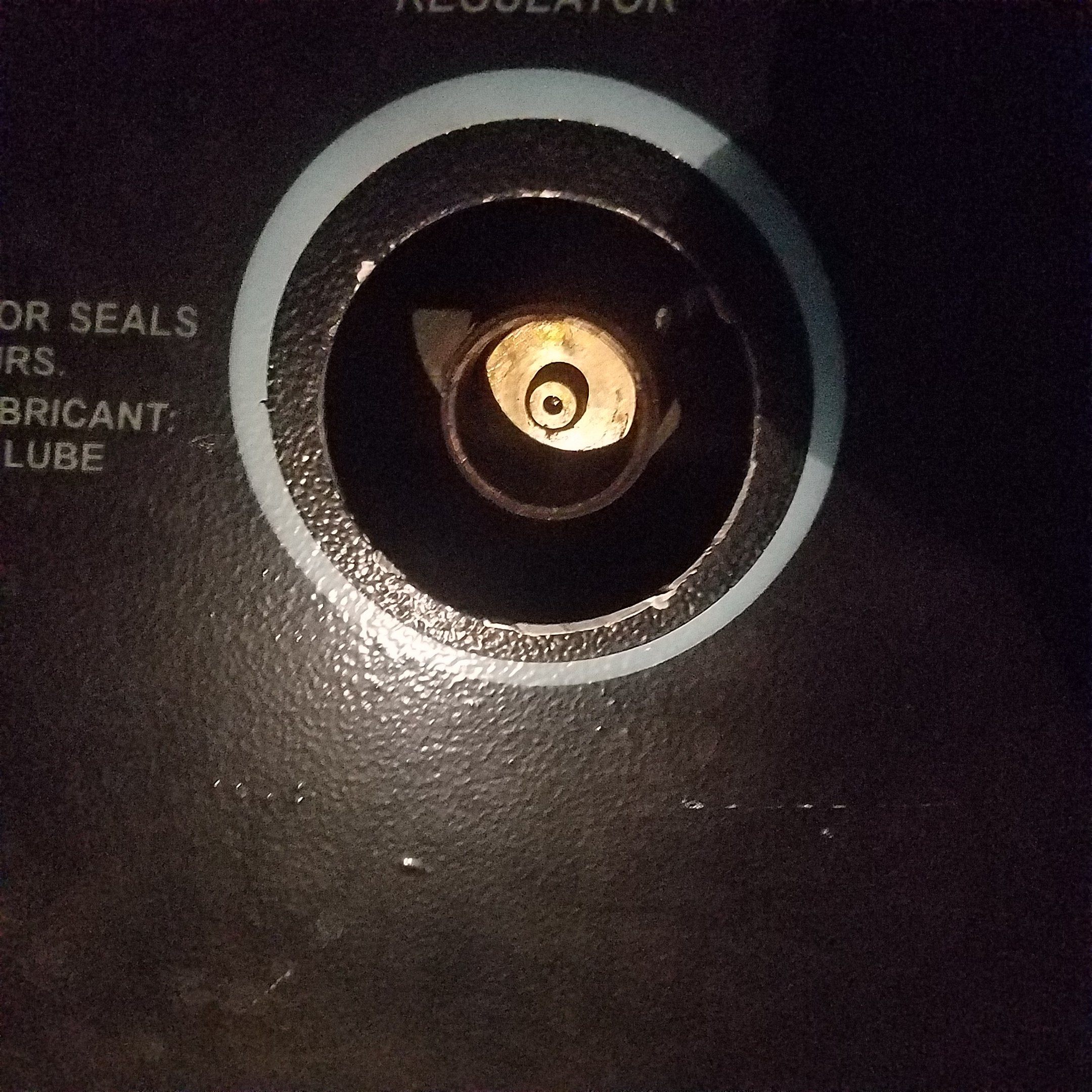

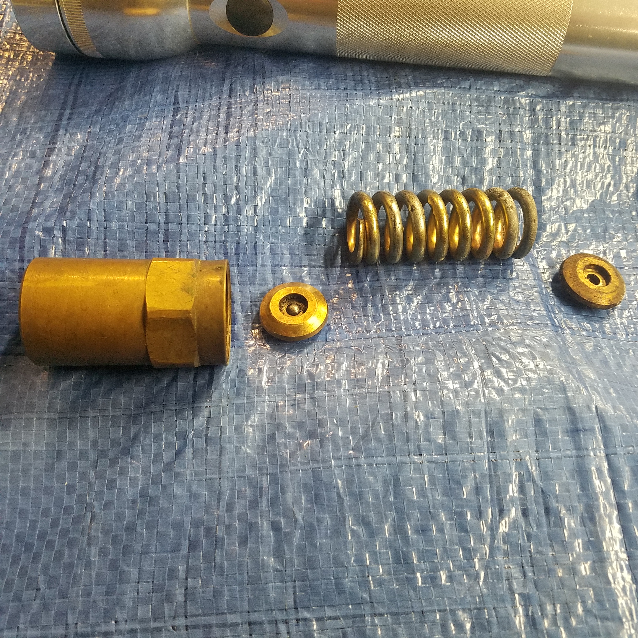

What has probably happend, if the water is coming out of the the hole in the middle of the regulator (?),is he lost the disk behind it some how..
11,570
Thanks that makes sense, so stuff a penny I there?
Lol
Reactions: Able 1
A
Able 1
Not sure a quarter will work, but its worth a shot if he can't get parts..

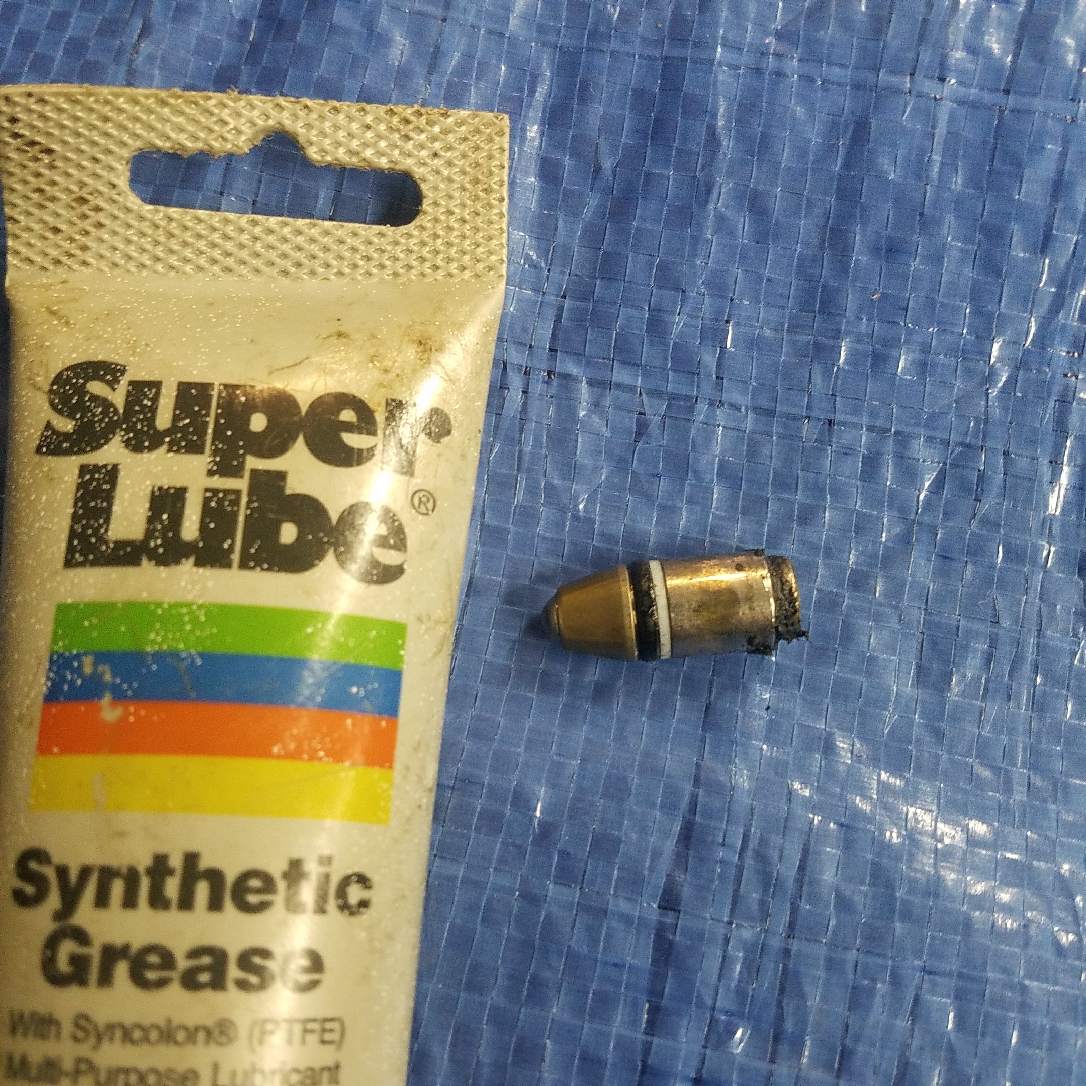

For getting me off my ass and lubing it! I love this side of the business! You know, like screwdrivers and stuff..:eekk:

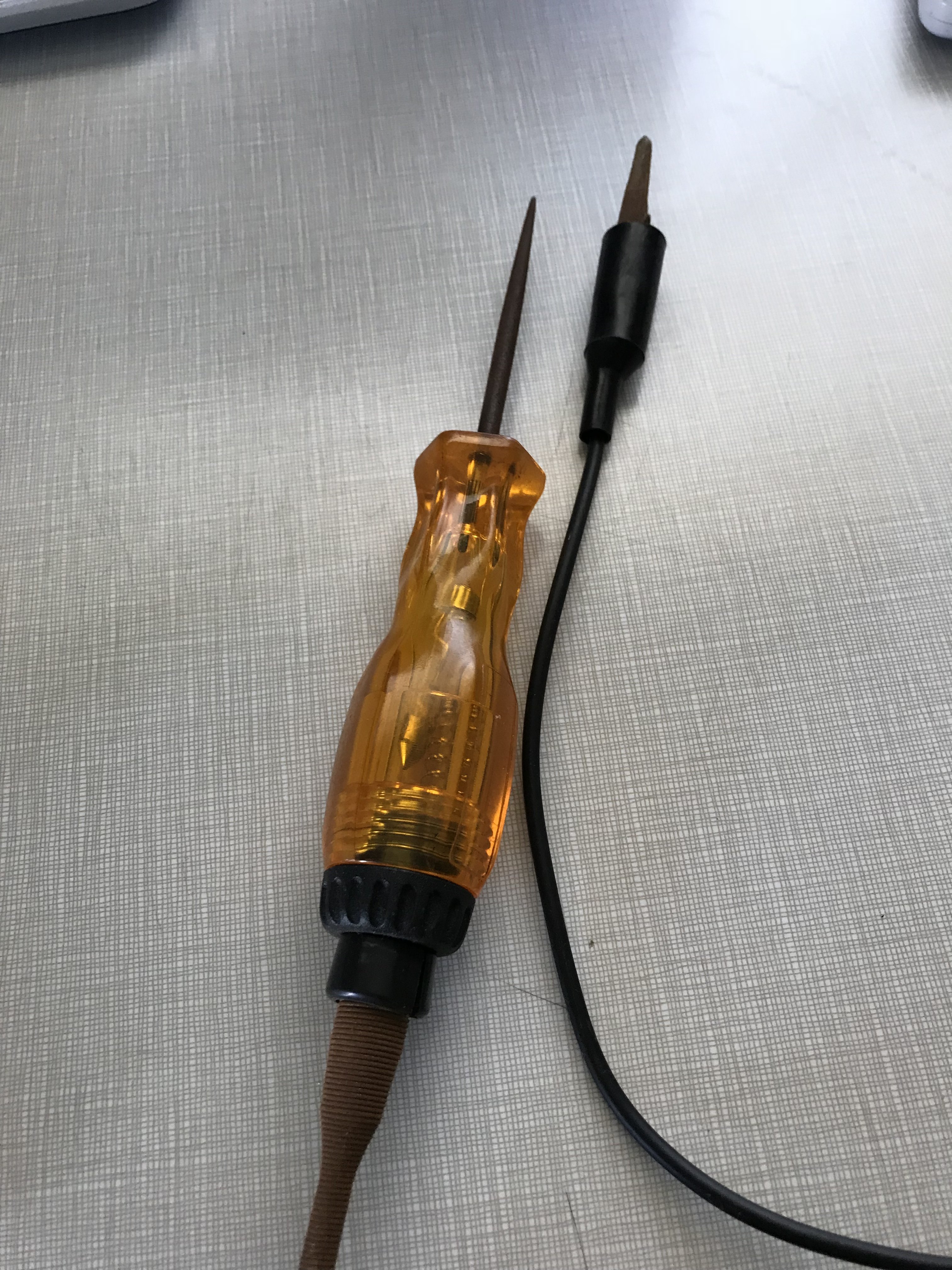

You should send Marty a picture of a screwdriver so he knows what it looks like.
