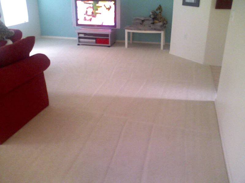

5k last week from property manager that wanted triangles; or Christmas Trees as I refer to them; anyway we do a glided wand stroke after powerwand cleaning; Protector we just groon back some triangles!!
