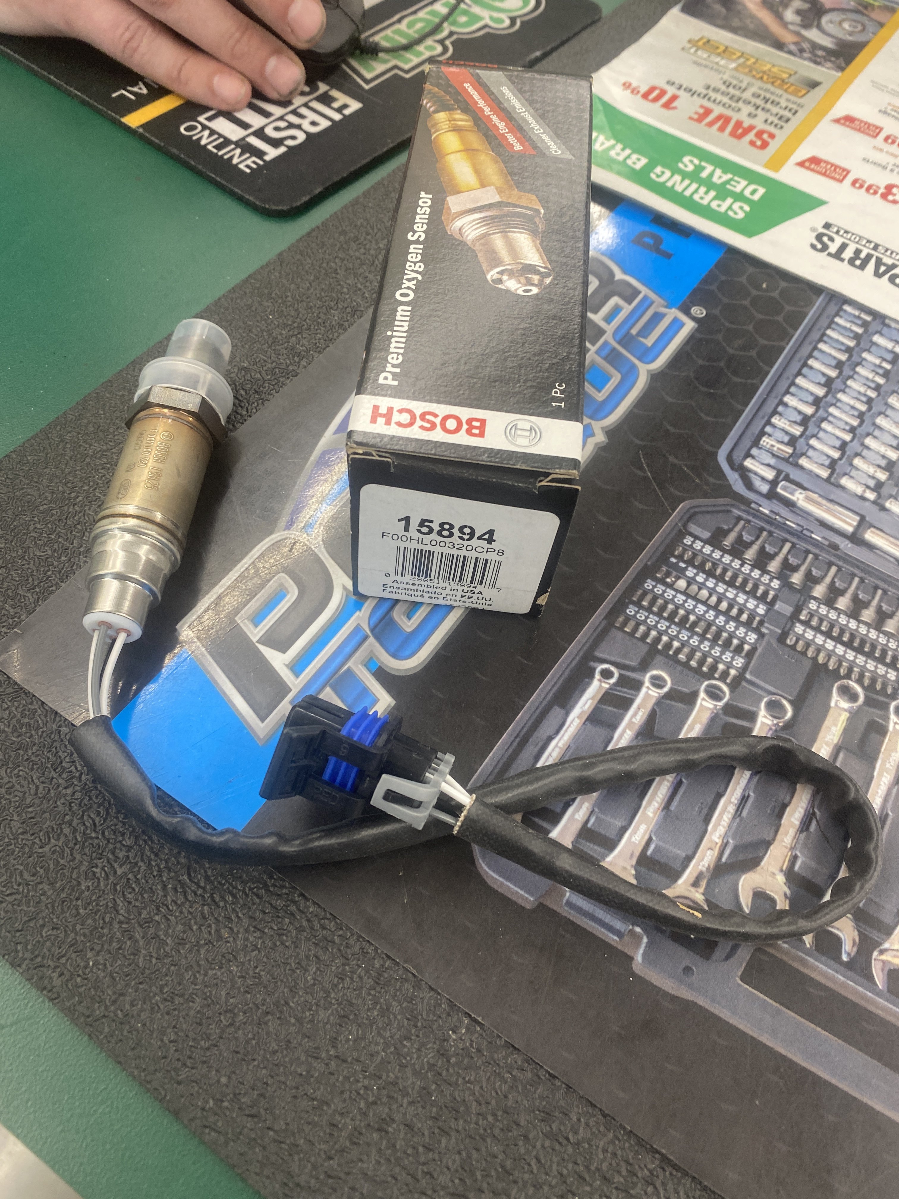

I am still having trouble but have a work around. Btw I also have a Thermalwave 11 . Psi engine for parts but pm me if you need some parts numbers do Orilies cross over . But if you run into any problems the guys at cleaners connection (gene) have been a life saver. My problem looks to be an o2 sensor and ecm. Tons of trouble shooting and actually was able to get the computer diagnostics cable to connect to my laptop and see all operating stuff .

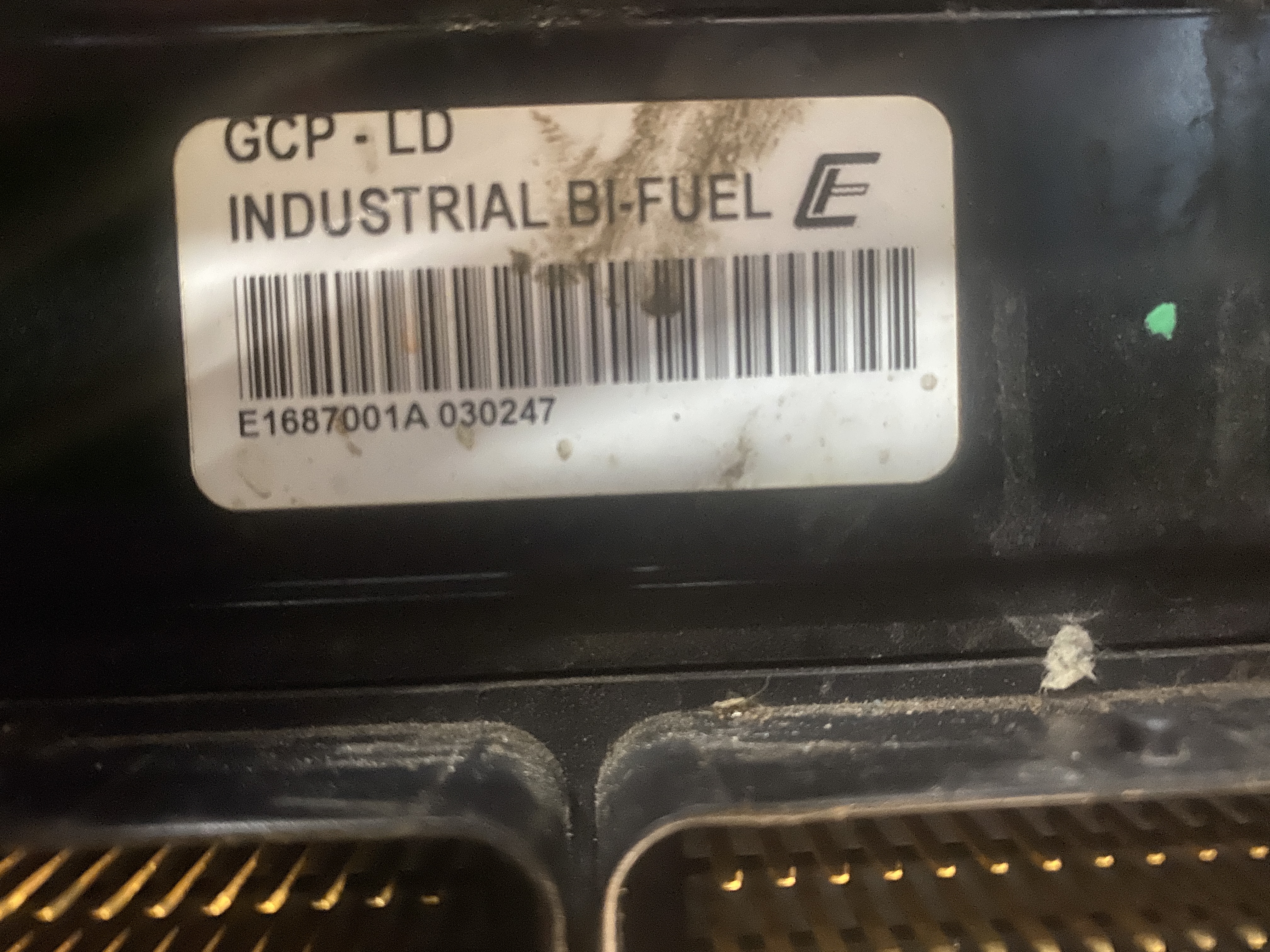

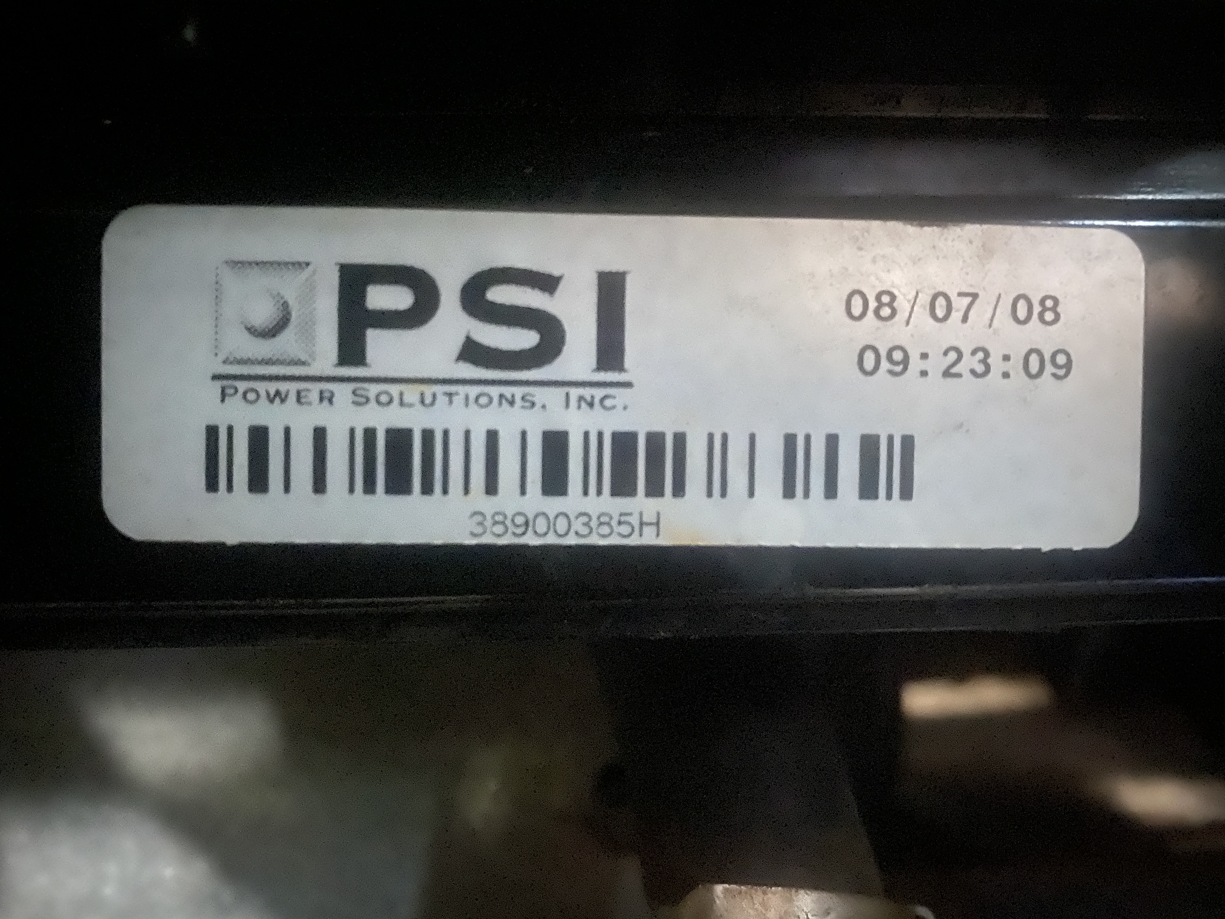

Need a replacement ecm. Here is the pictures f the one I have .

Attached is the part numbers for Orilies . Coil pack, o2 sensor 1 , wires ignition, plugs , secondary o2 sensor. If you get a problem missing or stumble try wires and plugs first .
