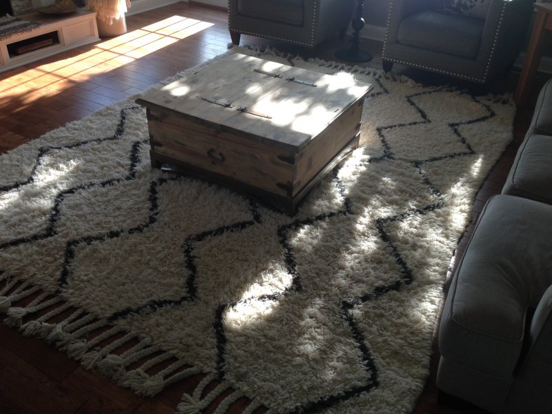

Thick, floppy wool rug help
Russ T.
Sep 26, 2008
3,556
Russ Terhaar
Customer has a very furry but floppy wool rug. It doesn't have a nice stiff back where I feel like I can get aggressive at all with it. It's very loose feeling and customer said it sheds like crazy when she vacuums. She understands now that she bought a pretty unpractical rug but wants to see if it can be saved and placed in another, less used area.
Her main concern is urine. There is some minor spotting on the top and quite a bit on the bottom of the rug.
She paid @ $900 for the rug. It sits on a very nice hardwood floor and I will probably be doing the cleaning off site, if at all. I told the customer I'd do some research and would get back to her by Monday. Any help would be great, thanks!
P
Pat Muller
This can be cleaned as with any other wool rug but it will need to be tacked out to hold its shape
Once it is tacked out I wouls shampoo it with Chemspec oriental rug shampoo and rinse it with Chemspec all fiber textile rinse.
The urine is another issue but since this is a very loose weave you should be able to remove most of the odor.
If they are stains from the urine I would tell her the wool has been permanently dis colored

View attachment 3959 View attachment 3960
Pat's cleaning suggestions are spot on. For the stains you might try using stain magic for wool and applying it with an eye dropper . Watch it and then when you have gotten the reaction that you wanted EXTRACT thoroughly. The third bottle in the kit is CSS. But I cant remember if you aplly it before or after the treatment. It's on the directions . Most important is to keep eye contact and extract

That's an Indian copy of a Moroccan rug. If the dye in the black squiggles is solid you can immersion wash it or try to clean it with a wand or rotary extractor. Pat's an expert, so unless you have a very soft brush and use a lot of shampoo as a lubricant, use of a rotary brush can do a lot of damage to that loosely twisted yarn. Because it is so sensitive to abrasion, it will be difficult to fully remove a heavy traffic area.
Don't worry about shrinkage. The rug will tighten up, but it will likely dry more square than it is now. SELL HER A BETTER PAD!
The fringes are cotton, and since they're tightly braided they will dry slowly and tend to brown out. don't worry about it, just be prepared to correct it.

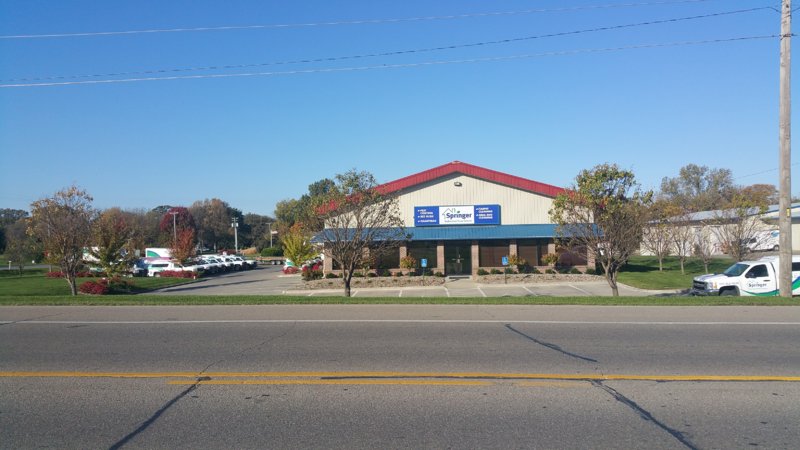

Springer Home Services near West Des Moines seems to have a decent rug plant setup. Robert Hughes owns the place or works there. I would check in with them about wholesale cleaning. You can still make around $1.50/sq ft. and not have to do any of the work except pickup and delivery.
http://www.trustspringer.com/index.html

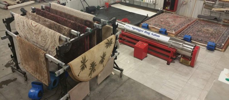

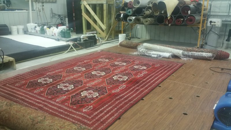

Hey Russ,
I just signed up with this board not too long ago and saw this post. Not sure if you brought us this rug or not.
I don't recall meeting you, I would love to take care of some of the rugs that you don't feel comfortable with. I work with
several other cleaners in the area for a discounted rate. Most just drop them off to us, we clean them, and you can deliver
back to your happy customer. If you ever want to swing by or grab some lunch let me know.

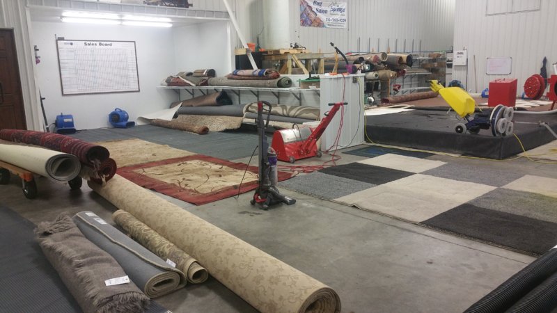

117,375
Welcome aboard Robert!
Hopefully the "decent" comment didn't sting
Do you have any photos or details of your rug plant that you can share?
Reactions: Robert Hughes
