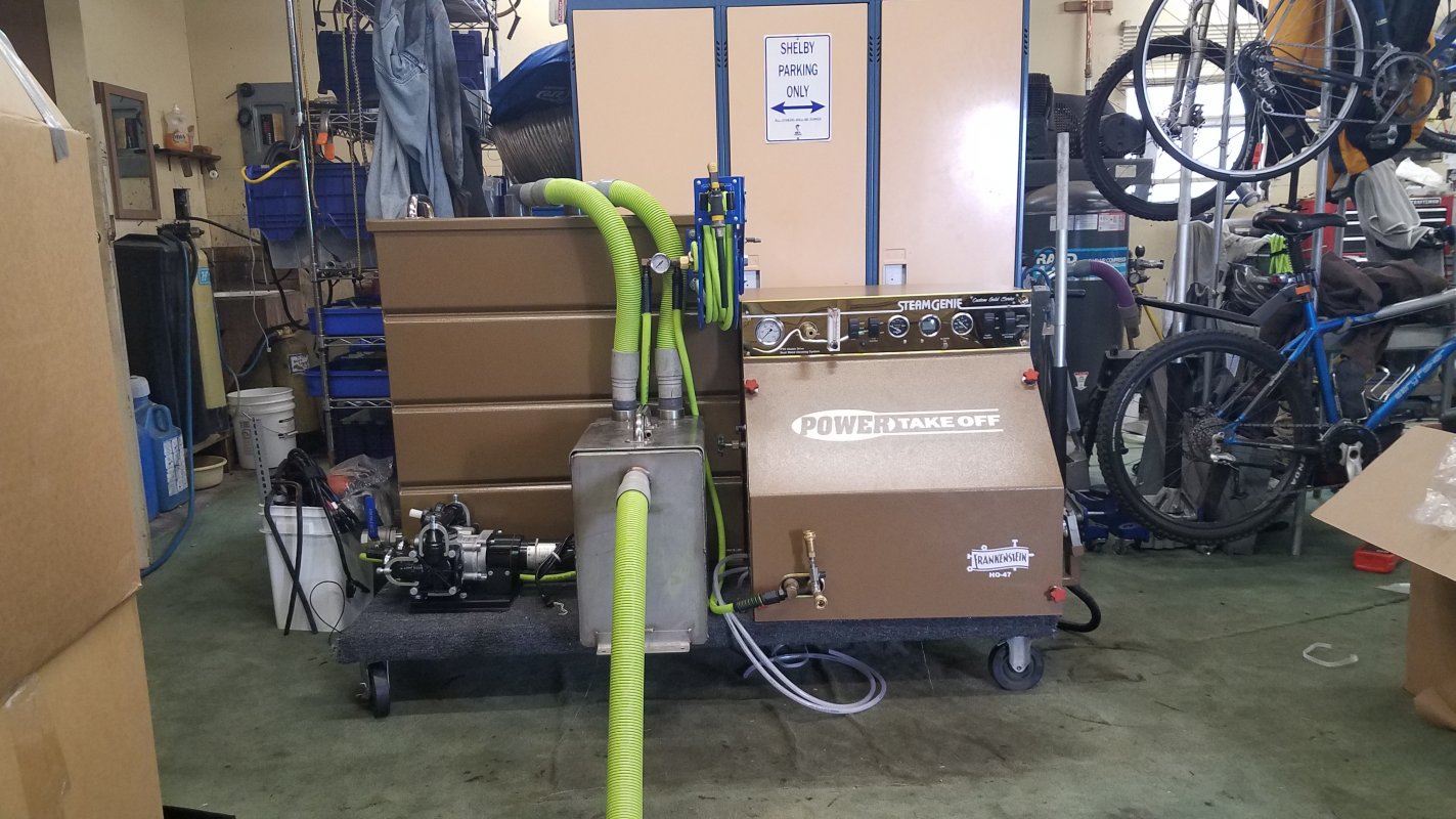

I used to think Bawb did a good job until I saw this guy

Was he selling Frankenstein's or just for himself.
To me what was so impressive about Bawbs was they were rebuilt so detailed as if he were keeping each one.

Yes ...1st primed with metal etching primer...then primed with 2K primer followed with blue base coat with a couple coats of 2k clear....shiny!!!

@Dwain Ray Is almost as old as Bawbby, they take pride in their work.. I do like the Cleanco coolant and blower HX mods he did.. Keeps it stream line..
Makes me wonder if the hose reel on the waste tank is to rinse it out after?

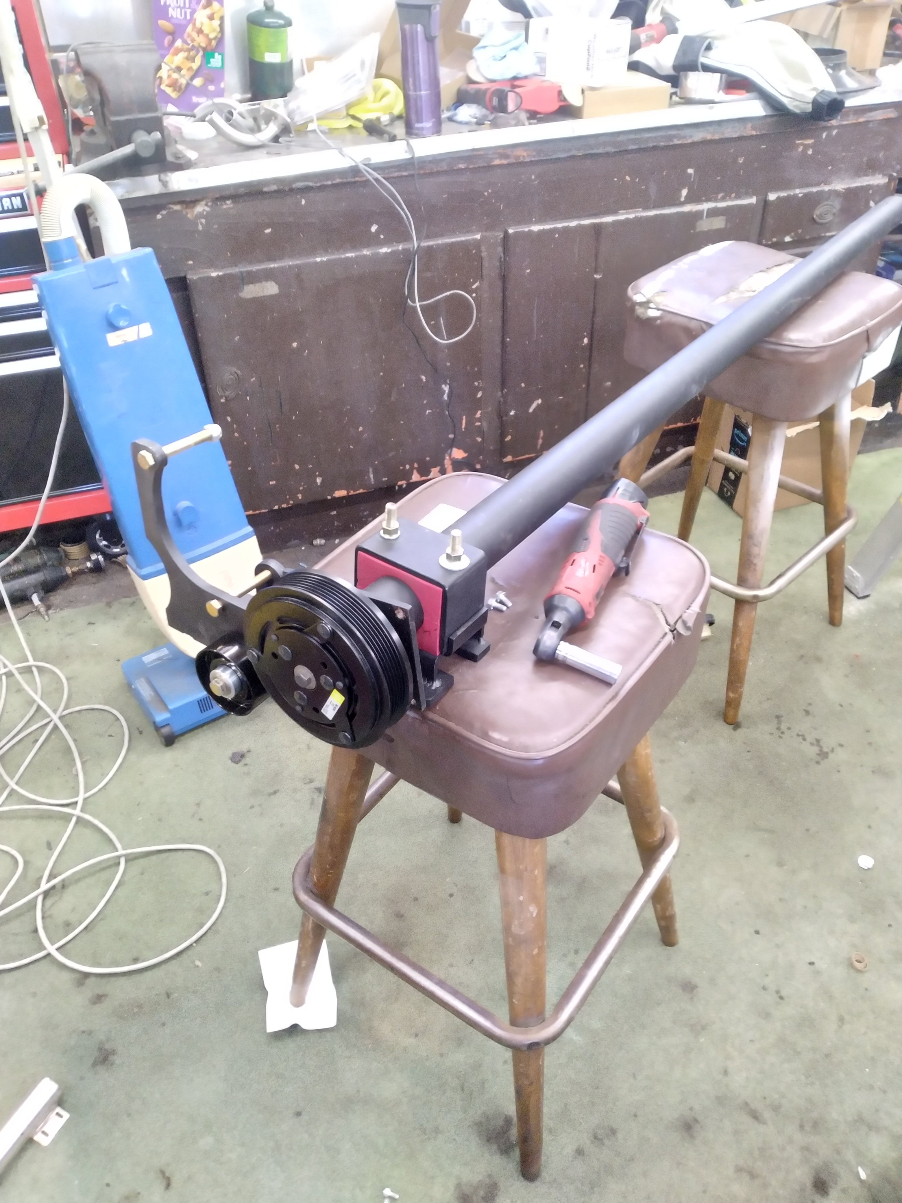

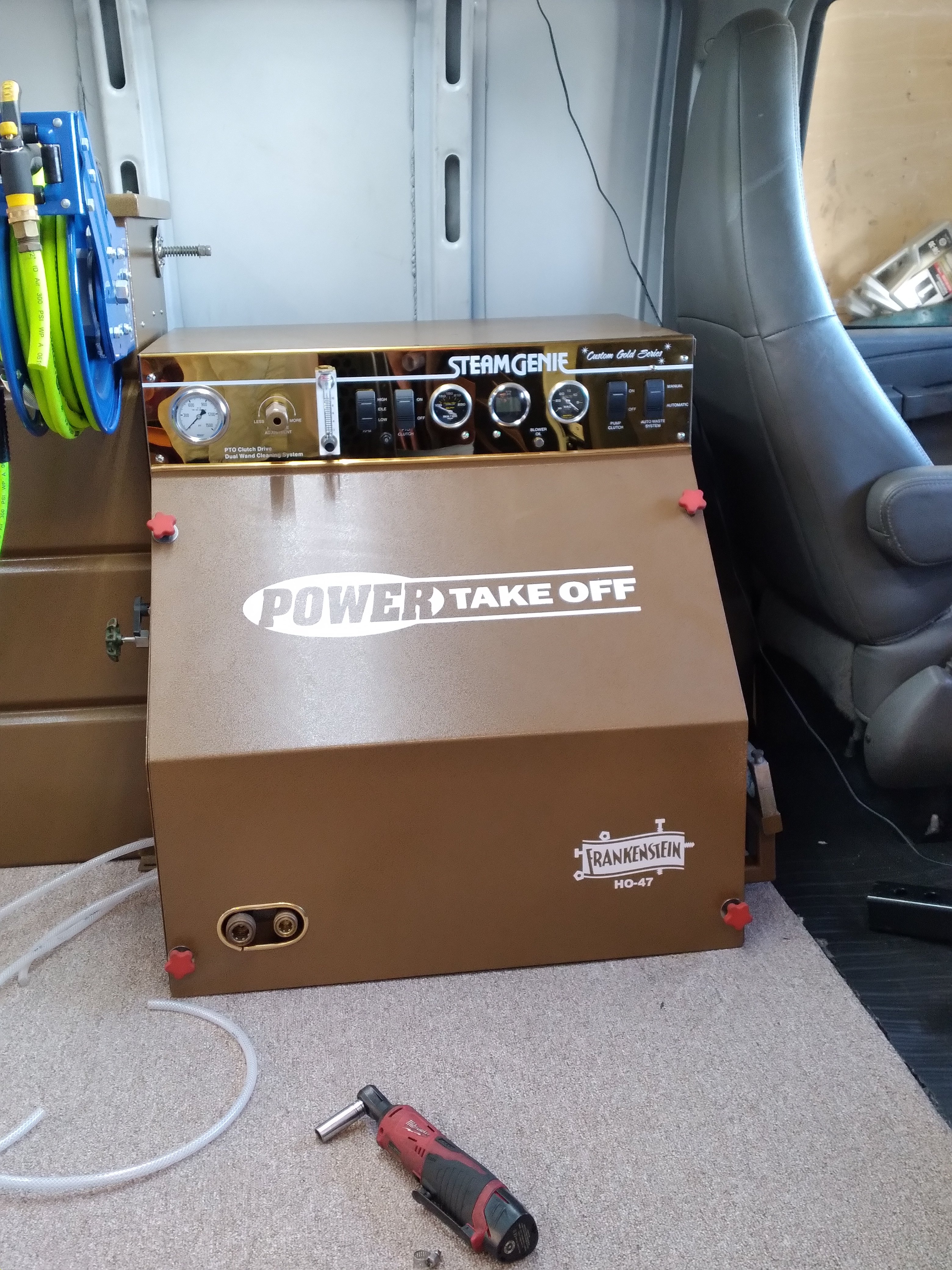

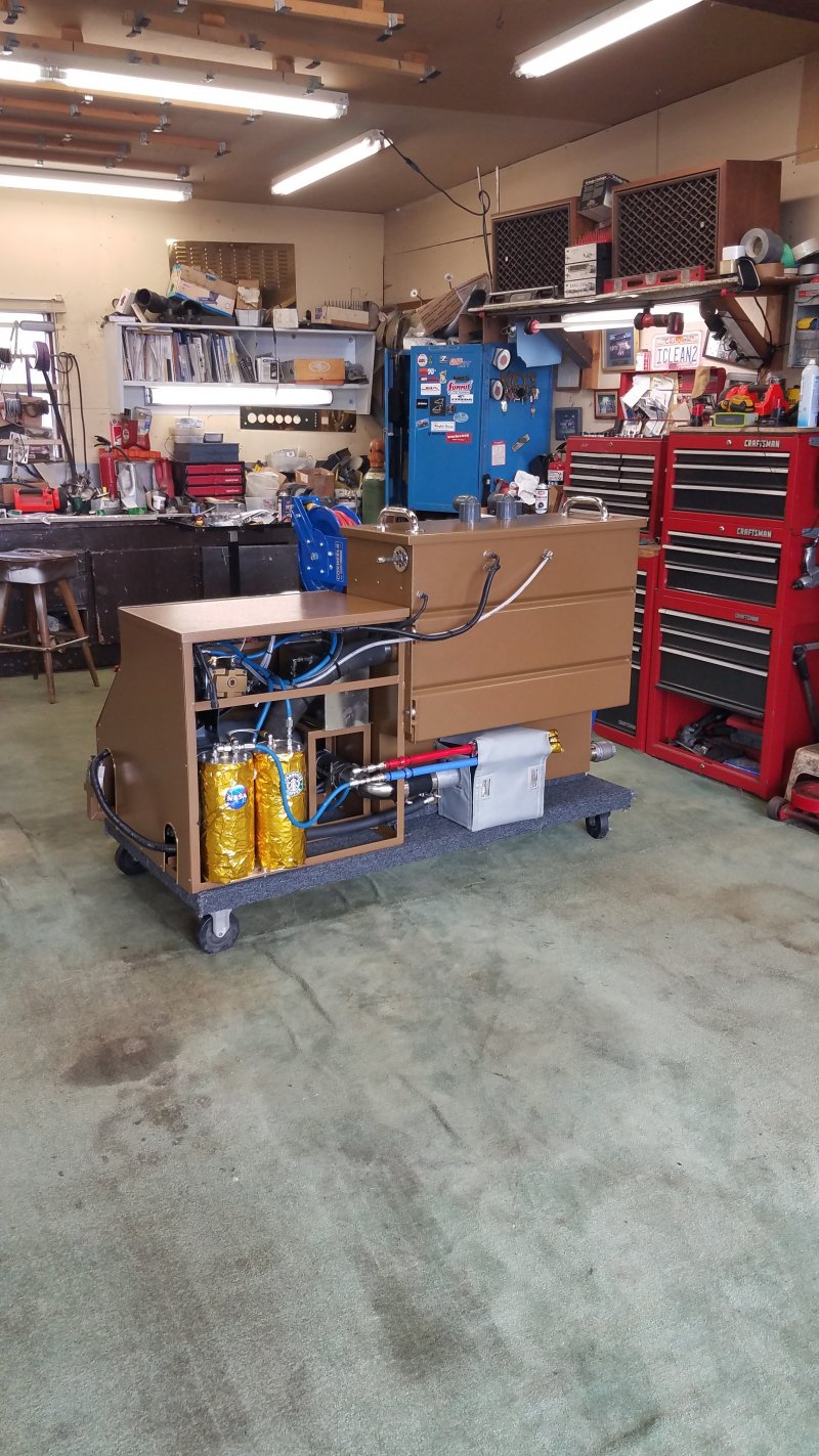

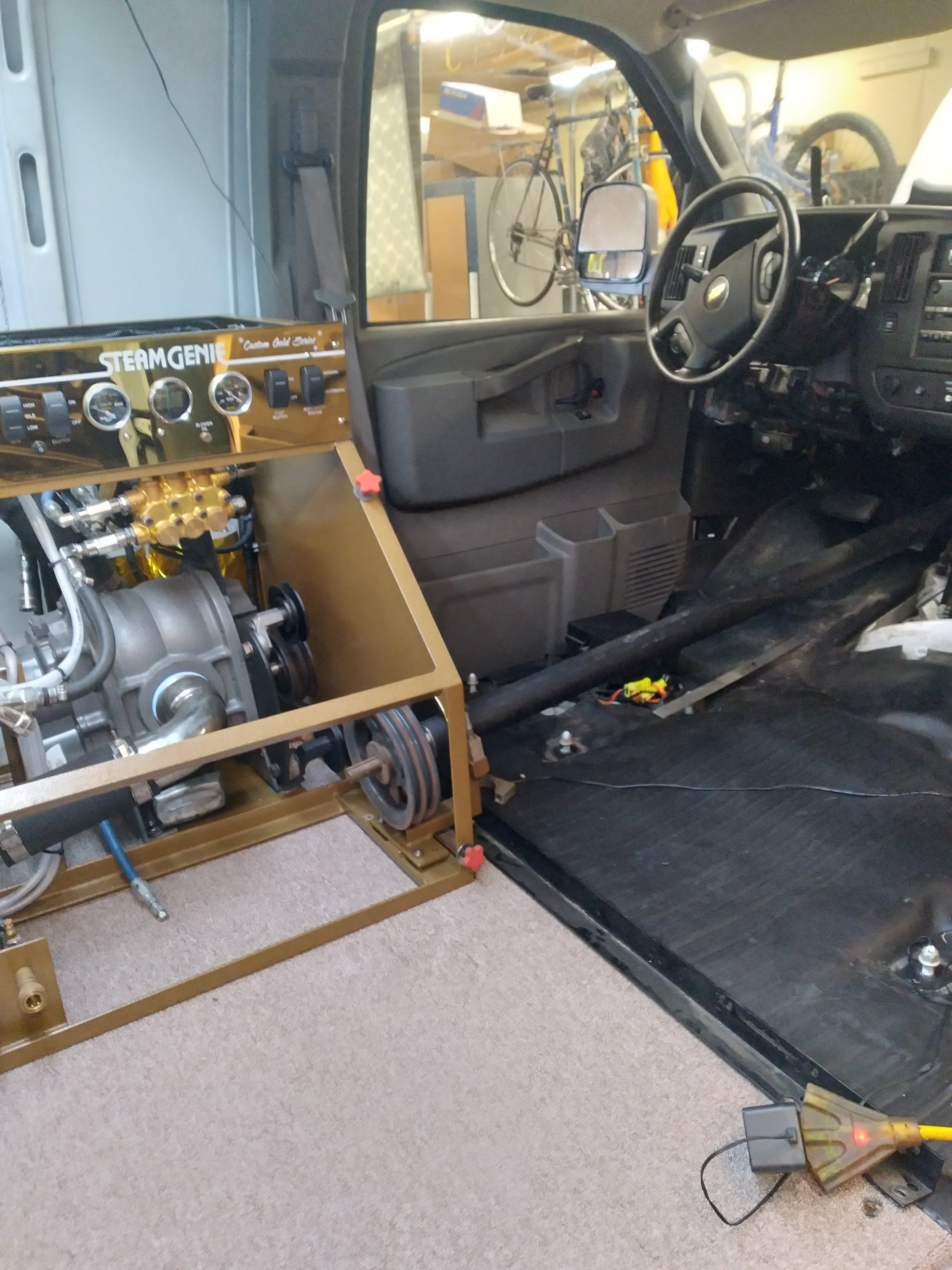

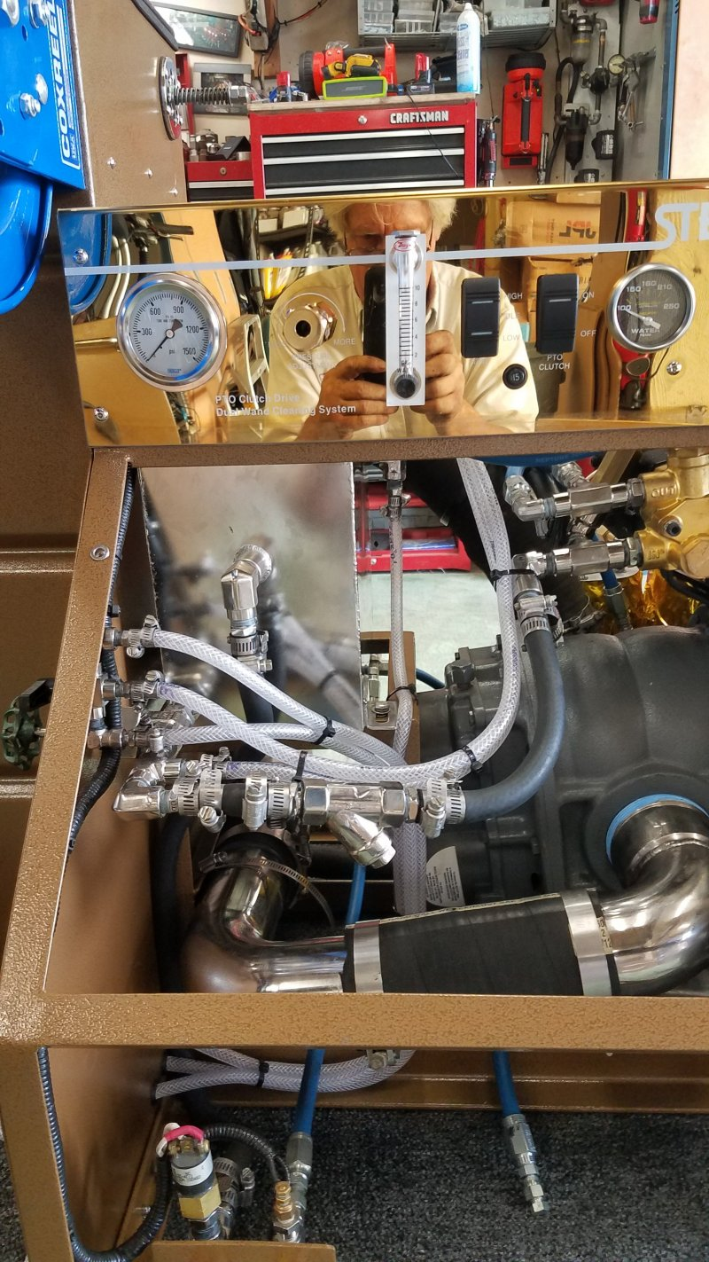

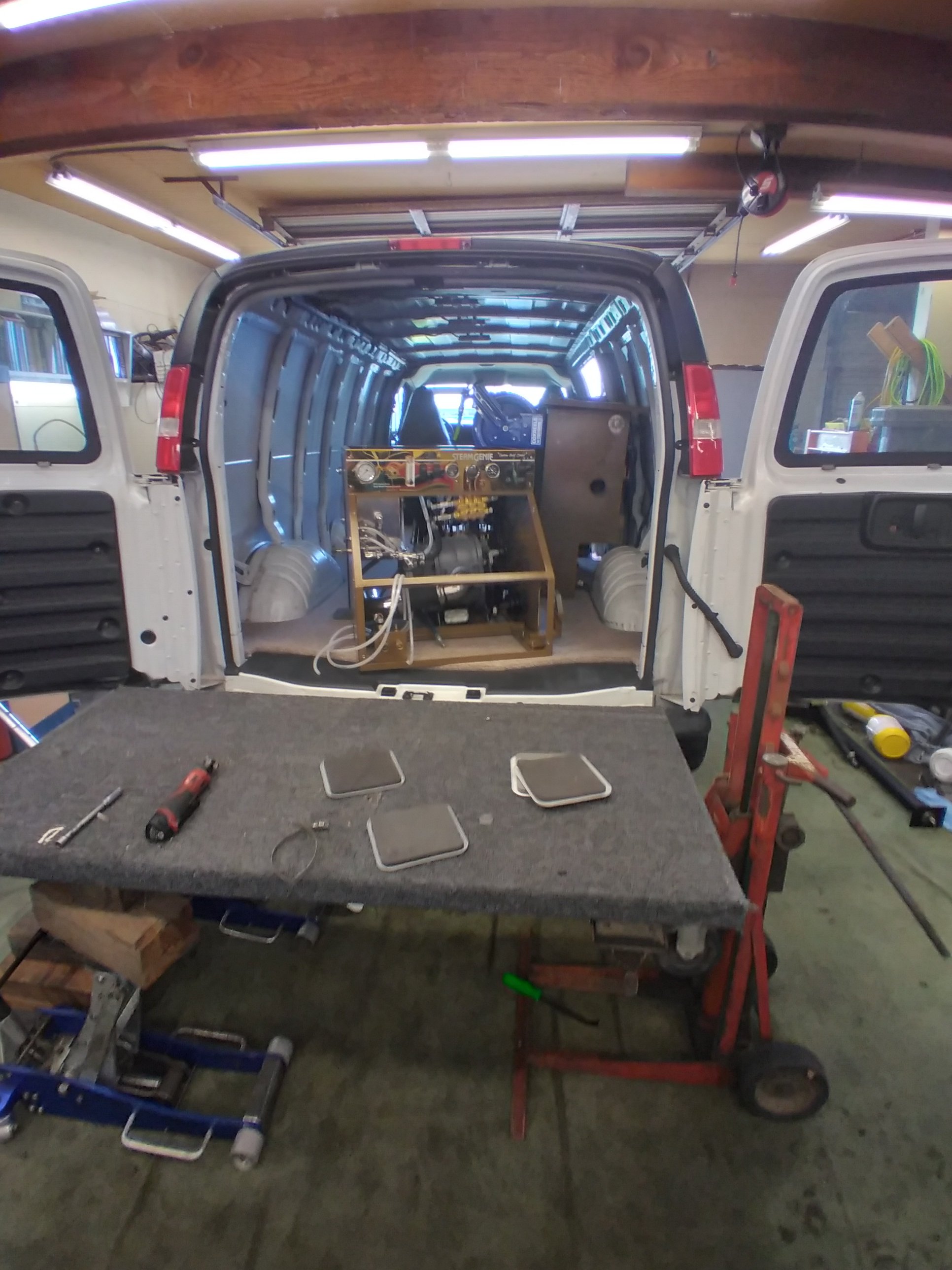

No i use the that to fill jugs, wash off wands, anything you would use fresh water hose for. it is just real handy to grab and go holds 25' 60 buck harbor freight all my trucks have 1 heres pictures of my new project, it's called frankinstien its 60% steam geni, 10% hydramaster &sapphire scientific, 30% cleanco ,100% Dwaino it started life as a 45 steamgeni ,im installing it in a 2020 express 2500 6L extended van, it should be cleaning carpets around april im taking my time to get it just how i want, everything will have a place, nothing thrown in nothing laying around ,

Magic Wand in Georgia sells Para Plate stainless pressure valves....space shuttle quality and last forever!
Is that a Pitts clutch?

She's a beaut, DR!
Your relocating the alternator to the left of the drive shaft? I have a 2003 4.8l.. My best friend/fabricator broke the news to me that he's moving to Las Vegas.. Sold his mill machine & lathe, and other tools..
Our other mutual friend is a Chevy nut.. He's down to help me get it going.. I care more about making sure the drive shaft is properly alined and I can do the rest behind it.. I know what I know and know my limitations..

It looks like there is no room for the drivers seat.
