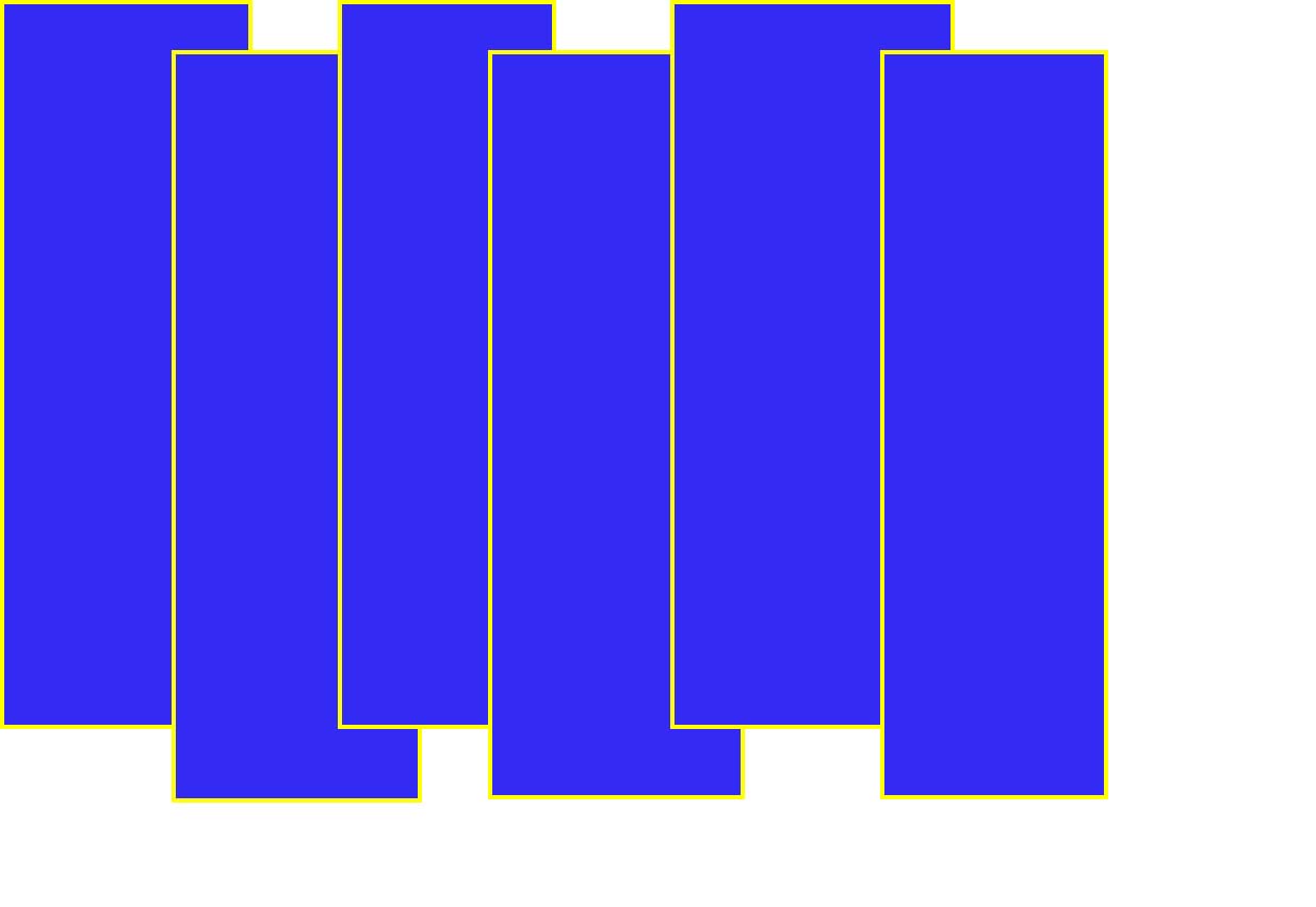

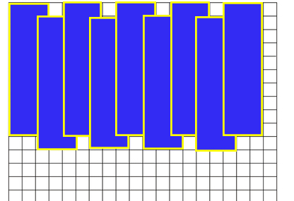

Proper stroke in my opinion is trigger on as you pull it towards you. Push wand up over the area you just cleaned. Overlap by 1/3 and repeat. Then dry stroke over the same area. Straight up and down, no sawteeth.
So that way assuming jets are all the same you double rinse two strips of 4" and leave a single rinsed 4" strip in the centre. Now that could make for a nice pattern, with uneven drying and wick'back:headscratch:
We overlap by just a smidgeon and lift the wand for the next pass when doing domestics. On commercial different story as they are usually low pile synthetics that don't hold a wand mark much
roro
That doesn't make any sense at all. If we overlap by a third, the carpet gets flushed 3 times.
