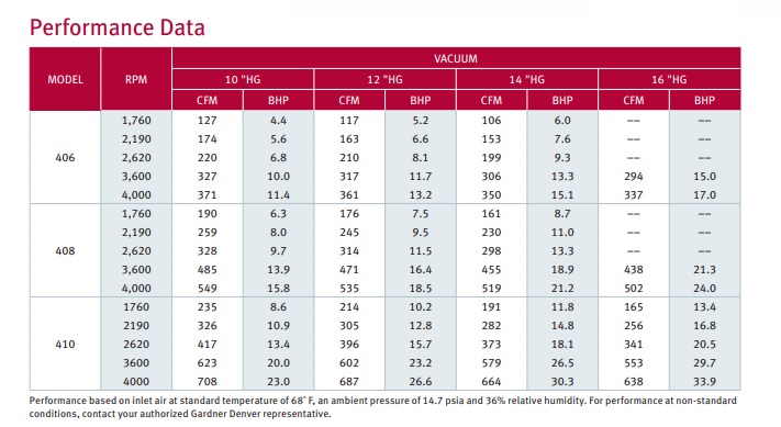

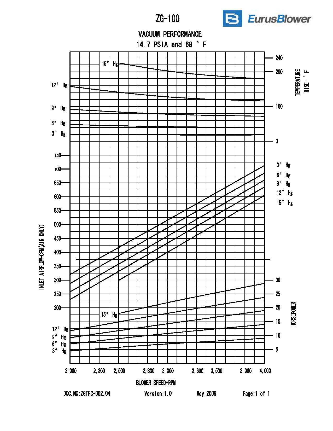

I haven’t read this thread all the ay through so I apologize if its been said, but what is the max CFM on that blower?
Legend specs seem to say it spins at 3580rpm and max lift is set at 13"
blower manufacturer specs
  • ZG-1002-curve.pdf

The Everest HP produced 650 CFM, the sapphire 870 ss claims 770 CFM, this new one seems to be around 600 CFM. Single wanding, you'll never notice the difference. Dual wanding, maybe. If the machine is not performing, there's probably something wrong with. You need to see your service provider.
from what I see online
410? on Everest 650 (3125rpm 13")
410 on 870ss (3600rpm 14")
for comparison
*plumbing/design/etc makes a huge difference so we are just comparing what the blowers are capable of.....not the units themselves

Just checked, it was sunbelt USA. They say the tl650 blower creates a "staggering" 650 CFM.
afaik the "tl650" is actually a GD tl410
I didn't find anything that stated the blower rpm and lift settings on an Everest 650 with a quick search
edit: from the manual it looks like 3125rpm and 13"
