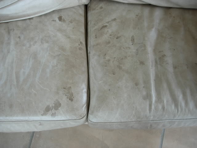

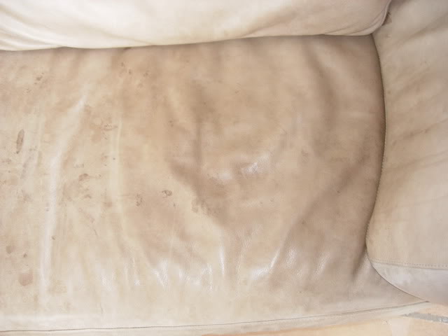

Do you have any system that may be able to restore this piece?
John

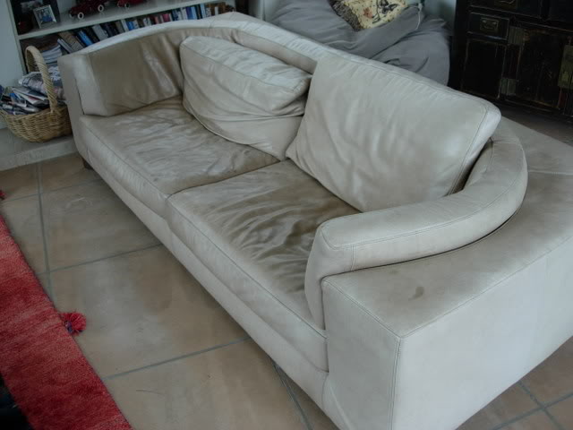

John Middleton said:
Can you suggest anything for this suite Tony?
It is (was) a waxed finish but may as well be a totally unfinished leather. Really nice soft hand. Owner of the best interior decoraters in town. The dogs have been using it and the wife told him she needed a new one but he reckons he can't afford to keep putting a new leather suite into the house every second year.
On the bottom photo, I did a little test cleaning on the rhs of the seat cushion.
John
John

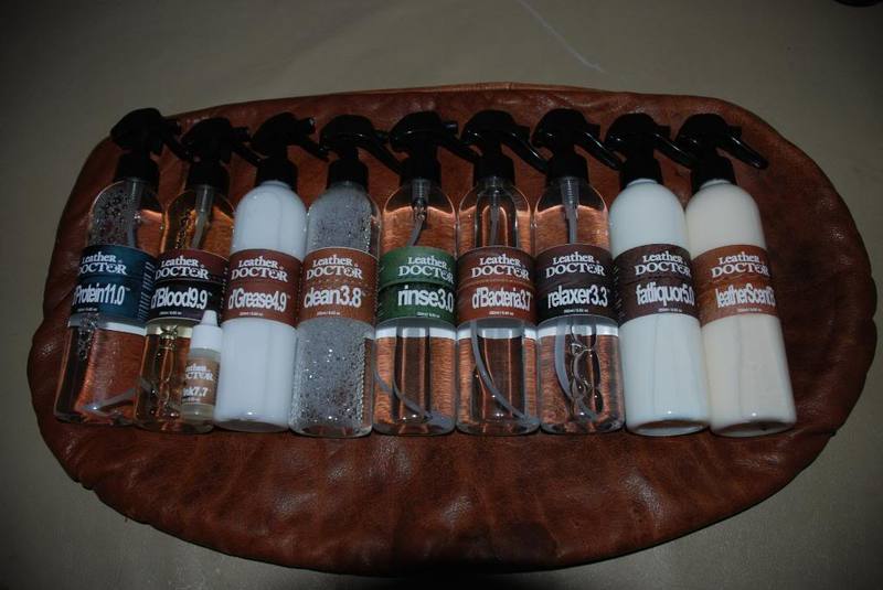

This piece is most likely “semi-aniline” (mono-tone with penetrated stains).
And here are the options for a restoration & sanitizing cleaning.
Like to know why in this sequence?
1. Spotting (after identification)
d’Protein11.0™ pH value 11.0 is a protein based spotting agent for vomit, urine, eggs, milk, creams on all leathers.
d’Blood9.9™ pH value 9.9 is a blood and albumen spotting agent for all leathers.
d’Ink7.7™ pH value 7.7 is a general silicone, oil, grease, dye transfer and ink spotting agent for all leathers.
Beside there are others - see product list you have.
2. Degreasing
d’Grease4.9™ pH value 4.9 is an aqueous leather safe degreaser like oil, dressing, butter or lotion for all leathers.
3. Cleaning
clean3.8™ pH value 3.8 is a leather safe aqueous general purpose cleaner for all leathers.
4. Rinsing
rinse3.0™ pH value 3.0 is a leather safe aqueous mild acidifier all purpose rinse for all leathers.
5. Organic Odor Control
d’Bacteria3.7™ pH value 3.7 is a leather safe, biodegradable, odorless and colorless bactericide to kill organic odors for all leathers.
6. Rehydration
relaxer3.3™ pH value 3.3 is a leather safe rehydrating structure conditioner for all stiff, crease, wrinkle and age dried leathers.
7. Structure Conditioning
fatliquor5.0™ pH value ±5.0 is an anionic (-) charged micro emulsion fatliquor for softening and strengthening all leathers.
8. Surface Conditioning
leatherScent’B™ is a non film-forming, non-stick tactile feel conditioner to enhance a soft natural buttery feel with a classic leather scent.
Roger Koh

Wow . Roger is that a complete kit. Does it come with instructions on how to.
R
Roger Koh
Of course it comes with instruction and with MSDS too!
The complete kit for Part 1 Cleaning & Conditioning alone = 37 individual product.
Part 2 Repair & Auxiliary = 11 individual product.
Part 3 Primary Color, Secondary Color, Fix & Top Coat = 24 individual product type (not counting colors).
Like me to email you the complete product list?
Roger Koh
A couple of questions if you don't mind. Firstly, results wise, how close would that process produce compared to the original look? I'm not doubting, just I like to be able to set realistic expectations prior to taking on a job.
John
In the Leather Doctor® System, we fulfill the IICRC S300 Standard for Professional Leather Cleaning.
“Level of Cleaning” should match the “Degree of Soiling”.
In this case we are talking about “Restoration Cleaning or Salvage Cleaning”.
Stains from different source require different chemistry to deal with them.
And why the need of d’Bacteria3.7™, because firstly leather is protein fiber, with protein stains it attracts natural bacteria form the atmosphere.
Organic odor is a sign of bacteria activities especially when weather is warmer and humidity is higher.
So professional cleaning goes beyond just for “look”, it has to satisfy the “nose” too.
And it is also the reason why the “leather scent” comes into play because it makes lots of “cents” too.
This leather in question is original “Semi-Aniline” and originally there is no “WAX” on semi-aniline characteristically.
The wax is a mismatch and has become a “foreign contaminants” that has no place in “semi-aniline”.
For a 100% strip you need the help of d’Ink7.7™ (without deteriorating the existing finish for a refinishing).
Semi-Aniline because of the desire seating comfort (breathability = absorbability) is the best trade off aesthetically with a micro pigment finish for cleanability is still more fragile than a pigmented leather.
As semi-aniline dry and wet rub resistance is not as good (more of a need to reduce friction with leatherScent’B™ than just “protection” that does not reduce friction - as leather furniture is design basically to be sit on rather than walking in the rain) as pigmented leather, therefore I believe successful spotting may also affect the delicate micro-pigment finish.
Do not overlook that what you see is just spots, stains and soil, but worn areas, scuff or scratch cannot be solved by cleaning alone.
So, pre-warn the possible need for an aesthetic light refinish too!
Cleaning only delivers the “hygienic” aspect with aesthetic to a limit (finish conditions camouflage by soiling - remove the soil may also reveal the finish damage - so please pre-qualify).
So the question is how to deliver the finish to its original characteristic, so that customers can enjoy its original comfort of breathability (especially on warm humid weather, lounging on a semi-aniline leather is more comfortable than on a pigment leather).
Use semiColor74™ (this is specially design for semi-aniline leathers) with matching semiTop57G for gloss and 57M for matte.
Secondly, thanks for the price list, although you don't seem to have any of your 'kits' listed. Can you forward me a copy of those too please. John
Kit is only for “Kidding” you!
Select any combination from the 37 cleaning and conditioning products becomes a “kit” of your choice and there will be countless numbers of kits!
Hey Roger, just bringing this one back up in case you got busy and let it slide.
Care to comment on why the degreaser after the spotters?
When working on carpets and fabric upholstery, I generally find the oil/grease film removed first allows superior results on the spotting agents.
Obviously different on leather and I wouldn't mind knowing why if you don't mind.
John
Leather Permanent-Marker (sharpie), Ballpoint-ink, Dye-transfer, Oil and Grease Spotters generally has a higher concentration of working ingredient than the degreaser.
Example d’Ink7.7™ is 21 times more in concentration than d’Grease4.9™.
And d’Oil4.4™ is half the strength of d’Ink7.7™ in effectiveness but leather safe with no darkening effect on absorbent leathers, suede or nubuck.
d’Marker10.5™ is a self pH neutralizing product as it dries.
These spotters make the degreaser redundant as for spotting.
However, it is very necessary to follow up with a general degreasing with d’Grease4.9™ so as to feather out the obvious contrast in appearance when spotting on heavily soiled leathers.
All these above spotters and degreaser have some kind of sticky residue that cannot be detect by hand, however they all have to removed by clean3.8™ (an all purpose leather safe cleaner follows by rinse3.0™).
- That’s the sequence of the “leather safe” cleaning system!

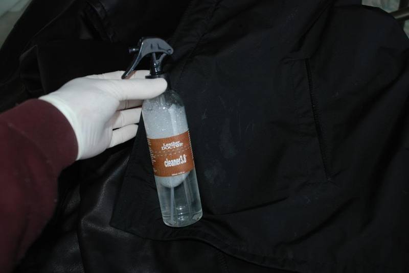

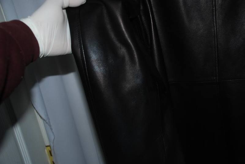

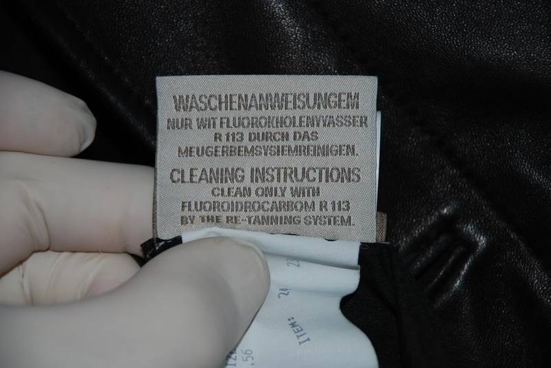

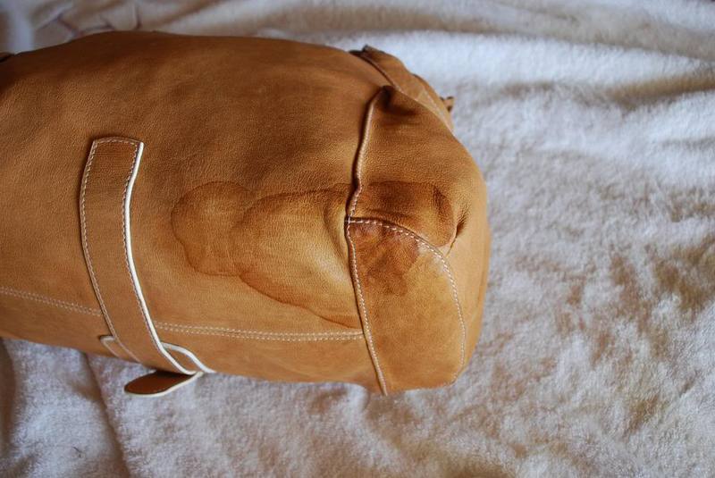

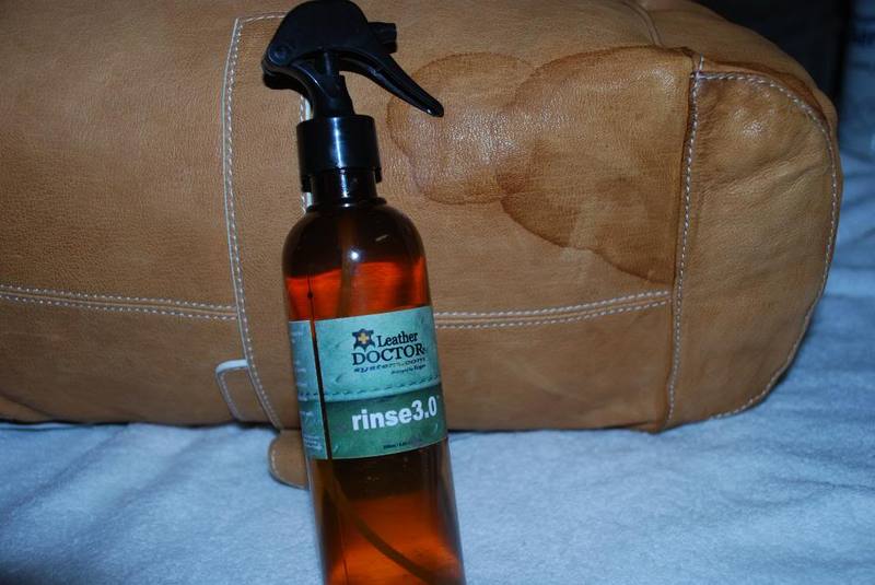

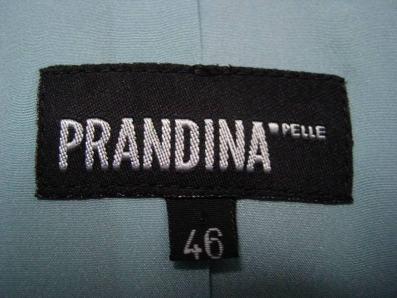

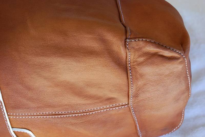

This is #3 Pure Aniline
Picture #1 Leather Type: Pure Aniline
Picture #2 The Brand
Picture #3 Cleaning Cautions
Picture #4 The Explanation
Picture #5 Sensitivity of Pure Aniline
Picture #6 Result of Wet Cleaning with “Leather Safe” system!
Roger Koh

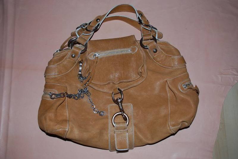

Roger Koh
Pure Aniline

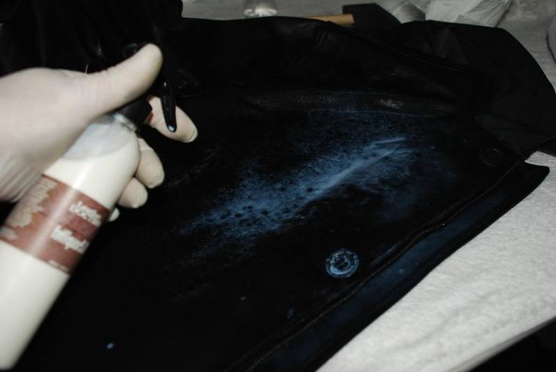

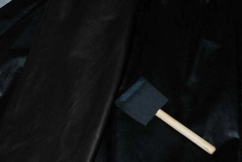

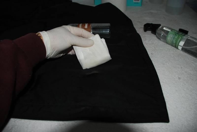

Another #3 Pure Aniline
Picture #1 - Hugo BOSS® Pure Aniline
Picture #2 - Chinese Restaurant Unknown Beverage Stain
Picture #3 - Acidifying Rinse
Picture #4 - Fatliquoring
Picture #5 - Stain Gone
Roger Koh

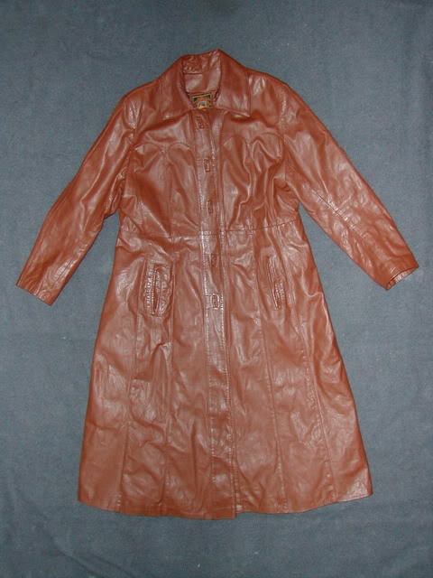

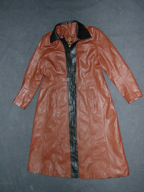

I can see I'm going to have to re think my stand on garments and accessories!!
The only garment I've done is this job. Old leather coat that had passed through several generations and so had sentimental value but she hated the 'baby poo' colour as she said.
John

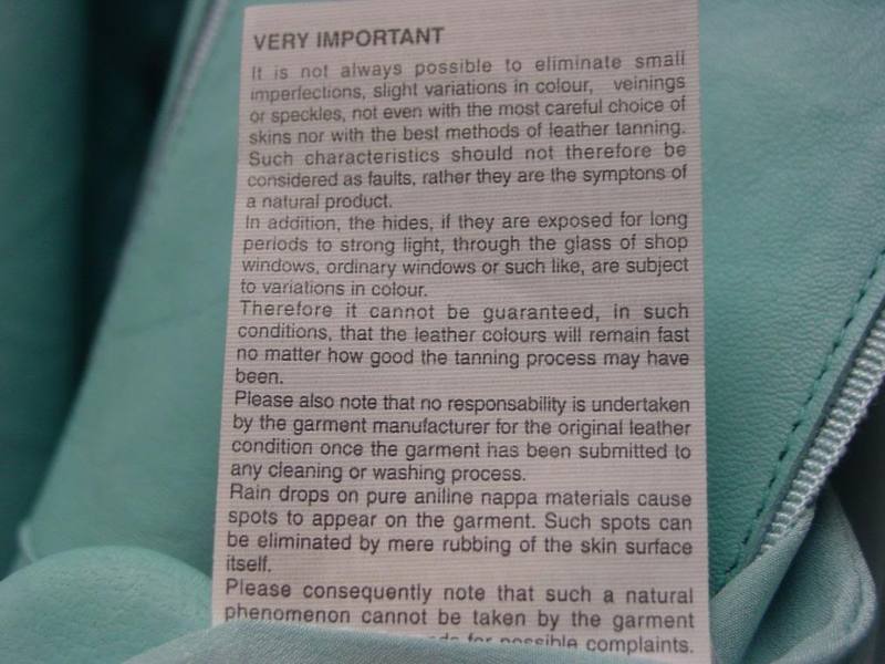

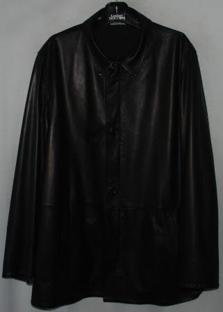

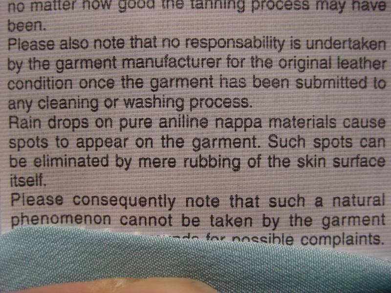

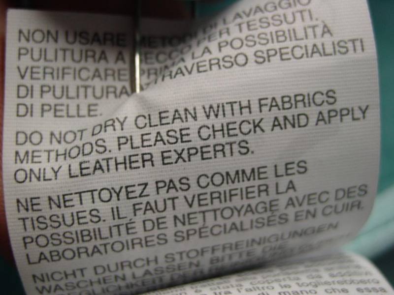

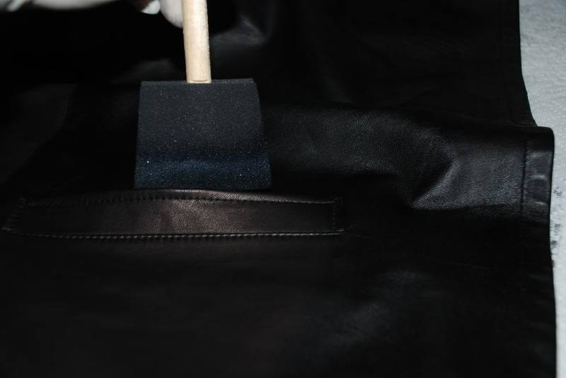

R
Roger Koh

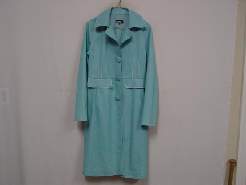

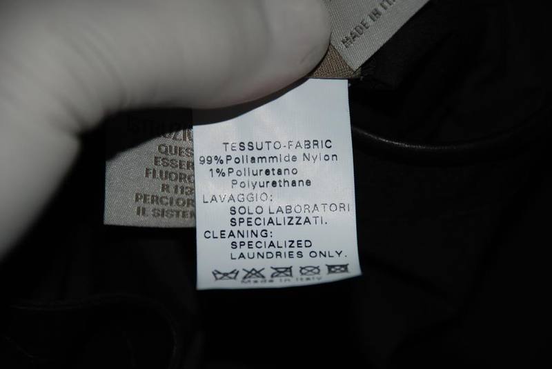

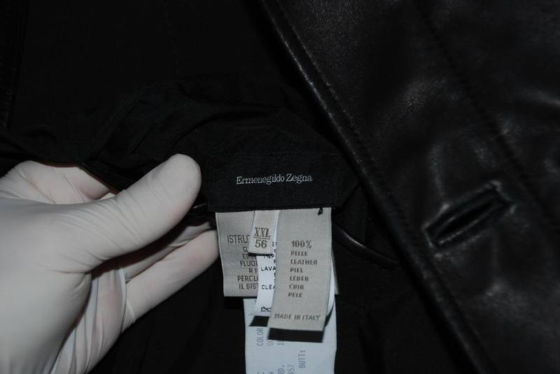

Waxed Aniline
This is #5 Waxed Aniline (Please do not mix up with Aniline Wax Pull-up)
This is the $3500.00 waxed aniline jacket (see above testimony referred by http://www.harryrosen.com).
Picture #1 The brand - Ermenegildo Zegna®
Picture #2 The Instruction - an advanced cleaning instruction equally match by the "leather safe" Leather Doctor® System
Picture #3 Further Information
Picture #4 Catsups Stains
Picture #5 Cleaning with clean3.8™

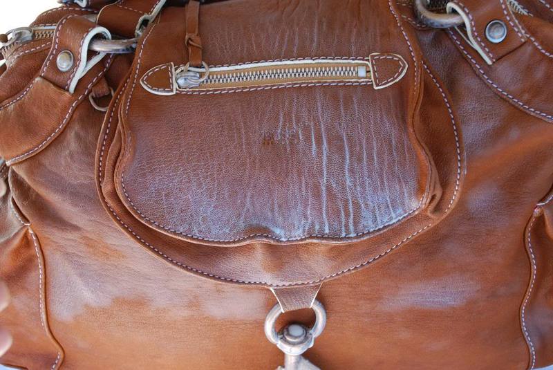

Picture #6 Acidifying Rinse with rinse3.0™
Picture #7 Fatliquoring with fatliquor5.0™
Picture #8 “Dye-On” dye with anilineDye21™
Picture #9 Simply apply with a 3 inch Poly-Brush® - see the bronze effect from the aniline dye.
Picture #10 Top coated with a very soft “waxy matte” anilineTop53WM™ to protect the dye for better wet rub resistance and also to deepen the black thus diminishing the “bronze effect” (See the contrasting panel before top coating and after).
Picture #11 Finished - See how the leather drapes gracefully like a curtain - thanks to fatliquor5.0™.
