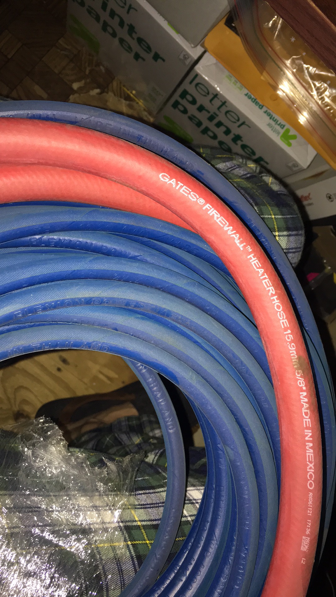

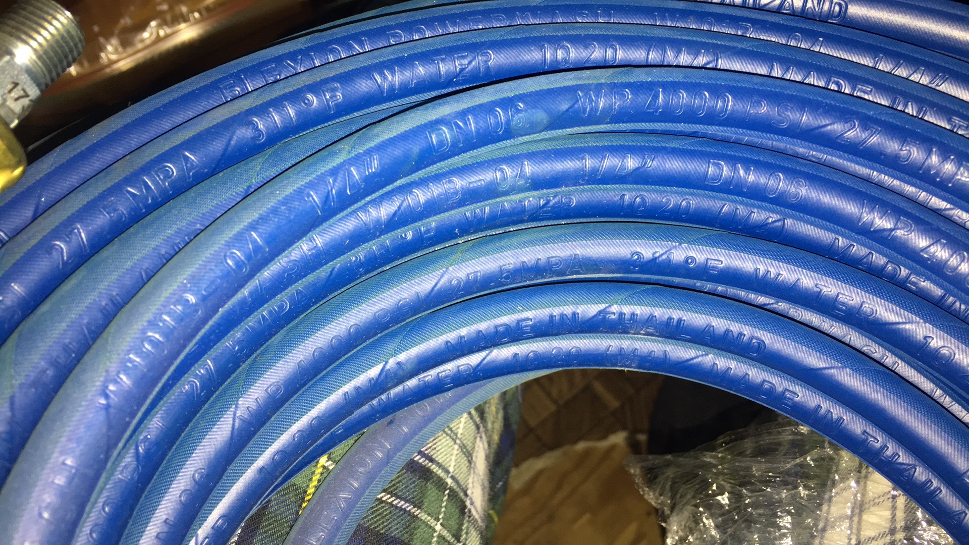

I’m loving these hoses so far. Not stiff, insulates the heat well, and is a rough feeling surface that isn’t bleeding blue when wet. I’ll keep you up to date on it as time flies
The outer skin on mine marked up quickly, but is a decent hose to work with. I have been using for about a year now. I bought a second 125' length at the first if the year, so I would recommend.
14,643
Is this the hose you got? Flexion?
BE931262-23EA-445D-91DD-1115F08DB18B.jpeg 56699544-E9FC-4325-8E73-4BC4D51887B3.jpeg

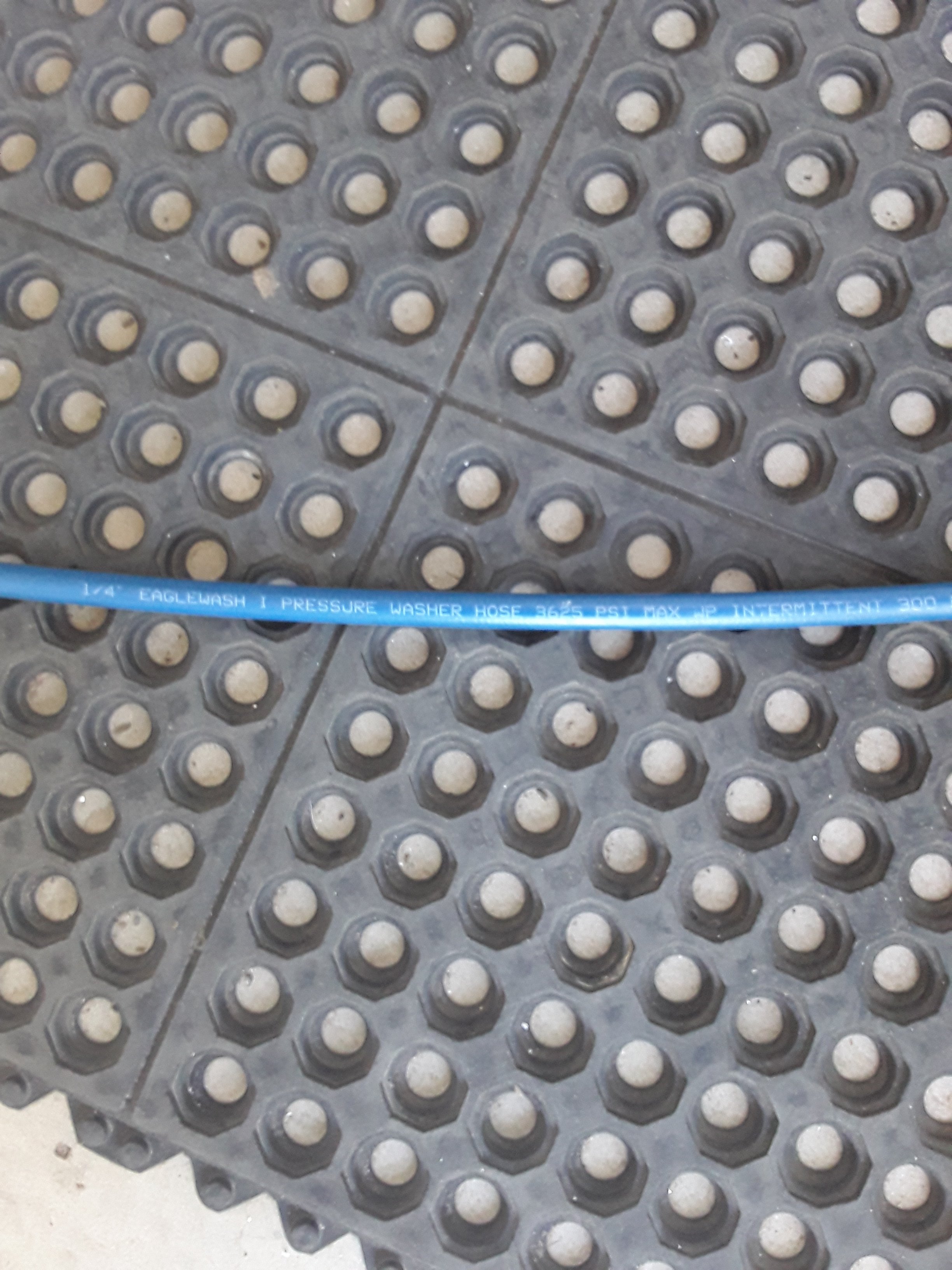

Matt, you know how to over-complicate an issue better than anyone.
I’m tired of our industry putting out shitty hoses.
Raptor,
Continental
Hydroforce
Parker
Eaglewash
They all blow out black water in 6 months or less I’m hoping these Flexion hoses will hold up

The red heater hose serves the function of bend restriction, heat protection, and blowout deflection.
I remember seeing @GeneMiller use the clear vinyl hose as a deflection hose.. You could see if it was leaking..
