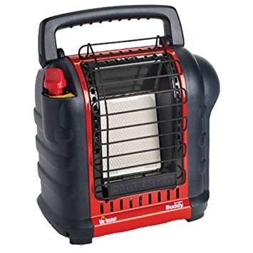

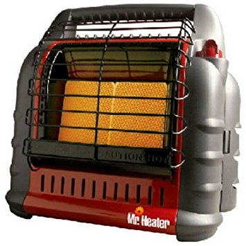

8) Portable heater that operates off small bottled propane containers….you never know. It might save you and your equipment. Cube vans, you have a big challenge so you might need more than one, two, three….units. Keep in mind that these units will require oxygen to operate, so you will need to have a bit of venting.

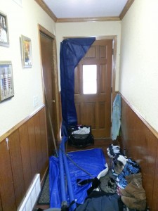

1) Get a door drape to keep the cold out and the heat in. People love that you are going the extra mile to protect their home.
A door drape in action

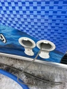

10) Add access port holes to your van so doors can remain closed and hoses can get to the job. If you are running lager hose such as 2.5 inch, you will need to access holes. There are other options for hose ports, but here is a link to the Butler units which I am most familiar with and really pleased with. http://www.butlersystem.com/pop_second-hose-guide-and-security-door.html
Hose Ports

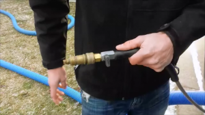

11) HEAT UP THAT HIGH PRESSURE LINE and run to the door. Get hooked up for prespraying or to begin cleaning. If you are cleaning alone and feel that your high pressure hose could freeze up while agitating or moving furniture, put a male or female end (depending on your particular set up) on the high pressure hose, get some water flowing while it is stuffed into the vac hose. In most cases, you will not need this unless you are cleaning in -50 degrees below zero (and yes I have cleaned in this!)
Sprayer end for high pressure hose​

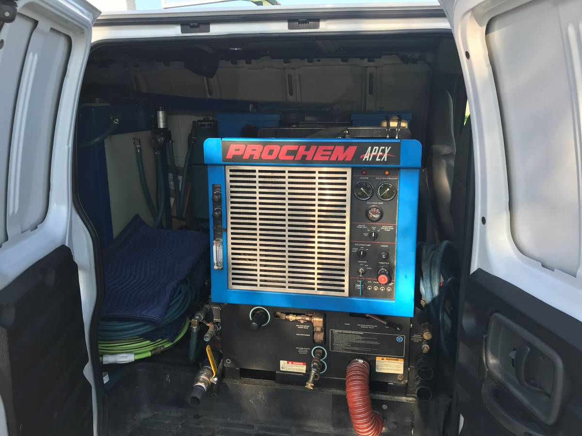

Paul
this was the door drape I used on my Apex. Still have to make one for my new Titan 575. Covers everything except radiator. cuts are made for easy access to panels. Van stays toasty warm. Never needed an ice scraper. Never insulated a van either. Only dont go out if its 10 below zero or under or if schools are closed.00q0q_6vAgTj3RPxf_1200x900.jpgIMG_0778.jpgIMG_0780.jpg
