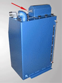

gasaxe said:
Shawn Forsythe said:
Lester,
The red arrow points to the vac relief valve on this White Magic waste tank. It is opposite the hose connection, as shown on your photo.
Matt Murdock's numbers refer to vac readings as successive amounts of restriction are added to the machine. The lesser restrictive the addition, the less the rise in vac level. Hence, the reason some users will opt to use larger than stock vacuum hose (i.e. 2.5" vac hose).
with the unit running at slower speed 1500 rpms or so... cap off the vaccum outlet (where you hook up your hose) listen for air leaks at connections,tank lid seal, and vac relief. If there is substantial amount of air leaking at the vac relief try pulling the vac relief closed by hand. again listening for other air leaks the less air leaks the more the motor will load down... DO NOT OPERATE THIS WAY FOR EXTENDED PERIOD !!!! 5 mins or so max.. once you have ALL of the vac leaks corrected put 100 ft of hose on and your wand. place it on the carpet and assure that you have no air leaks between the carpet and the unit. Now set the vac relief where you pulling 14" of hg with the unit running at max rpm..
