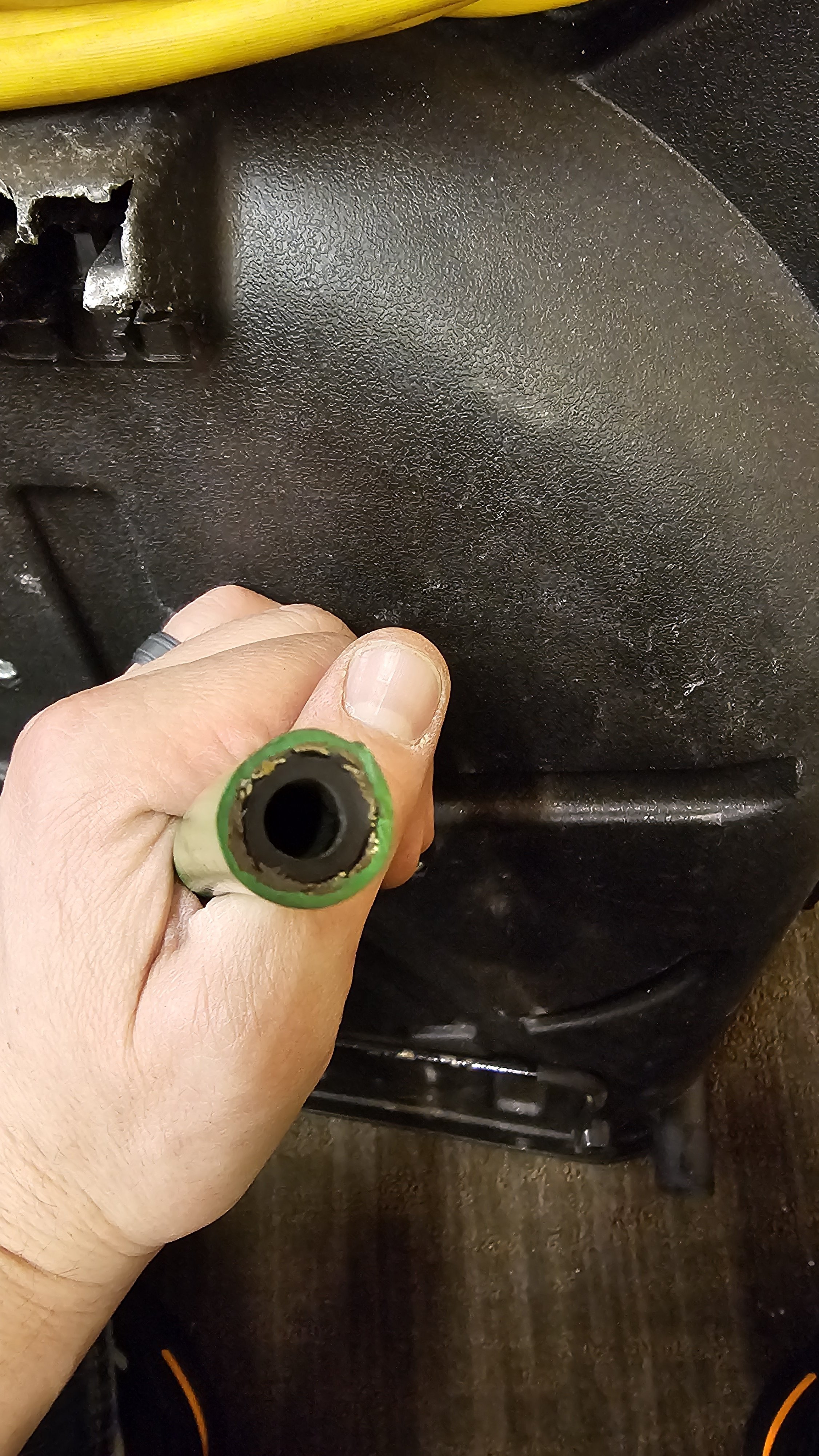

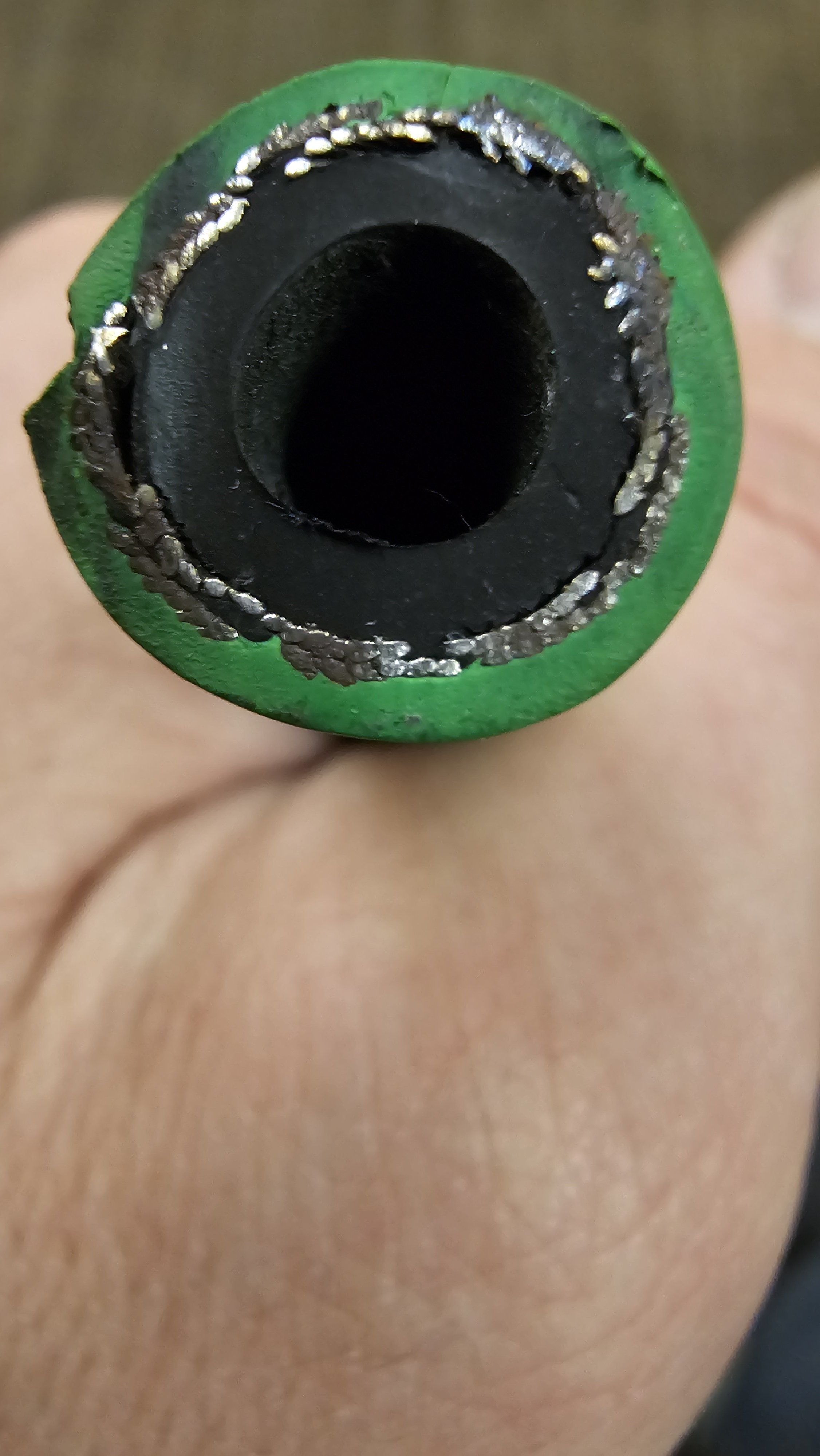

I'm assuming that all steel braided have an inner liner??? Or else you'd get RUST when you 1st pull the trigger.....am I wrong? I threw all my grey hose away for that very reason when they got old...

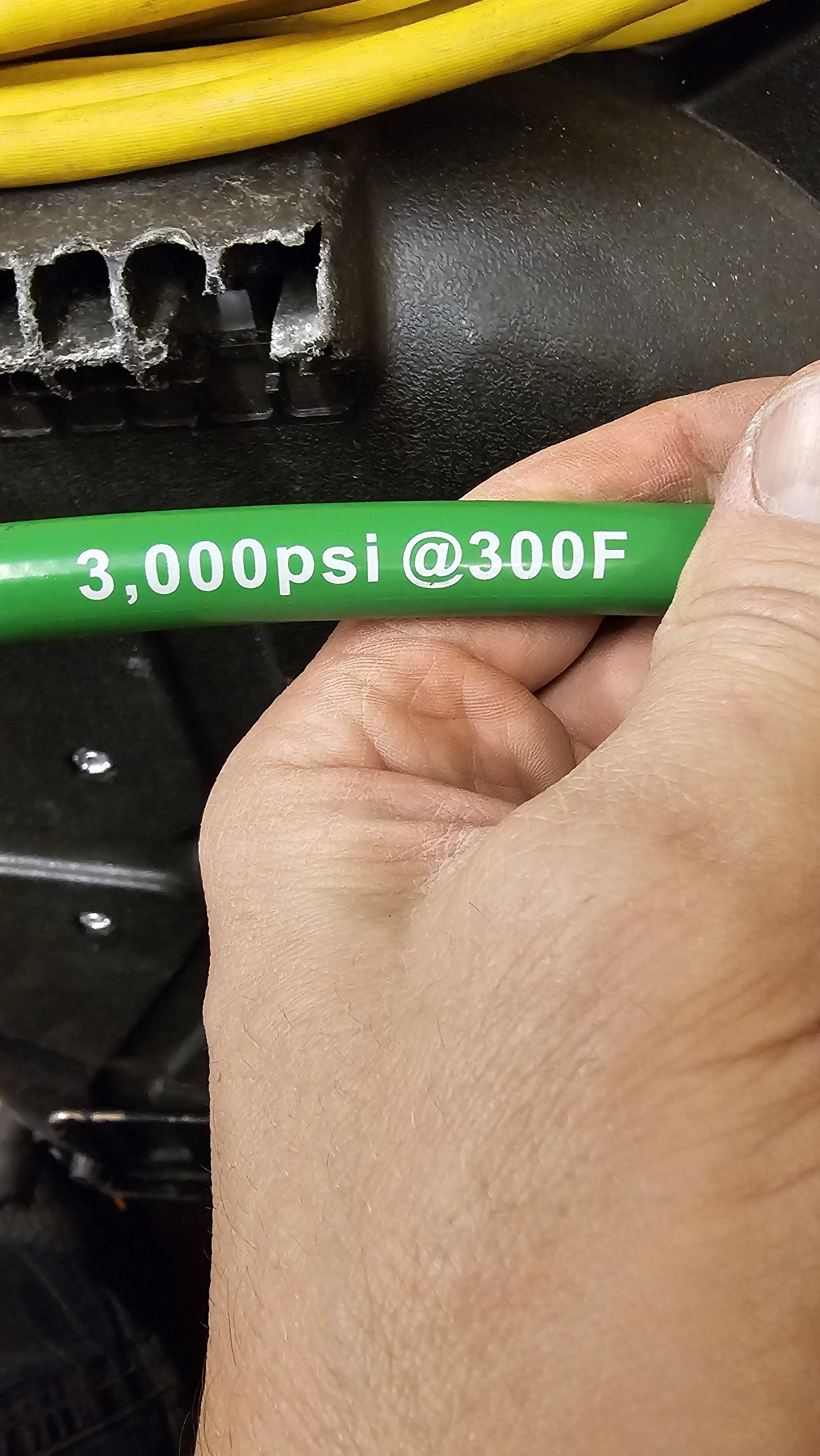

Joe B. Sent me a sample of this. I haven't bought any yet, but I'm considering it.
14,645
That's a pretty high temperature rating. Most are only 250 degrees.
It's probably a lie...
Eaglewash offers the same 300F rating. The number stamped on the hose doesn't mean 300F constant heat. The hose temp ratings stamped are only for heat that is spiked for a short period of time
That's probably a hose rated at 212F constant heat
