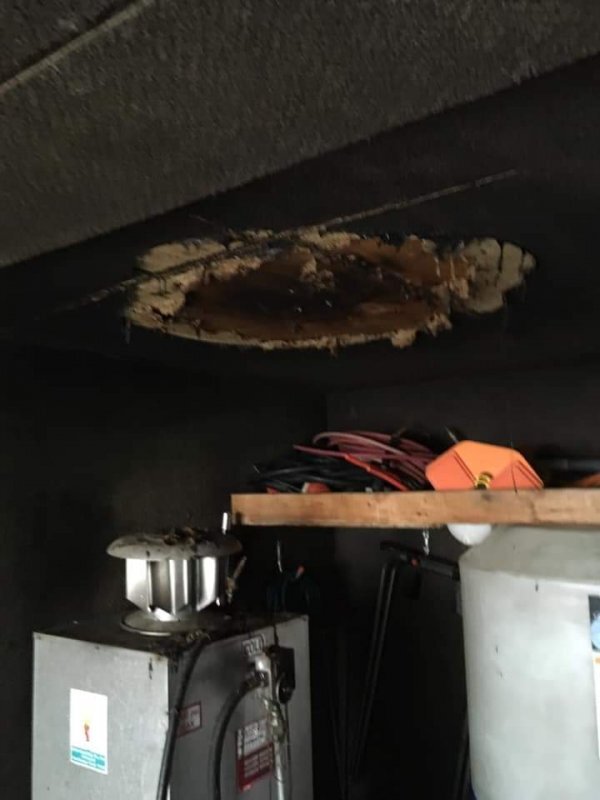

Waldo's POS LG nearly killed him yesterday.
Sure it Waldo but he's smarter than the average carpet cleaning idiot
How did it almost kill him?
I see a burn mark on the van roof that looks like what occurs after years of exhaust cooking. Usually, cleaning the coils keeps flames from coming out of the exhaust, but if this is what happened, how did the heat go around the wooden shelf piled with plastic stuff?

27,967
The propane pipe that goes to the thermostat fell off ...poof!
That's exactly what almost happened to me. The swivel union came loose because of the broken mount. I just had a little flame coming out but would have been much worse if I hadn't caught it in time. That's what comes from being too fooken lazy to fix it and thinking, "just one more job". Taught me a very important lesson. One that I already knew but grew over confident on.
