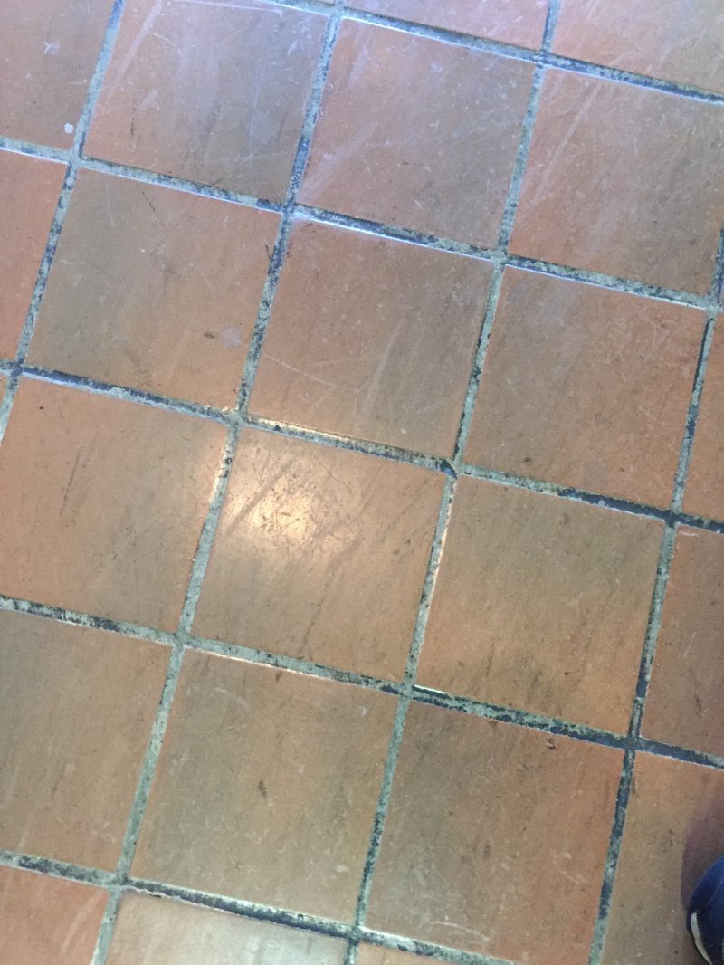

How can I strip all the sealer off the tile floor?
I did try some Home Depot stripper right out of the bottle, but no luck.
dealtimeman
Everyday is Saturday.
Sep 20, 2008
Michael
Not going to be easy but it can be done.
While some might think mikey response was harsh or just to be funny, it was not.
It will most likely be cheaper to chip that floor out and install new tile than it would be to completely remove all of that coating especially if you hit it with a strong alkaline and it did nothing.
Give me a call and I can walk you how to do it but it is not for the faint of heart. The only reason to try to remove instead of replacing would be if the is a bunch of equipment like kitchen equipment( stoves, fridges, fryers) etc that would increase cost of replacement and time of project to a point at which the cost to remove the coating becomes a viable/ and or efficient solution.
