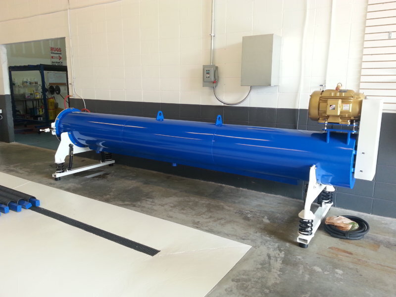

Joe could dig a little deeper and buy our 18" diameter 14 foot long centrifuge to eliminate some of his woes. (The machine he has is a fine machine but small for many of the rugs in the American market)
Joe could "Did a little deeper" and buy your 18", 14' centrifuge but he's still waiting on the tumbler he paid you in full for 2 months ago.
Mike, this is only the 3rd time in 7 yrs we've had this issue.

Speaking of Bears.. our rug stuck story... 12x18 chinese 90 line... after three hours of picking our brains, we used a c clamp, a toe strap and a fork lift.. no damage to rug or centrifuge... but might have used up some of Bears luck...

So it sounds like this is pretty common. Not knowing how how they operate could you slip the rugs in a sleeve as they go in? One that is slick and would have some give yet allows water to pass through? Like a laundry bag?

Its only common when you try to get the biggest fookin rug in your centrifuge you can... I have a 16" by 12 foot centrifuge.. this rug when rolled up wet was 14 inches in diameter.. lessen learned.. we now know what too big is.

I've heard of some guys spraying silicone within the walls of the tube. For us the most difficult rug to remove was probably jammed in and wrinkled at the back of the tube wedging itself in. My centrifuge is a different design than Centrum Force and not accessible from both ends. Others may be to0 wide for the tube and forced in. I'd consider those operator error. If it doesn't fit, don't force it. Rugs that stick to the wall are not a problem as long as you can manipulate the center of the rug roll. I wouldn't consider this recent situation a common problem for us. We've maybe had 3 days of downtime in the last 7 or 8 yrs of rug wringing. I can live with that.

How about a rope going over the far end of the rug when pushed in with both tag ends at the door.
