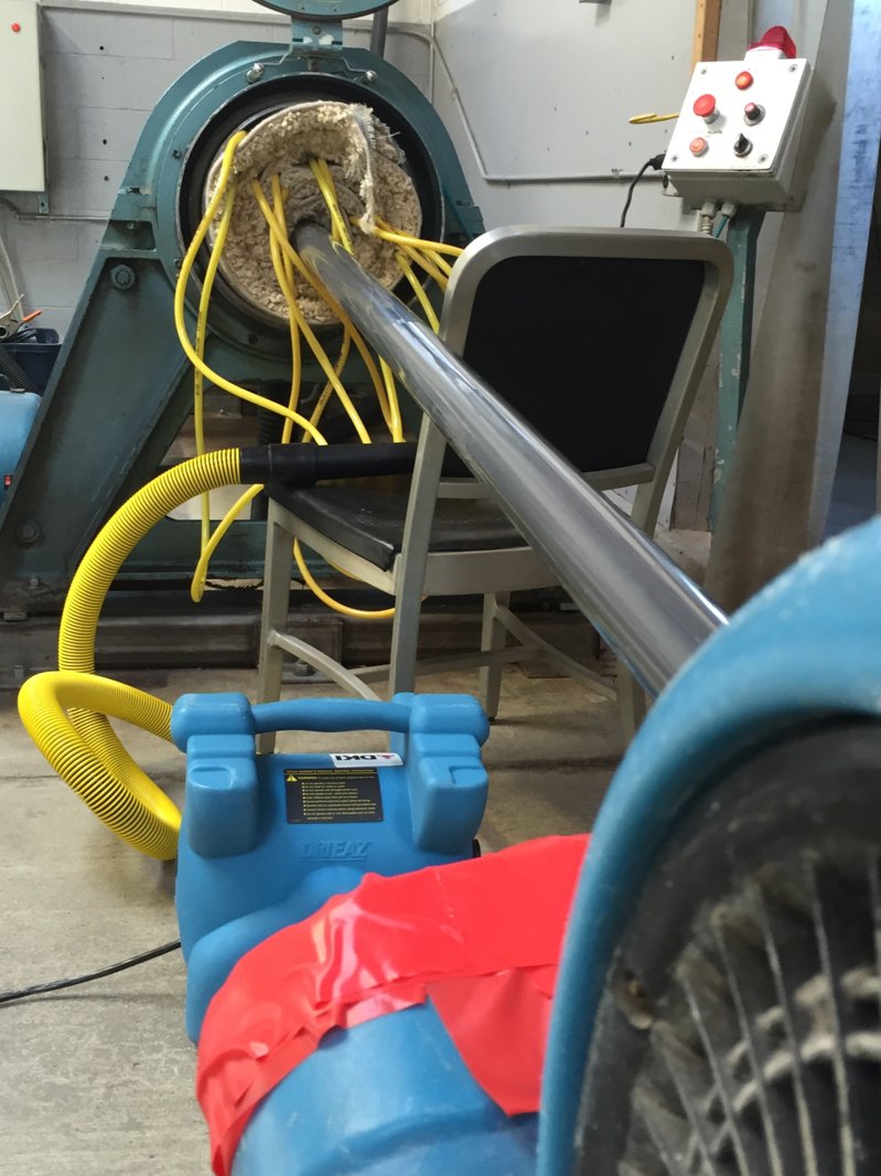

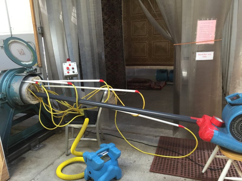

The implosion process
Joe Appleby
Feb 8, 2007
606
Danville, CA
Joe Appleby
If we didn't have a pile of rugs to clean we'd be fine. Looks like life support. We're going to let it
go over night and give it a try in the morning.
